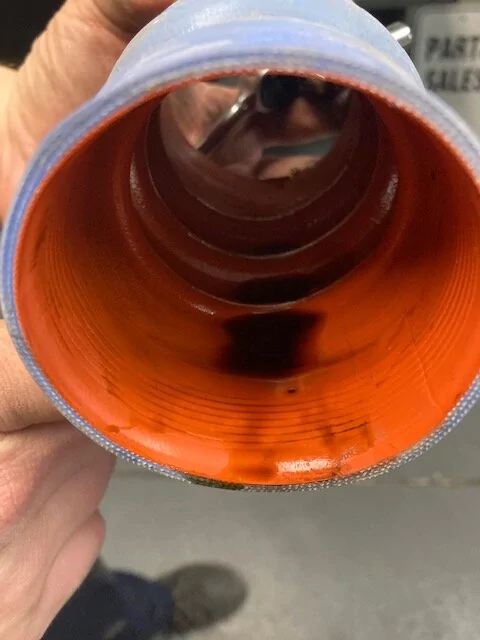

This is what our catch can stops from happening. As I've explained, our primary purpose here is performance. A thin coating of oil in your intercooler, especially the undersized crap the Maverick comes with, will completely ruin the efficiency of the intercooler.
This coupling is off a highly maintained 2020 F150 3.5EB, that's just the oil in the coupling we pulled off this morning. The truck is getting a custom catch can and larger front mount here at the shop today.

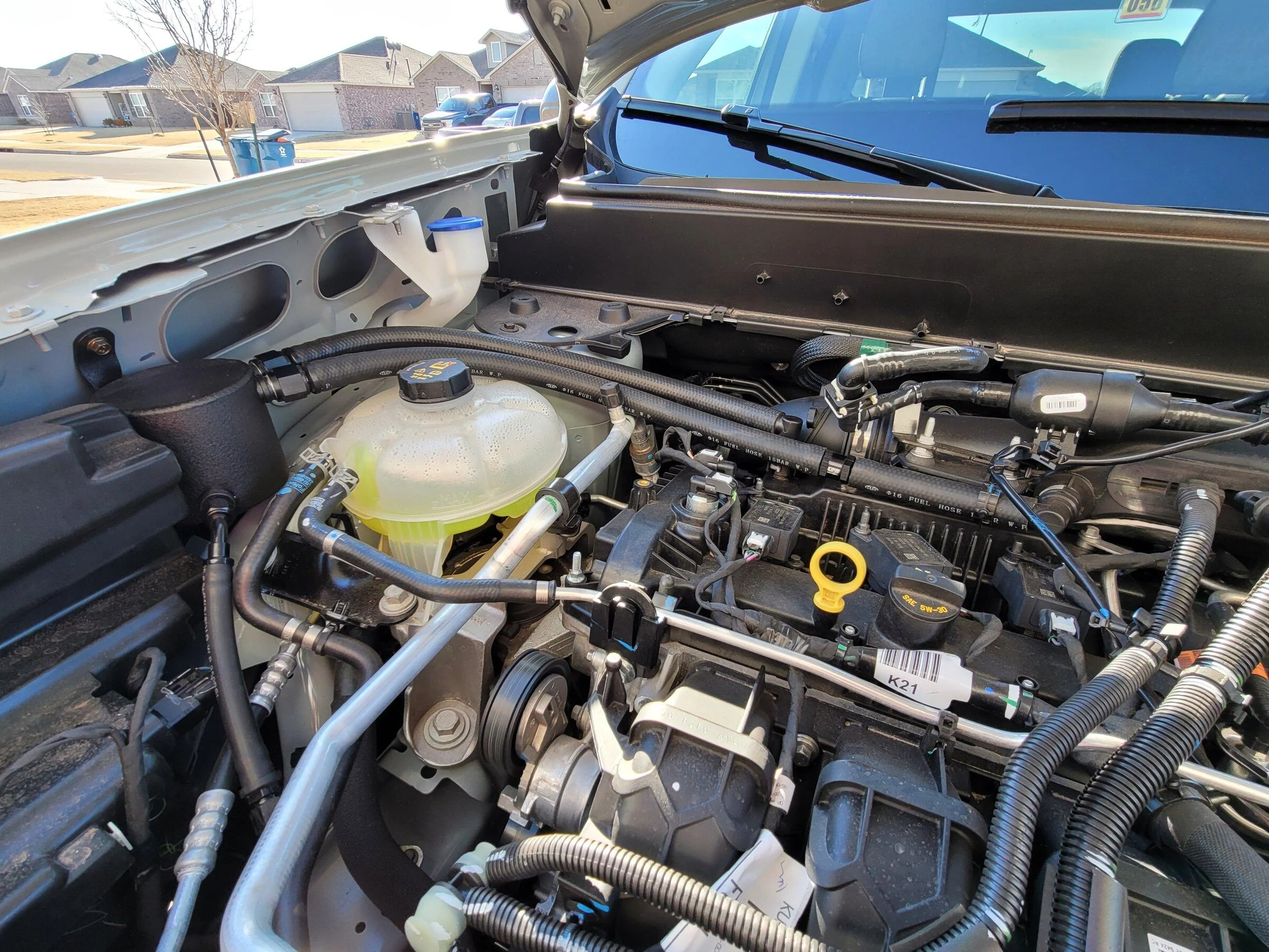

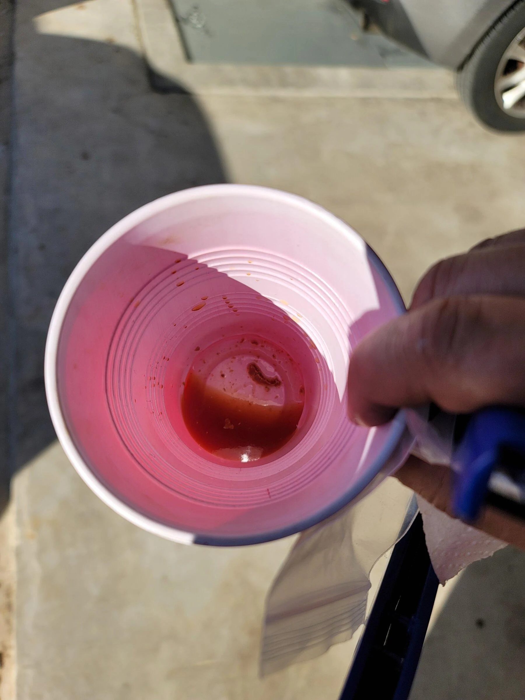

I run two cans, both catch plenty of oil, water, and fuel.
If anyone needs to replace the Ford anti-tamper fittings (orange tabs) you can get them @ UPR, Pcv fittings
@Buschur design works fine, and is very well built, as he has stated he is not particularly interested in capturing the crankcase vent at the pcv because that enters the airstream downstream of the turbo and intercooler and his goal is simply to keep the intercooler clean and efficient as possible. I run two because I don't want any of that crap in my intake at all and cans are the cheapest way to minimize that issue.
If you keep an eye on your stuff you are not going to suffer from frozen vent lines or cans.

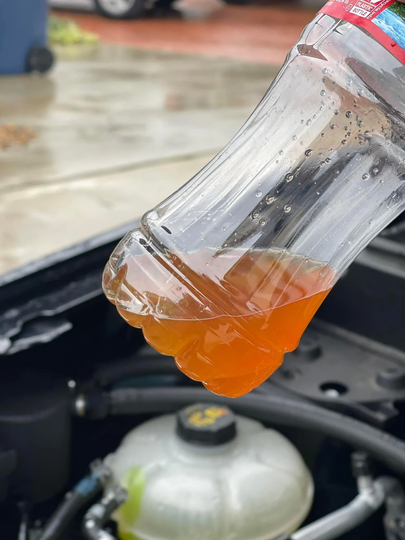

I have read this entire thread and feel that clarification is needed for people who are considering purchasing an air/oil separator (aka catch can) but still don't fully understand what they do or if/why they are needed.
First, you have to understand how the PCV system works. PCV stands for Positive Crankcase Ventilation. The system is designed to evacuate the oil vapor, water vapor, fuel vapor, and pressure that build up in the crankcase and send it back through the combustion chambers and catalytic converter(s) so that it can be burned and cleaned before going out to the atmosphere. The pressure in the crankcase is primarily caused by blow-by. Blow-by is caused by high pressure on top of the pistons, during combustion, which pushes combustion gases (including droplets of oil and fuel) past the piston rings down into the crankcase. Blow-by is made worse by power adders (boost) because the combustion chamber pressures are much higher than in a naturally aspirated engine. Without the PCV system this blow-by would have to be vented in some other way or the pressure and contaminants would cause engine failure (damaged pistons, rings, bearings, blown out seals, etc.). There are many ways to vent the crankcase, but the PCV system is currently the most cost-effective, emissions compliant, way to do it. I also want to add that oil quality is very important to limit blow-by and oil vaporization. Please take note that Ford changed the specification on the 5w-30 oil used in the 2.0L EcoBoost (as well as many other Ford engines) sometime in 2020 or 2021. The old spec was WSS-M2C946-B1, and the new spec is WSS-M2C961-A1. I have not been able to find the difference between these two specs but would guess it has to do with vaporization and/or attempting to prevent turbo coking (damaging deposits on turbo components). If you change your own oil, make sure you purchase the new spec (it will be listed on the back of the container). I went to the local big chain auto parts store and the 5-quart Motorcraft 5w-30 synthetic blend was still the old spec. Luckily, the individual quarts were the updated spec, so I paid more for the individual quarts to get the correct oil. If you have someone else (including the dealer) change your oil, make them prove to you they are using the correct spec oil.
For the purposes of my explanation, I'll divide the PCV system into two 'sides'. The first side is the PCV valve side. The PCV valve is a one-way valve that draws pressure and vapors from the crankcase directly into an engine vacuum source (typically the intake manifold between the throttle body and cylinder head). The second side is the air intake side (any portion of the intake system that is before the throttle body).
The PCV valve on the 2.0L EcoBoost is built into a vapor separator mounted to the front of the engine (actually side, but our engines are transverse mounted because of the front wheel drive platform). This vapor separator simply flows what is collected back into the oil pan. It is better than nothing, but nowhere near as good as an external air/oil separator at collecting the harmful vapors. This side of the PCV system is what causes carbon buildup on the intake valves in an engine with direct injection. The pressure and vapors are pulled, via vacuum, directly into the intake manifold and no fuel is sprayed into the intake passages. This is only an issue with direct injection because carburetion, throttle body injection, and multi-port injection all mix the fuel with the air before it is drawn into the combustion chamber. This air/fuel mixture cleans the intake valves as it passes over them while entering the combustion chamber. To keep the intake valves clean, on a direct injected engine, an air/oil separator on the PCV side is the simplest solution. There are cleaning processes that can be performed by dealers and/or other mechanics, as well as some over the counter cleaners, but I can't speak to the cost or effectiveness.
As @Buschur has explained, the separator he sells is for the air intake side of the PCV system. This side of the system is more about pressure equalization under normal driving conditions, but under boost (positive manifold pressure instead of vacuum) the amount of pressure and vapor relief on this side increases because the PCV valve is closed (boost pressure will be forcing it closed). That makes this side the only means of pressure and vapor relief under boost. Because of this, a separator on this side is still very important on a turbo application. This is especially true with aftermarket tuning that raises boost (which will increase blow-by), when the vehicle is used to tow, when driven aggressively (racing or aggressive street driving), or simply to keep performance optimal. As @Buschur has also explained; any blow-by that does get drawn in by the air intake runs through the turbo, the intercooler, and the throttle body which will leave harmful deposits on/in all 3 without a separator on this side. Just be aware that a separator on this side will typically catch much less, if anything, on a gently driven vehicle. This is for the following reasons: 1. When engine vacuum exists, pretty much all of the pressure and vapor is evacuated through the PCV valve side. 2. The air drawn into the air intake takes the path of least resistance, which (under light or no throttle) is the air filter assembly and large tube, not the small tube from the valve cover to the air intake tube. 3. There is typically a baffle (or baffles) in the valve cover which limit the amount of air and vapors that can pass into the air intake. This is why some of you are getting nothing, or very little, when you drain the can. Also, the attached image isn't an accurate representation of what to expect for most people. It looks to be about 99% water which is most likely due to the environment that particular vehicle is in (cold or very humid), or if the vehicle is driven short distances and not allowed to reach full heat soak. FYI- A separator on this side typically won't catch anything on a healthy naturally aspirated engine (such as the 2.5L in the hybrid). Also, the 2.5L hybrid engine is not direct injected, so it doesn't need a separator on the PCV valve side either.
In conclusion: if you want any turbo direct injected engine to last a long time and/or a lot of miles I recommend you install an air/oil separator on both 'sides' of the PCV system.

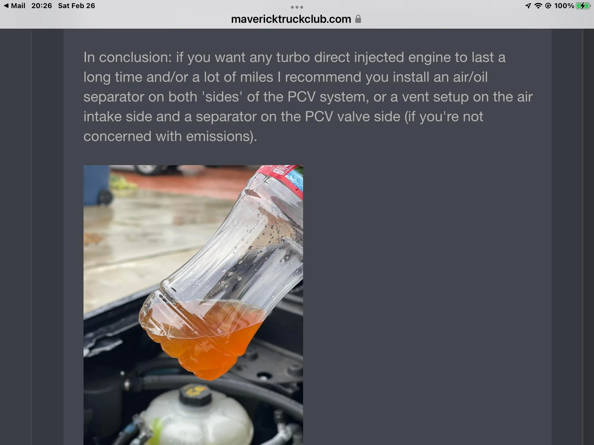

Not a question of taking (nor giving) offense. And I quoted you directly. Took a screenshot.
I don’t want to start a political thing here. The “reasonably healthy” Earth will outlive me. I only hope to extend that health for a few more generations. Giving up a scoshe of performance to advance that goal is a very small price to pay.

1/ Caps for emphasis. Too important to let slide.
2/ Direct quote. See screen shot.
3/ The fact that you removed the pertinent part shows that you
knew what I was talking about.
‘Nuff said. My “emissions” point was made.
