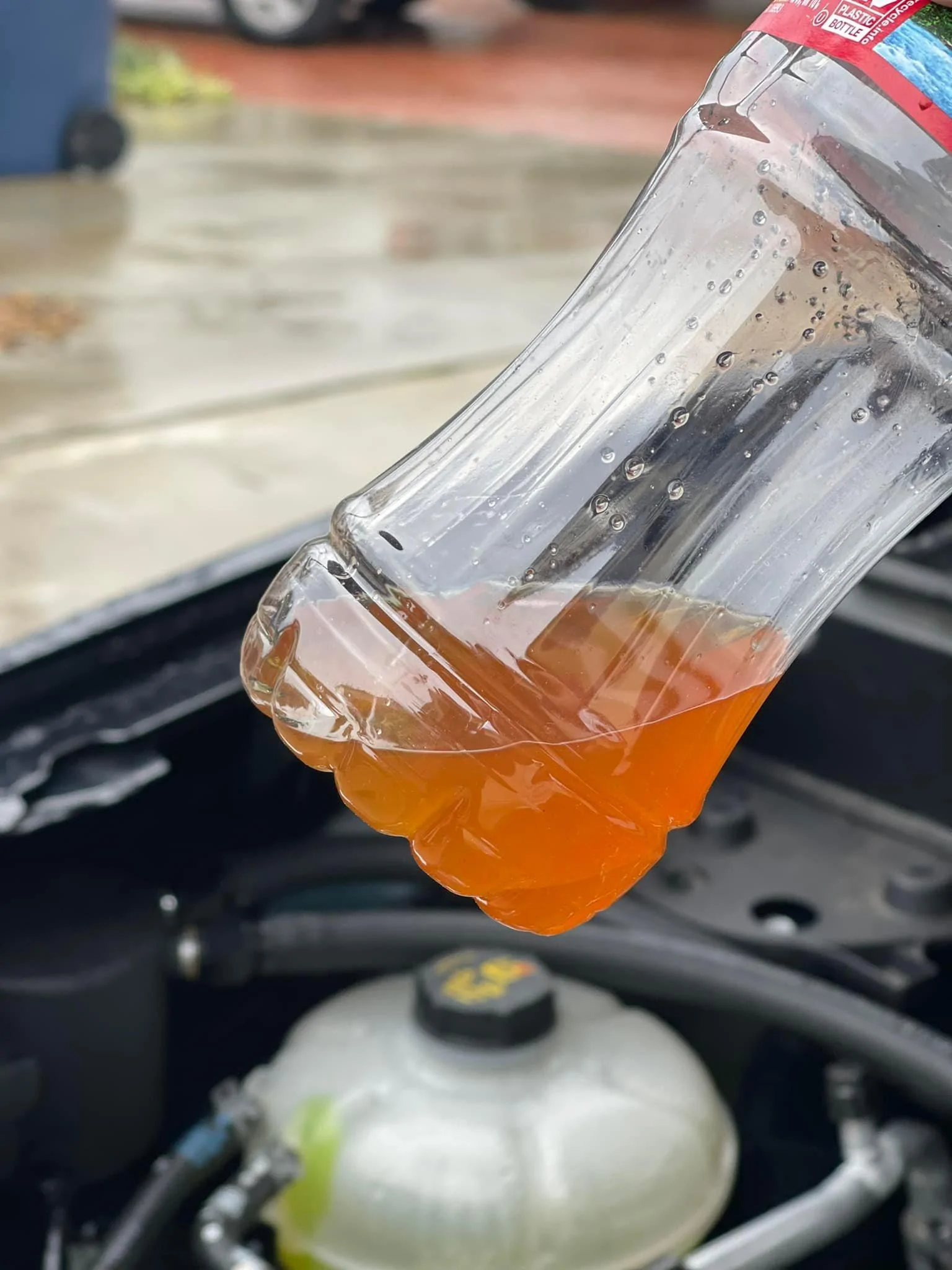

I installed an oil catch can and after 1000 miles, it was empty?
Not having anything in it is a good thing but unusual, this is a pic of what came out of someone else's after a few thousand miles.
