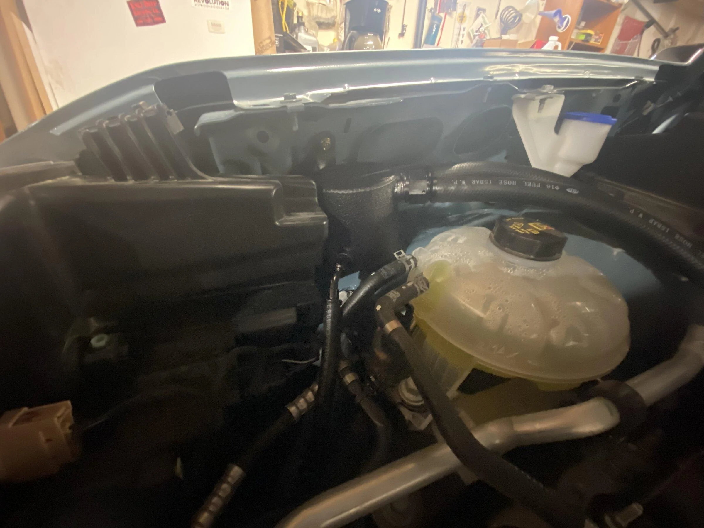

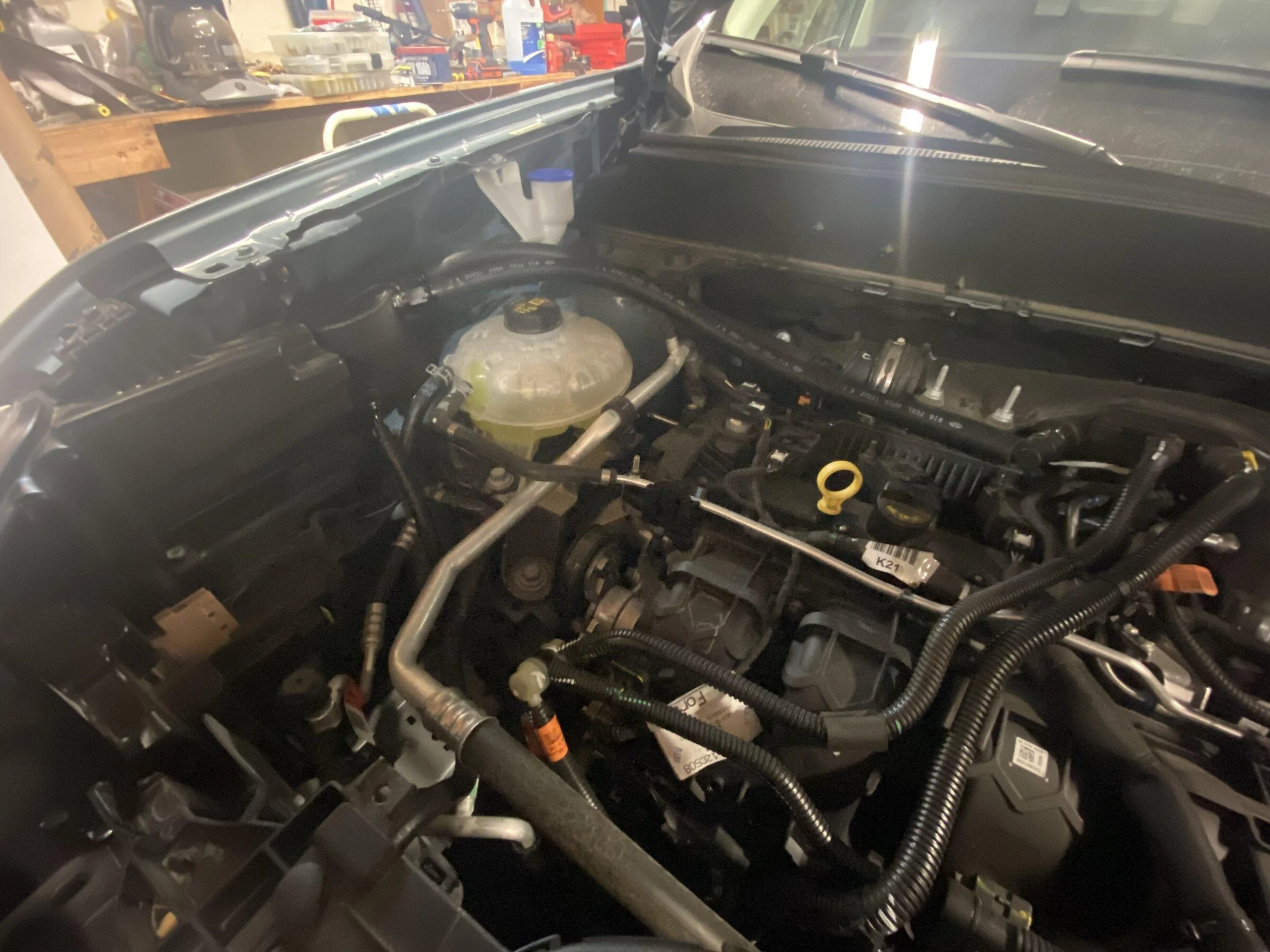

Received my catch can yesterday, had it installed in 10 minutes. Like the look and placement of the can, looks like it came from the factory.
Thank you very much for the review! I appreciate the support!

Looks like the can is tilted. Not that it matters but the stock photos look like the top is level. Is it a lens illusion?
The can sits level and flush to the back of the head light housing.

The can, hoses and connectors are high quality. Installed it looks OEM. I was an easy job.
