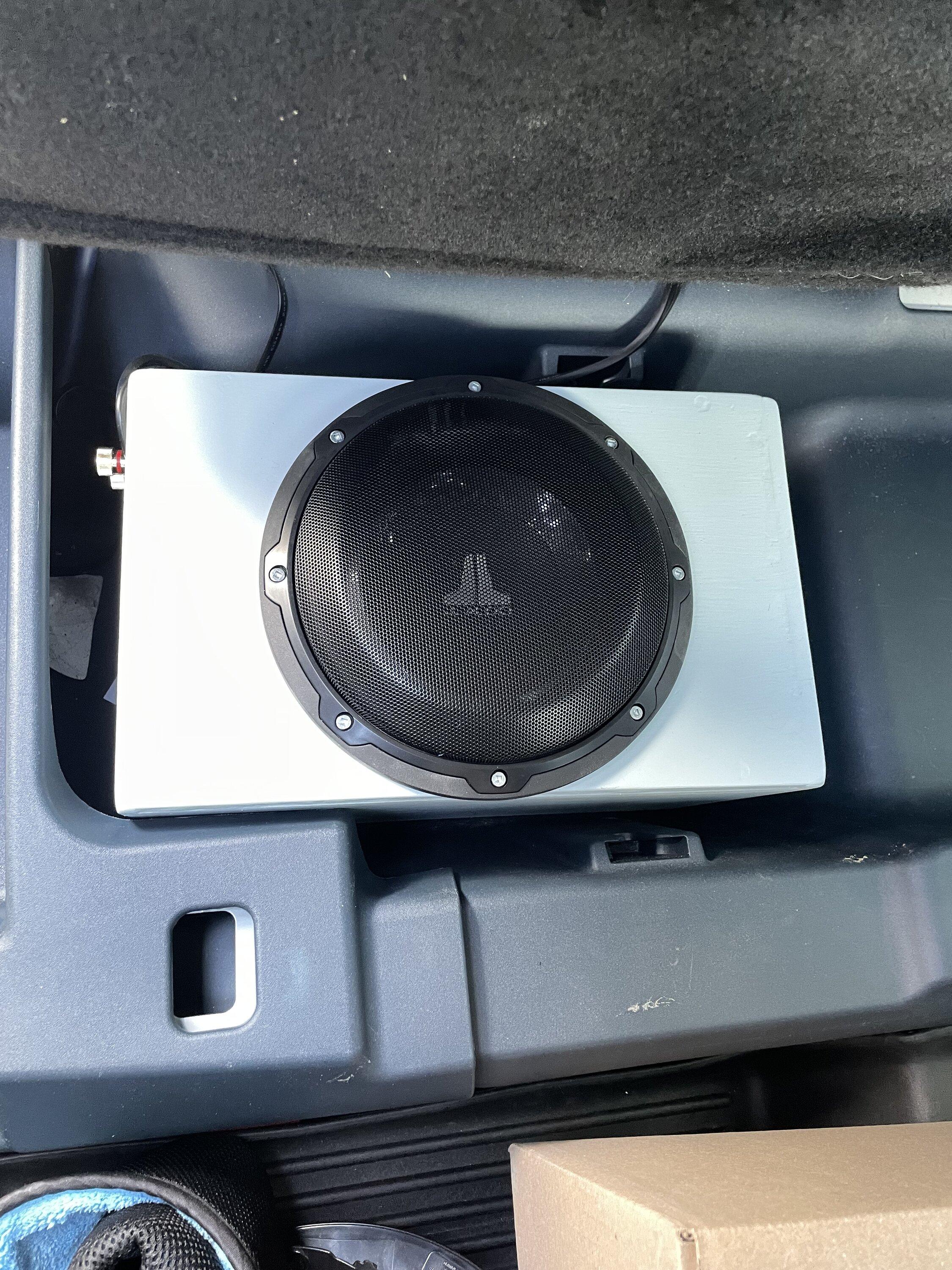

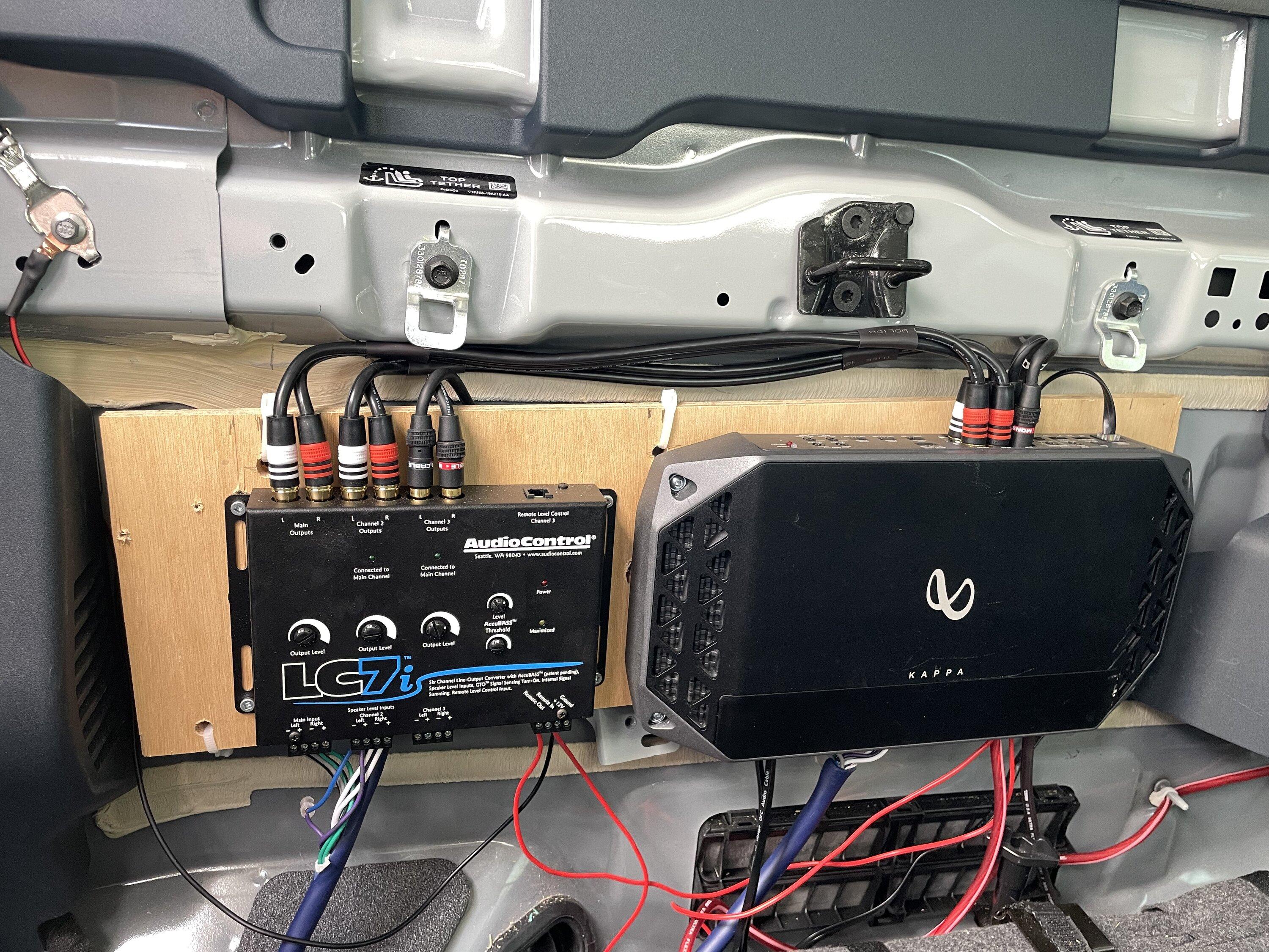

I upgraded my XLT system with morel component in the front, kickers in the back, infinity kappa 5 500 watt 5 channel amp and the audio control LC7 line converter with a JL 8” sub in a 35 sq in box I built. Sound is absolutely fantastic. Not crazy bass but very deep and balanced.
Have any of you done a setup with the line converter? How did you power it? I branched off the amp power line with a 3amp fuse which works but the power on gets wonky.
