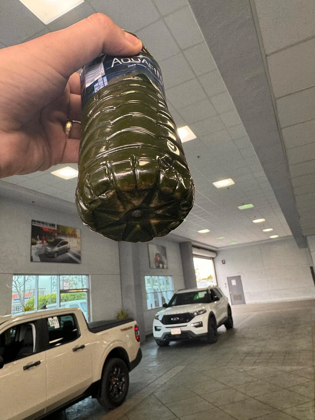

For anyone curious this is what oil from a a brand new maverick 500 miles in and it is why I insist on getting my oil changed asap after buying a new car than again at 1,000 miles (notice all the sediment at the bottom)
-2024 ford maverick XLT Tremor 2.0 eco boost
Please correct me if I'm wrong but I think the break in oil is supposed to look like that for a reason. It's a break in oil for a new engine.
Was under the impression it wasn't even a break in oil, just the oil .
Yup, change oil on a new engine after 1,000 miles to remove any metal shavings then every 5,000 miles after

Crankcase sludge from mfg. and assembly process. Get a sampler of oil that went thru the filter and you'll find it's whistle clean. Sediments in the oil pan are just that, sediments. Having the oil analyzed means nothing unless the oil pan was 100% clean and the oil was sampled before it reached the oil pan.
