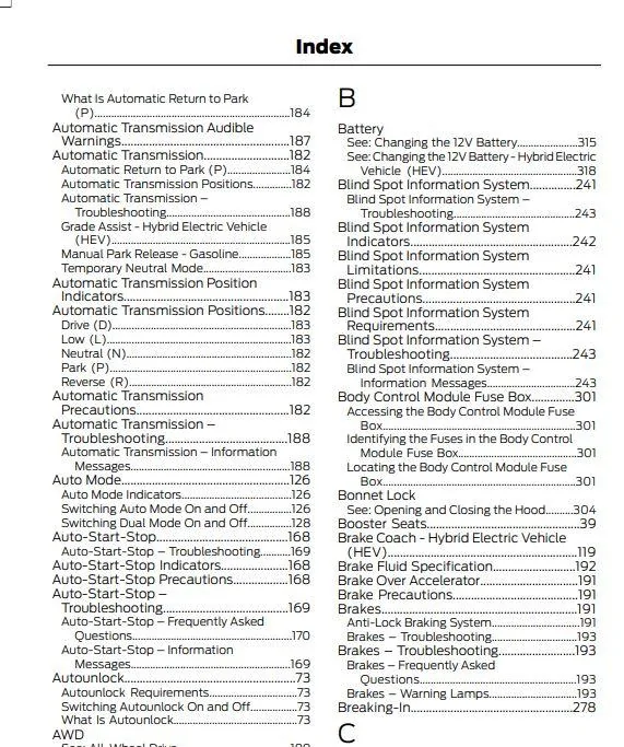

Does the hybrid need engine break in? I have some 160 miles on it. It drives okay but I'd expect it to be smoother and less noisy!!
thanks.
If you look in your Owner's Manual Index: Breaking-In - Page 278!
Ford Maverick Maverick Hybrid engine break in? Breaking In
