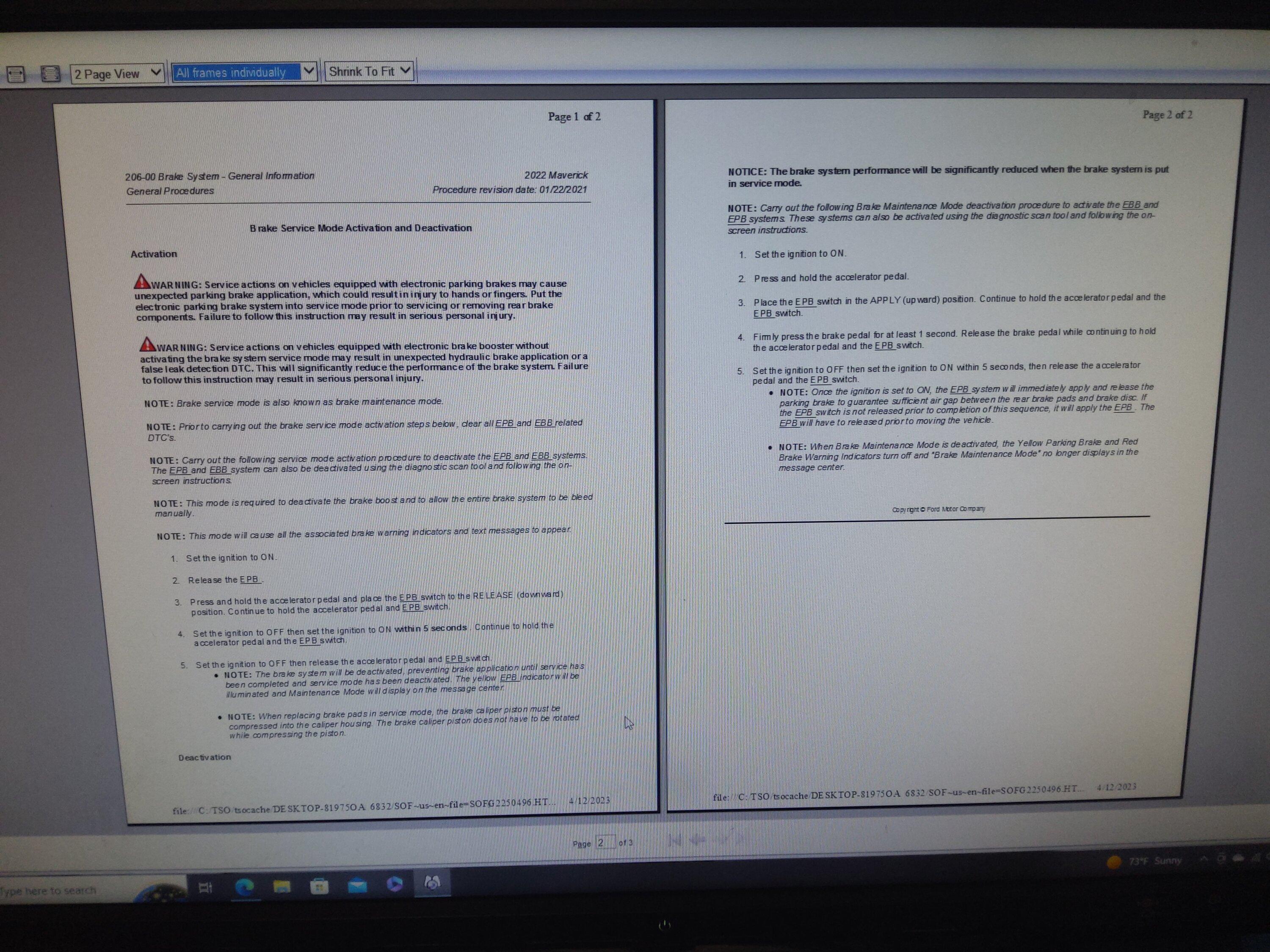

MetalsGeek
Rough
Jan 9, 2022
689
836
Torrance, CA 90503
Down to just the Mav
The 2023 Service Manual does not list separate procedures for the EB and FHEV Mavericks.
For those who want this in plain text form, here is my offering for BRAKE SERVICE (MAINTENANCE) MODE. I have not tested this procedure personally on my hybrid. Given the rate of wear I see on my disc rotors, I may well die before having to change brake pads.
WARNINGS:
  • Service actions on vehicles equipped with electronic parking brakes may cause unexpected parking brake application, which could result in injury to hands or fingers. Put the electronic parking brake system into service mode prior to servicing or removing rear brake components. Failure to follow this instruction may result in serious personal injury.
  • Service actions on vehicles equipped with electronic brake booster without activating the brake system service mode may result in unexpected hydraulic brake application or a false leak detection DTC. This will significantly reduce the performance of the brake system. Failure to follow this instruction may result in serious personal injury.
ACTIVATION
Prior to carrying out the brake service mode activation steps below, clear all EPB and EBB related DTC's. The following service mode activation procedure deactivates the EPB and EBB systems. This mode is required to deactivate the brake boost and to allow the entire brake system to be bleed manually. This mode will cause all the associated brake warning indicators and text messages to appear.
  • Set the ignition ON.
  • Release the EPB.
  • Press and hold the accelerator pedal and place the EPB switch in the RELEASE (downward) position. Continue to hold the accelerator pedal and EPB switch.
  • Set the ignition OFF, then back ON within 5 seconds . Continue to hold the accelerator pedal and the EPB switch.
  • Set the ignition to OFF then release the accelerator pedal and EPB switch.
The yellow EPB indicator will illuminate and Maintenance Mode will display on the message center. The brake system will be deactivated, preventing brake application until service has been completed and service mode has been deactivated.
When replacing brake pads in service mode, the brake caliper piston must be compressed into the caliper housing. The brake caliper piston does not have to be rotated while compressing the piston.
DEACTIVATION
The following procedure will reactivate the EBB and EPB systems.
  • Set the ignition to ON.
  • Press and hold the accelerator pedal.
  • Place the EPB switch in the APPLY (upward) position. Continue to hold the accelerator pedal and the EPB switch.
  • Firmly press the brake pedal for at least 1 second. Release the brake pedal while continuing to hold the accelerator pedal and the EPB switch.
  • Set the ignition to OFF then set the ignition to ON within 5 seconds, then release the accelerator pedal and the EPB switch.
Once the ignition is set to ON, the EPB system will immediately apply and release the parking brake to guarantee sufficient air gap between the rear brake pads and brake disc. If the EPB switch is not released prior to completion of this sequence, it will apply the EPB which will have to released prior to moving the vehicle.
When Brake Maintenance Mode is deactivated, the Yellow Parking Brake and Red Brake Warning Indicators turn off and "Brake Maintenance Mode" no longer displays in the message center.

There are posting about this issue in the brakes services threads. There is no solution other than to use FDRS. Forscan will not put them into service mode properly. FORD has no intention of solving the issue, there is not even a TSB on it even thought there is an SSM to advise service departments of the issue ( SSM 51217 ). They won't fix it because it generates money at their service departments.
...how to enter brake service mode...
Thanks for sharing, but the issue is that some Mavericks simply will not go into service mode.
