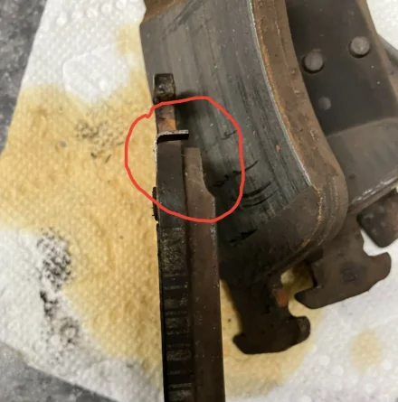

Just finished up replacing my rear pads (62k), found something interesting about the pad design, might help others in the future.
The shape of the pad material is stepped, so I ended up having more pad left than I thought....the flat surface I thought was the backing plate, is actually a couple more mm's of pad, so I had maybe 4-5mm of pad left, before the scraper hit the rotor. Not a big deal, they needed to be replaced, but anyone in the same situation, you likely have a few thousand more miles, if you want to push it...
Just FYI... here is a pic. (I also did the manual method to retract the EPB, worked perfectly...)
