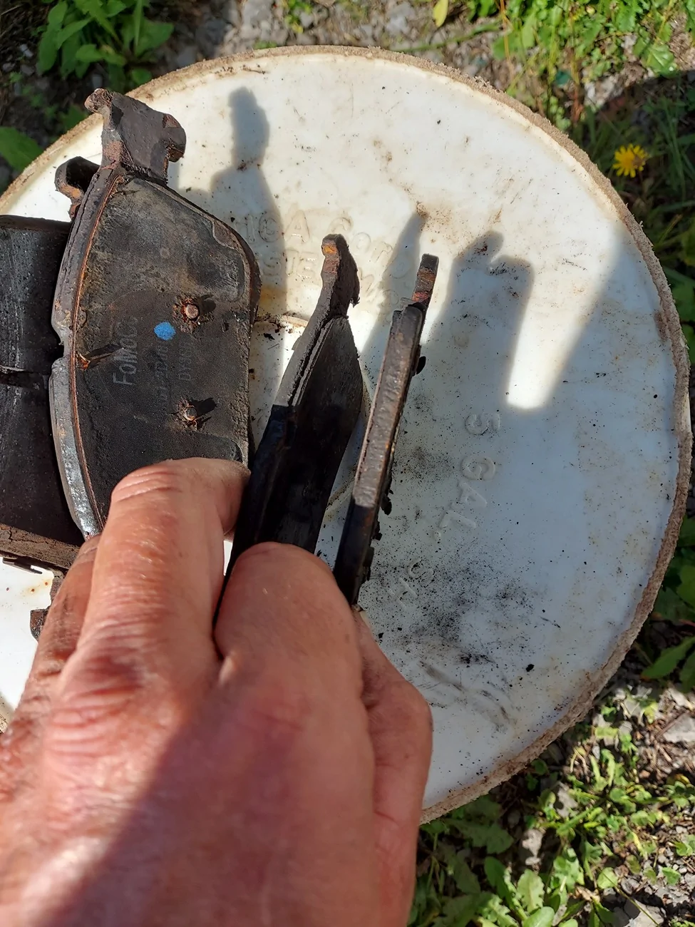

The truck has 22,000 highway miles. Almost 0 city driving and no towing or using the parking brake.
These are the fronts which are 90% there.
Since they're extremely easy to change I put all new on after the dealer did just the rotors.

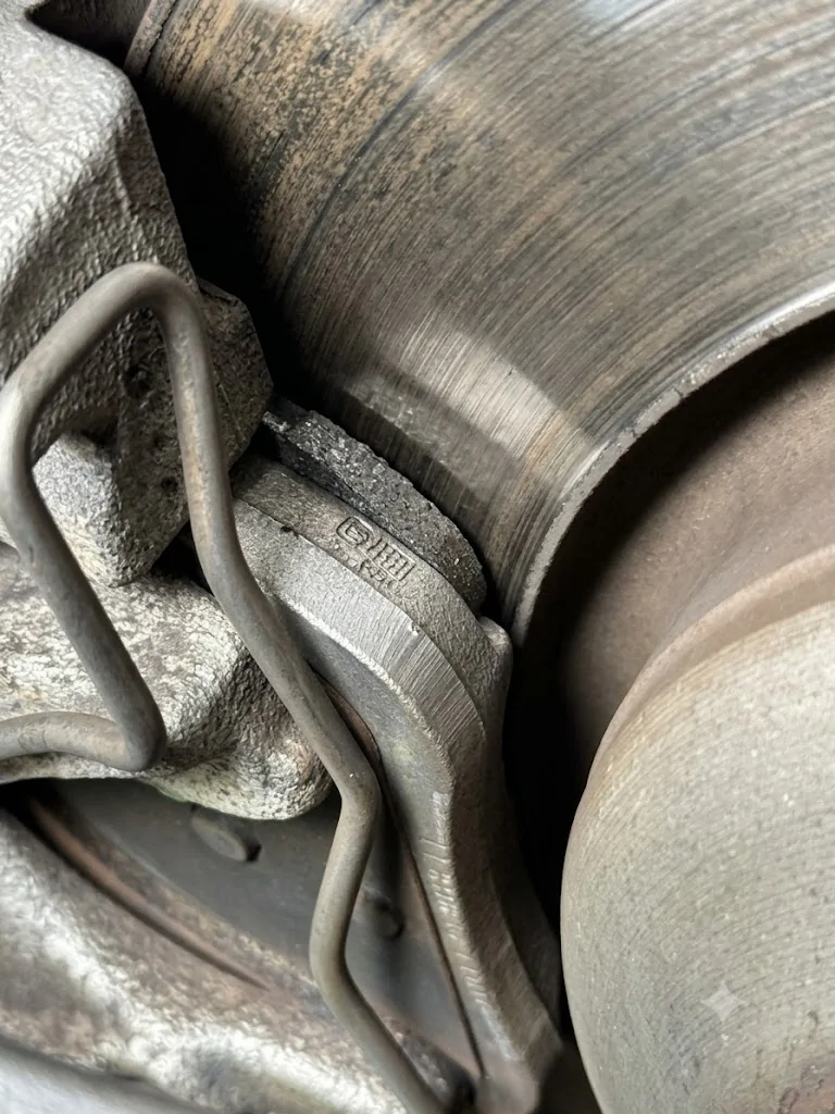

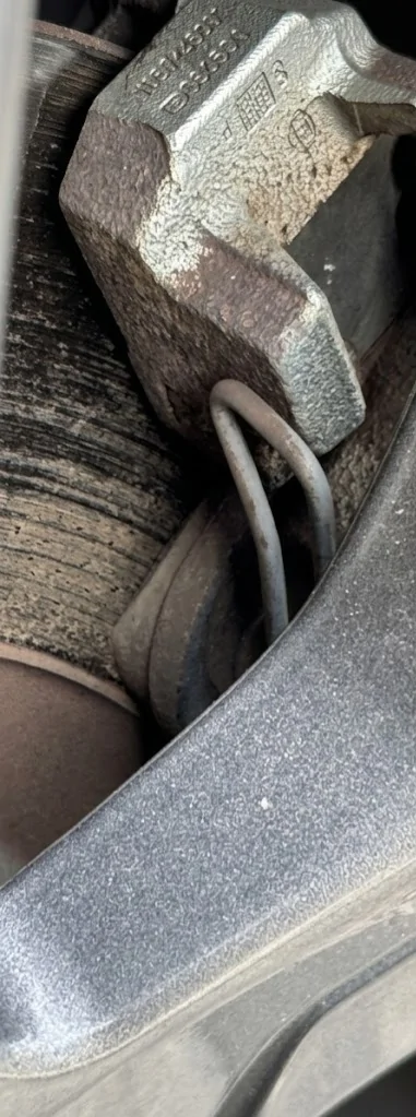

My Tremor has 32K now. I will replace them in the spring. The Mav OEM uses semi-metallic pads that dust and make noise. And the rotors surface rust overnight until the next time I drive it they get scoured clean again by the semi-metallic pads. The rotors are getting scored and pitted a bit. I am going to go with full Geospec coated rotors and ceramic pads when I do them.
