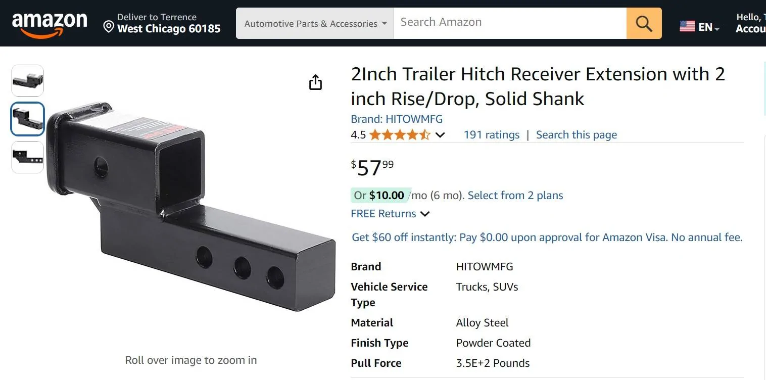

or something like this to drop the receiver?
That part should work! Thank you for posting that. I may need to get that. I don't know the model of the rack I tried on it, it was a nice rack with a ramp. If I had one of those I believe it would fit. Right now, if I can't find a rack that just sits a little lower, I will order that piece. I want to look around at my options. It sounds like the 1UP is a sure bet although a little more costly. The nice thing about the 1UP is that it is US made and that is a great thing.
