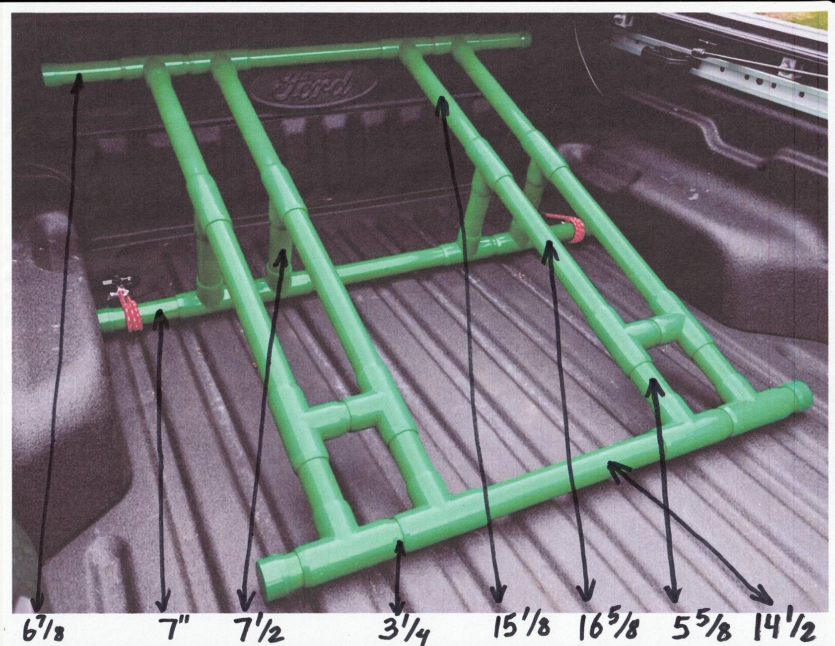

Hi all, here is the bike rack that I made.
Materials:
1. 1-1/4 in. x 5 ft. Green Furniture Grade Schedule 40 PVC Pipe (2-Pack)
2. End caps
3. Tee connectors
4. Nylon rivets
Every joint is secured with a rivet. I decided not to glue anything in case I need to replace a piece in the future.
The rivets are facing down (except for a few places that touch the floor, those are facing front), so the are not visible when you look at the rack from any angle.
Let me know if you have questions.

Looks good why did you choose this over a traditional hitch mount or over the tailgate options?
I have a bike rack but my tonneau cover is the cheap Amazon ones and doesn't have the backflip option so I'm stuck but I always figured I'd just go with throwing it over the tailgate and using a pad if I upgraded or removed the cover.

Great workmanship, I hope you find something safer than bungee cords to secure the front end in the future though.
Thank you. The bungee cords actually prevent the rack from sliding backwards. The front (upper) bar is sitting securely in the groove, while the lower front bar is exactly to the width of the bed. It is very stable. When I use ratchet tie downs, the bungee cords are not even needed at all. They are mostly needed when driving without bikes so the rack stays in place.

Tailgate pads are more $ than this pvc deal. Hitch mounted racks are $$$. Luckily I already had a nice hitch rack. This PVC rack is pure Maverick. It's a cheap add-on that maximizes the Maverick's existing value using the bed.
I wouldn't say a tailgate pad is more expensive and depending on what bike rack you get it may be relatively the same as a pad - talking like $50 and considering that the tonneau cover is likely near a $1000 USD I don't think that was the deciding factor.
I've seen people use PVC pipes before it just seems like more setup for install/removal of the bikes compared to other options so I was curious why that particular solution.
It takes a few minutes, but not that bad.
Putting the rack into the bed and securing with bungee cords - 2 min.
Loading the bikes in - 1 min for 2 bikes.
Securing them with a ratchet tie-down - 1 to 2 min.
So the entire process is under 5 minutes. If you already have the rack in the bed - under 3 minutes.
