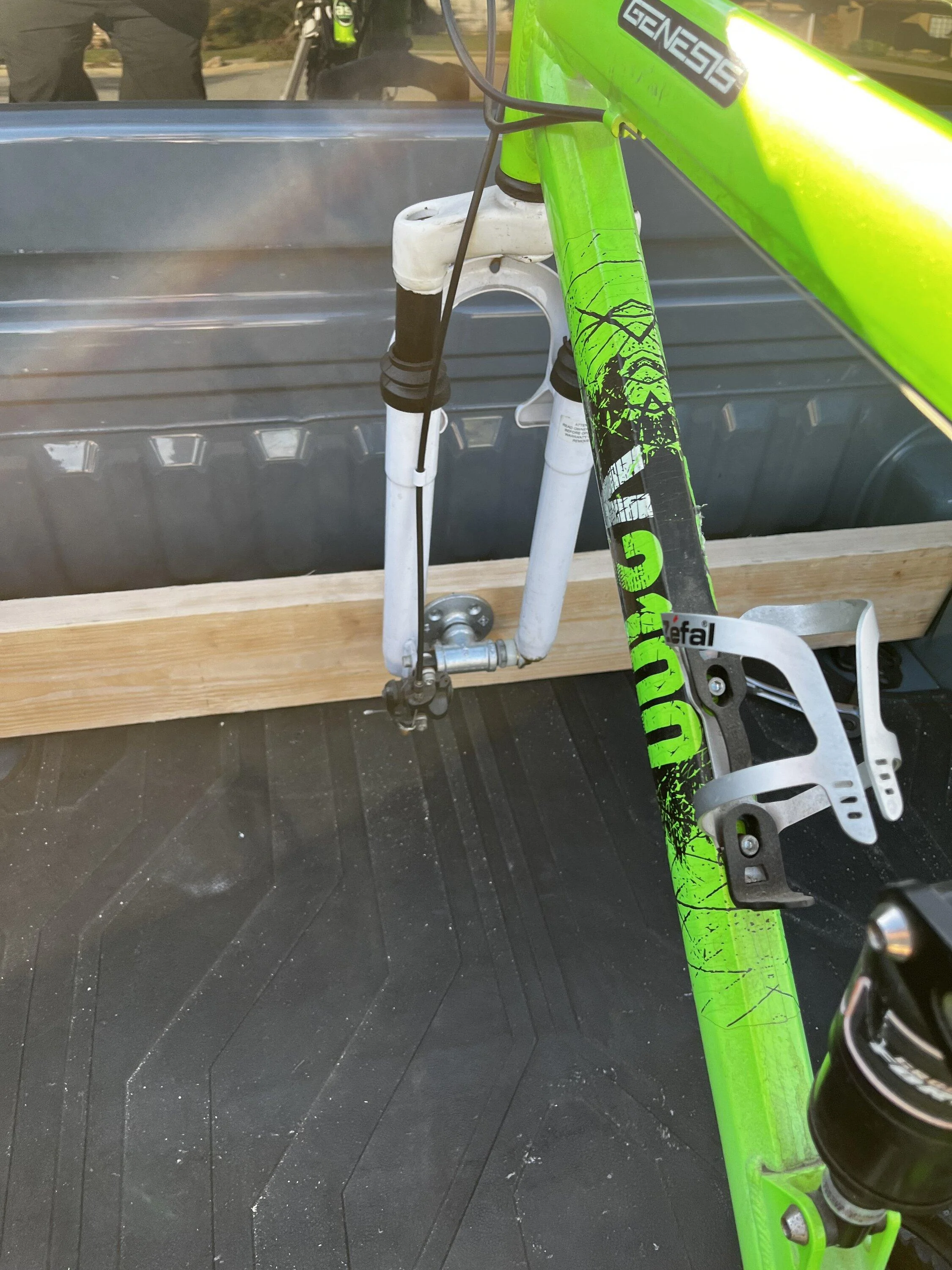

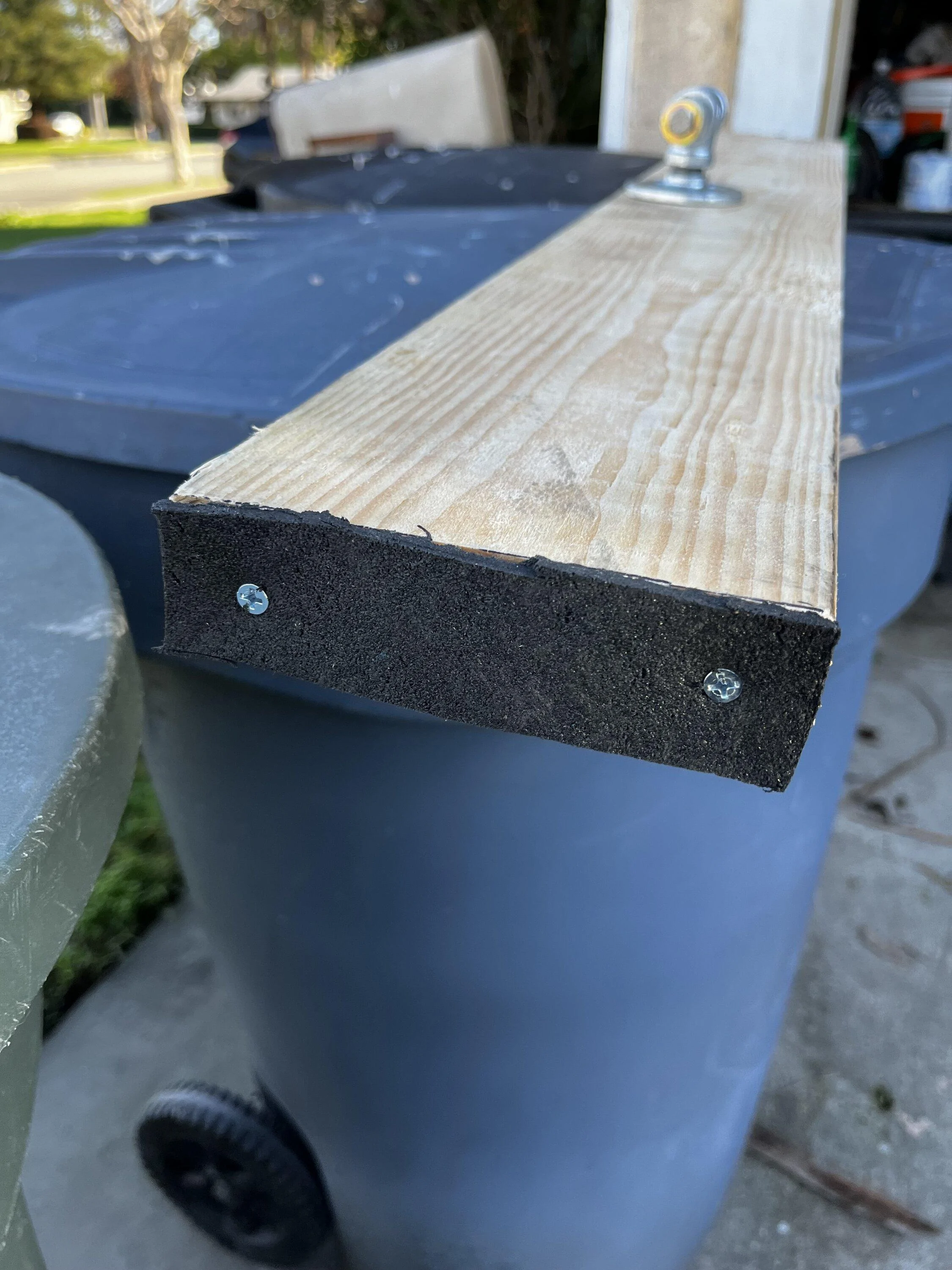

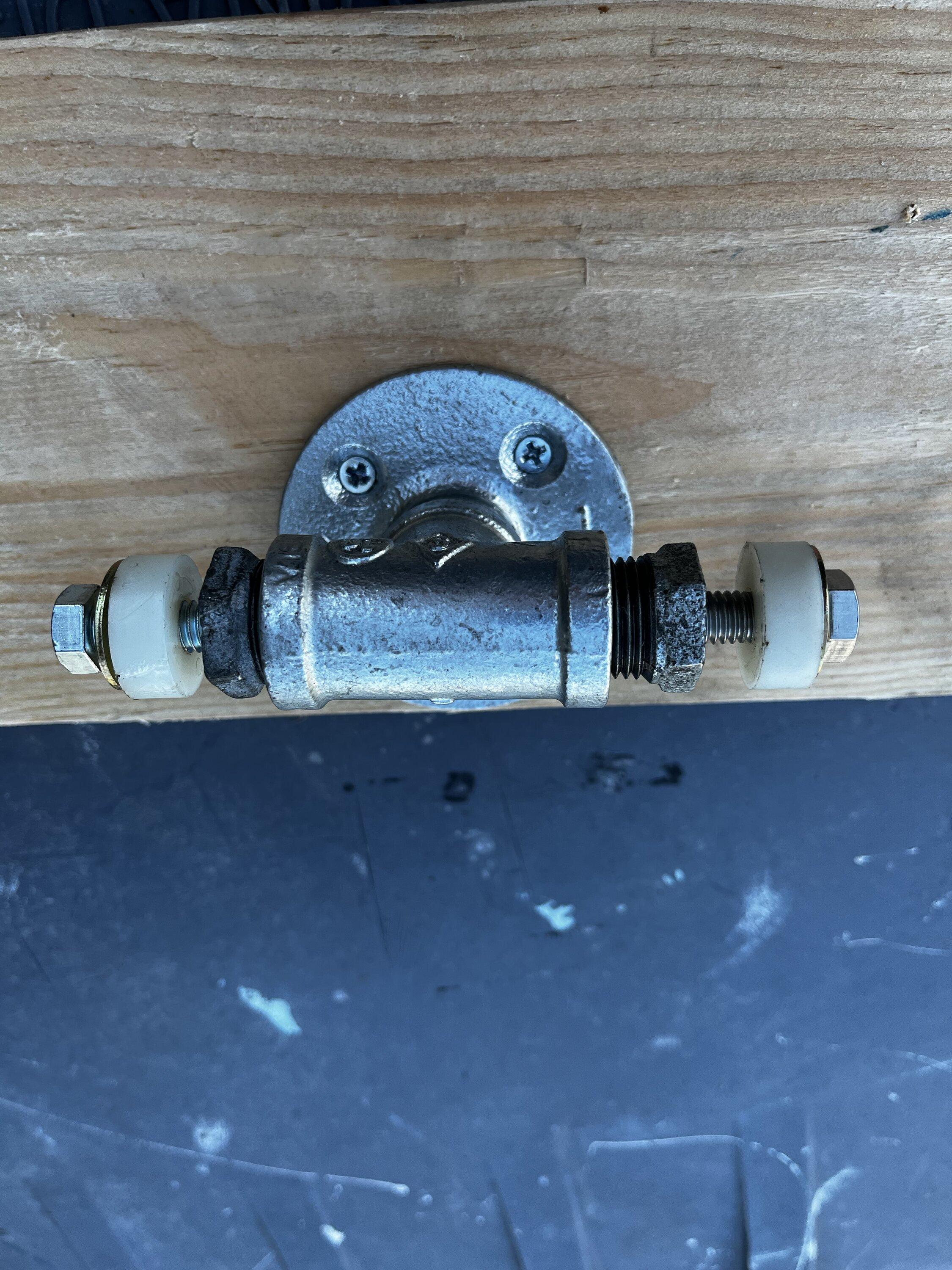

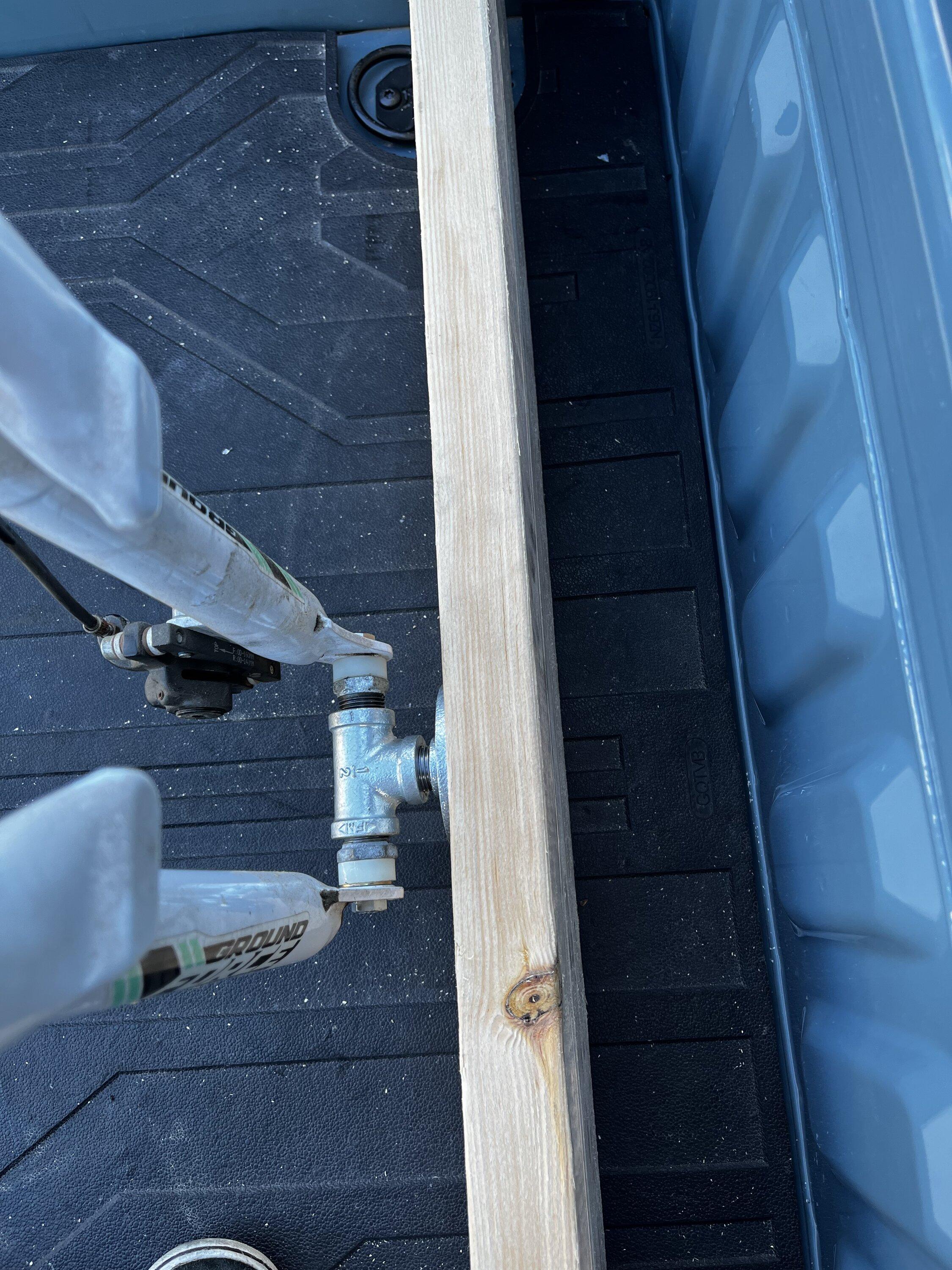

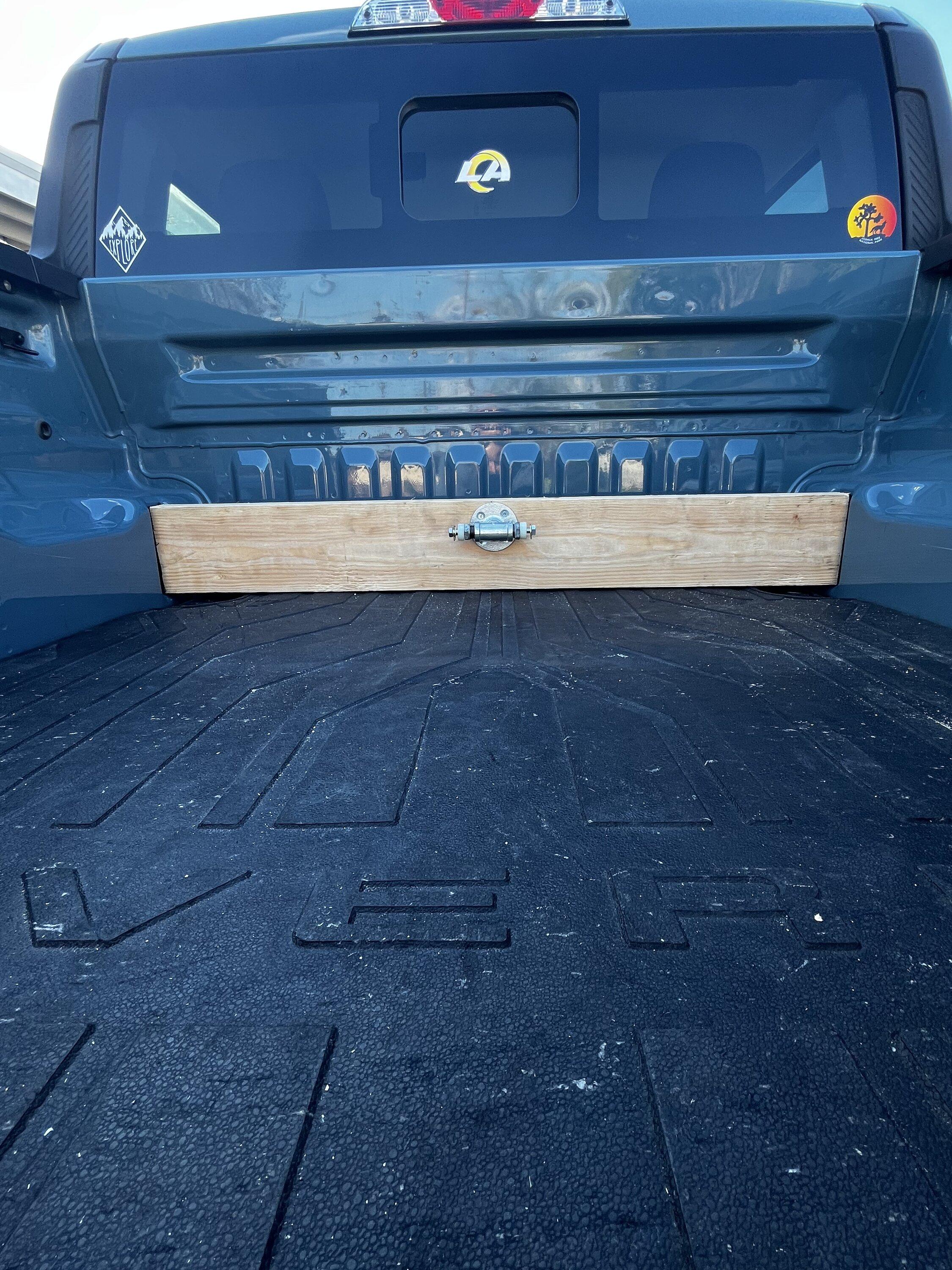

DIY bike rack for less than $15.
1/2” galvanized flange
1/2” galvanized T
1/2” by close galvanized nipple
1/2” X 1/8” galvanized bushing X’s 2
2 bolts and washers
Two plastic 1/2” thick spacers
Two pieces of rubber on each end to protect the bed
