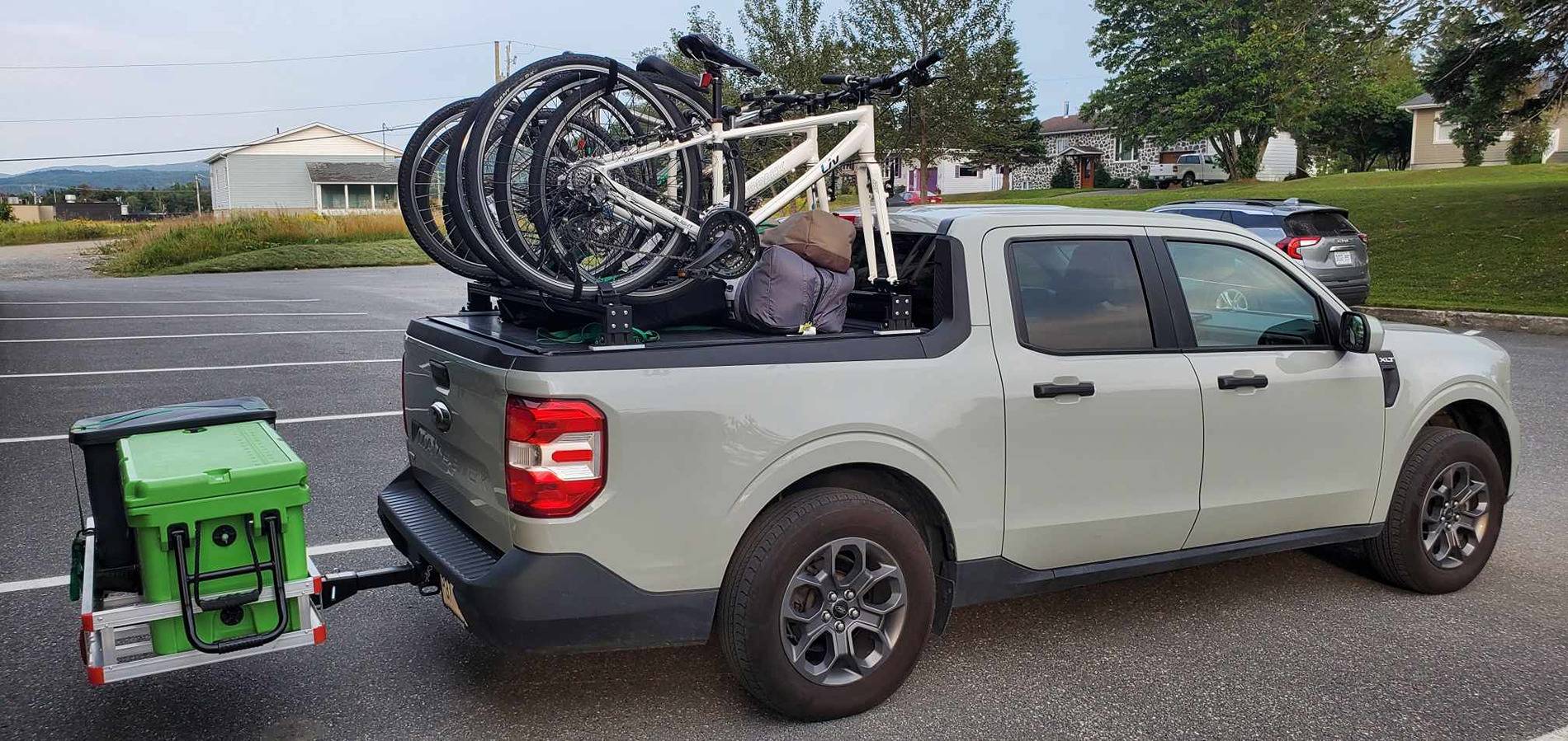

Not sure if that can help but I have the Elevate t-slot tracks and I made a rack out of aluminum extrusions to hold 4 bikes. Used the hitch for the cooler and other stuff.
MPG not afffected. Heavy face winds made MPG much worst than any cargo on that particular trip.

Wow impressive - I plan to use the receiver to carry my two electric mountain bikes when I flat tow the Maverick behind my RV

That looks awesome man! May look into something like this.

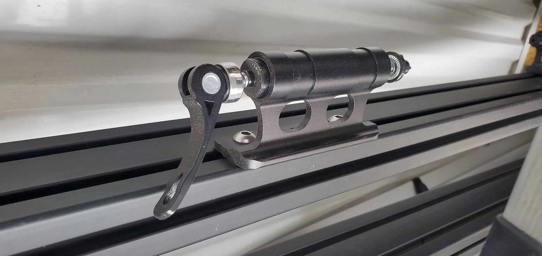

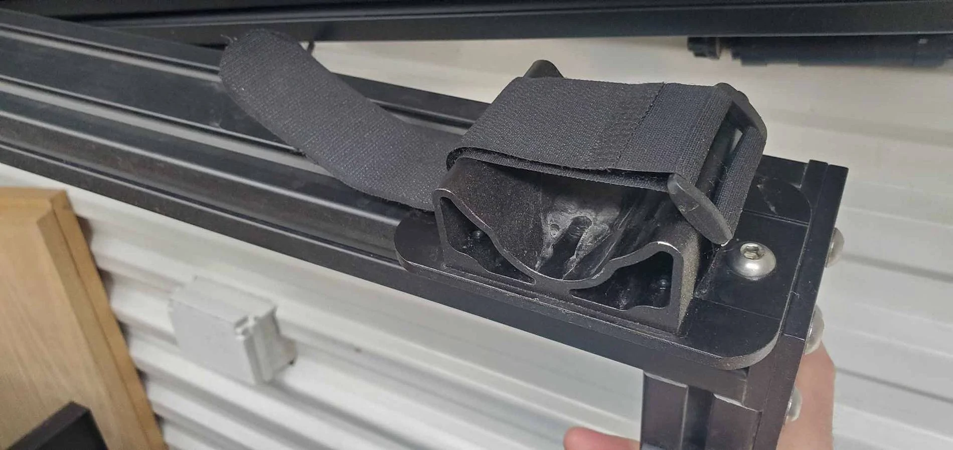

Thanks!
Ordered the extrusions at the proper lenght with hardware and just assembled. No cutting required. I used rectangular 15 series (1.5 inches x 3 inches) but it is overkill as I was comtemplating putting a roof top tent on the bars.
If I had to do it again for bikes only, I'd go to a square 10 series (1" x 1")... would be much cheaper and lighter.
All bike specific hardware available on Amazon (fork holder, rear wheel holder and I velcro straps to hold the front wheels to the rear wheels):
