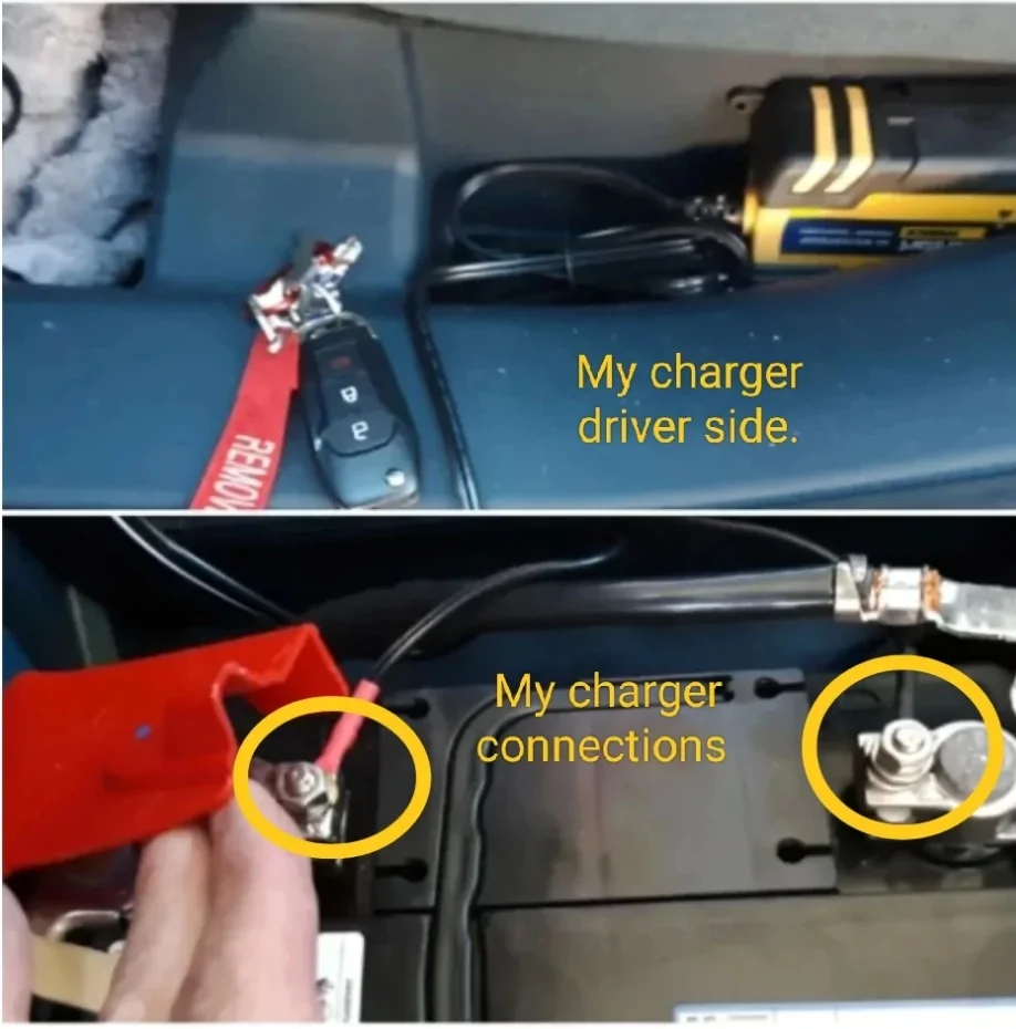

I have it connected directly to the battery. I leave the charger in the truck hooked up 24/7
No diy cutting, no added resistance
That's Best and Convenient for me, because
Nobody has provided any proof that it's detrimental to the system. (I'm sure someone tried looking, but came up empty with actual facts.)
And if you're talking about a little mini amp charger. I want a little resistance as I can get.
This is how I have mine hooked up.
2 years and I haven't had a problem. Only had to use it twice.
I still have the original flooded 2023 motorcraft battery.
The charger stays in the truck hooked up 👍🏻 easy peasy. So

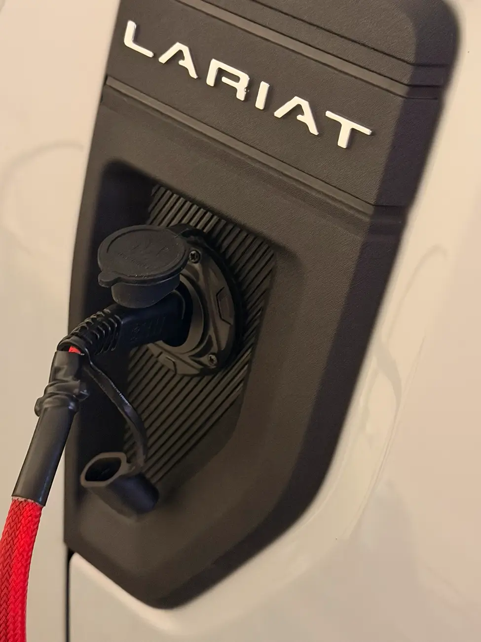

I did it under the hood on the jump posts on my '25 hybrid awd.
I got these
https://amzn.to/4vo7VZT
and extended the wiring to the passenger side since the way I park in the garage there's no outlet on the drivers side.
I got this idea from another forum member on here and mounted it on the fender side trim below the lariat badge.

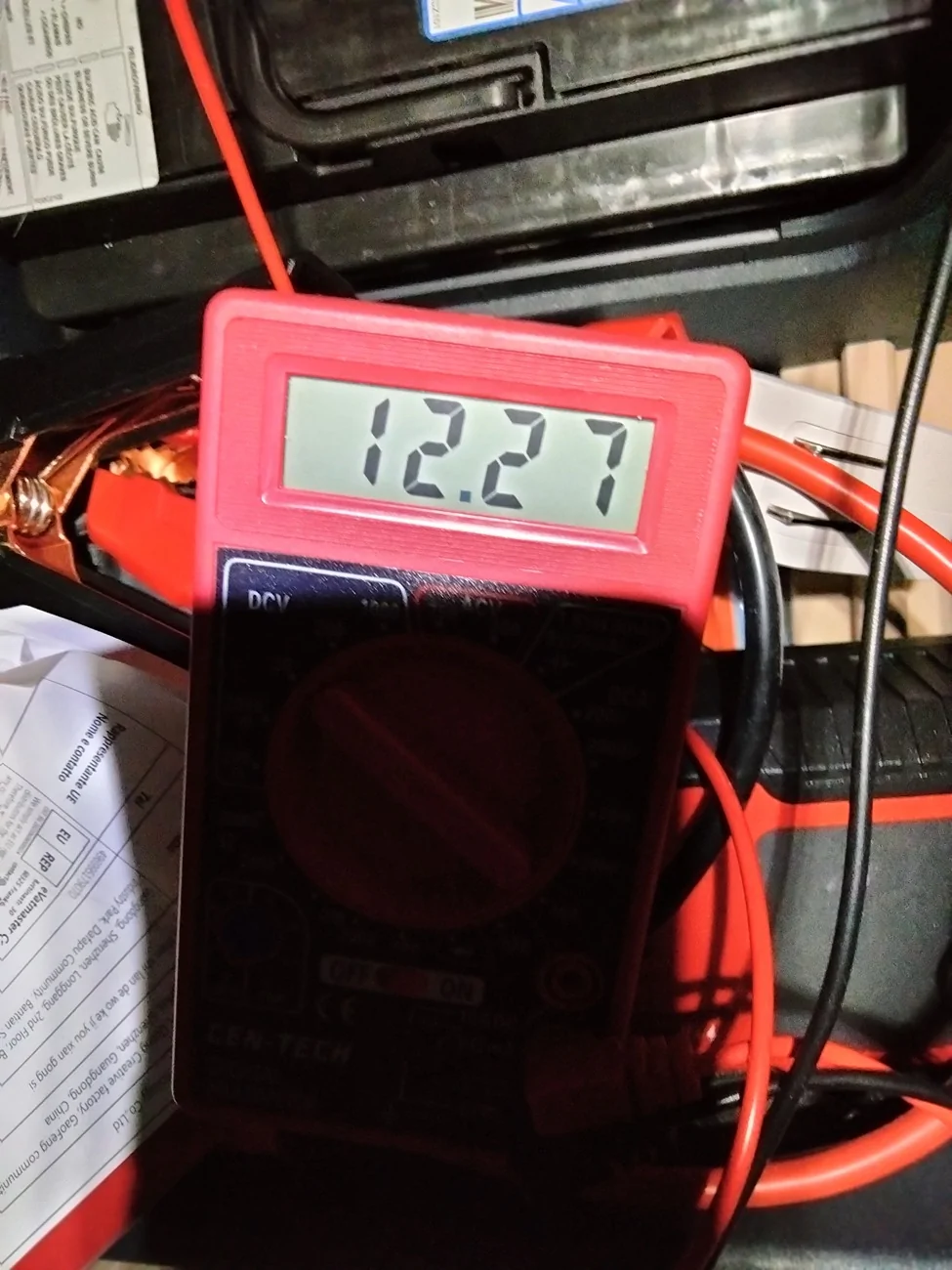

Just now I went out to my truck with a voltmeter. I opened the door and with all the standard interior lights and bed lights, tail lights, parking lights on. This was the reading on the voltmeter from my ORIGINAL 2023 flooded battery.
Sorry about the shadow. It's my phone. I was shining a light.

Just now I went out to my truck with a voltmeter. I opened the door and with all the standard interior lights and bed lights, tail lights, parking lights, on this was the reading on the voltmeter from my ORIGINAL flooded battery. The shadow you see is my phone I had a headlight on.
That's about what I see with our BS -- with both the OE FLA battery and the replacement AGM.
