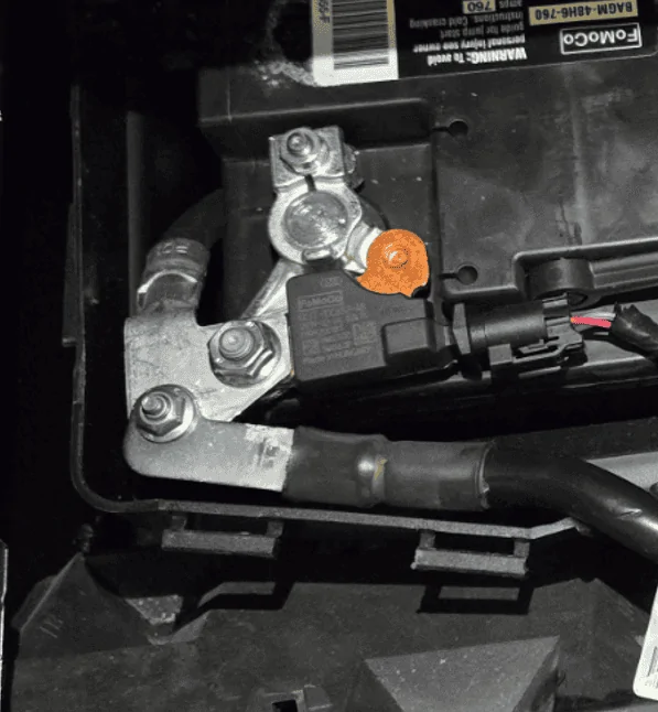

The battery control module (BCM) constantly monitors the battery's charge and discharge. Nothing should be connected to the negative post of the battery... not a charger or any added accessories. Has nothing to do with a spark. It has everything to do with the BCM knowing the exact state of the battery.
Yes, even when the Maverick is shut off the BCM will know the battery is being trickle charged or something is drawing power from it as long as nothing is attached to the negative post which is before the BCM sensor (shunt) attached to the post.

Yes, the point of not connecting directly to battery ground, is so that the system sees the battery being charged and updates the battery state of charge accordingly.
I think there are many reasons to do it properly, leaving the sensor to see what is really happening.

I have a 12 volt cord for supplemental braking while towing. I connected the positive to the nut on the positive terminal at the battery, and then I drilled a tiny hole in the flat bar of the negative terminal (the sensor is between this hole and the terminal post) and screwed the negative terminal there.
Like I said, I do not know what this computer does, but it is smarter than I am, and I think the BMS has done some learning and adjusting over time. I also have a bluetooth voltage tracker/alarm to ensure all is well, and when being towed, it is receiving a charge from the charge-wire in the 7-pin connector. That charge wire is connected to the jump terminals under the hood.

Note that the negative lead in the EB models goes from the battery to the negative jump post under the hood. Someone posted that he unscrewed it and added a ground wire with multiple female plug in receptacles.
My transit has 2 nuts that can be used to add terminals. I was surprised to see no way to bolt anything onto the terminal on the Hybrid battery in the back seat without drilling a hole for a screw. This is the 2020 Transit's negative terminal, with two nuts that can handle terminals (there are two batteries and the cable on the bottom is ground, while the other cable runs to the front battery, concealed under the seat):
There is an extra screw terminal on the hybrid's positive battery terminal. It's on the side, facing towards the rear of the vehicle. Kind of awkward to get at.
The BMS sensor is on the NEGATIVE side of the battery, I just loosened the nut that acts to secure the positive post and slipped a U connector there for the positice connection. The negative was the problem...finding a place to connect AFTER the sensor. I will look for that positive screw terminal...it would make for a bit more sanitary connection.
For the negative side the ground cable only connects ~7" away bolted to the floorpan.
