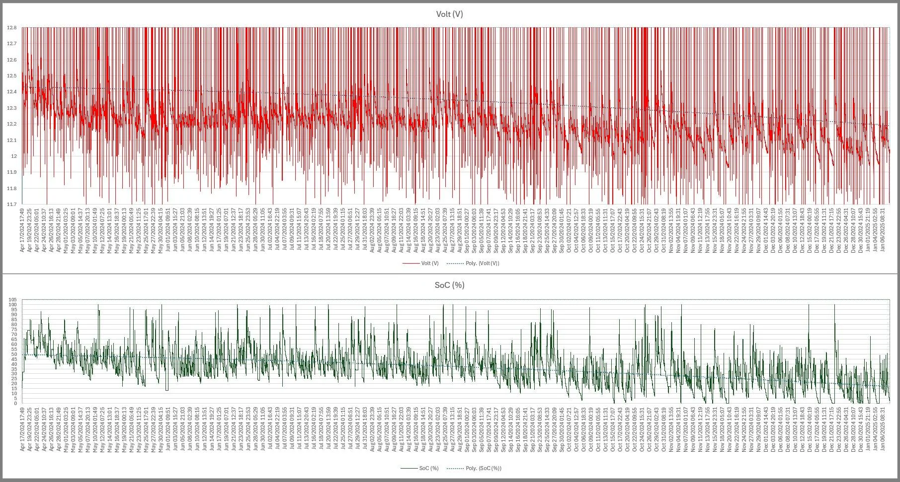

<Sarcasm ON> When you look at all of the data I have on my 12v battery since installing the monitor, I am not entirely sure, but there might be a trend starting to show? <Sarcasm OFF>
Maybe I should start taking bets on when I will have to pull out the jump box & jump start it for the first time!
I should probably check and make sure it's fully charged!
Do this betting pool right you might just pay for a better battery!
Just by day? Multiple picks of same day allowed, and we have to split it?
I'll take Mar 9th.

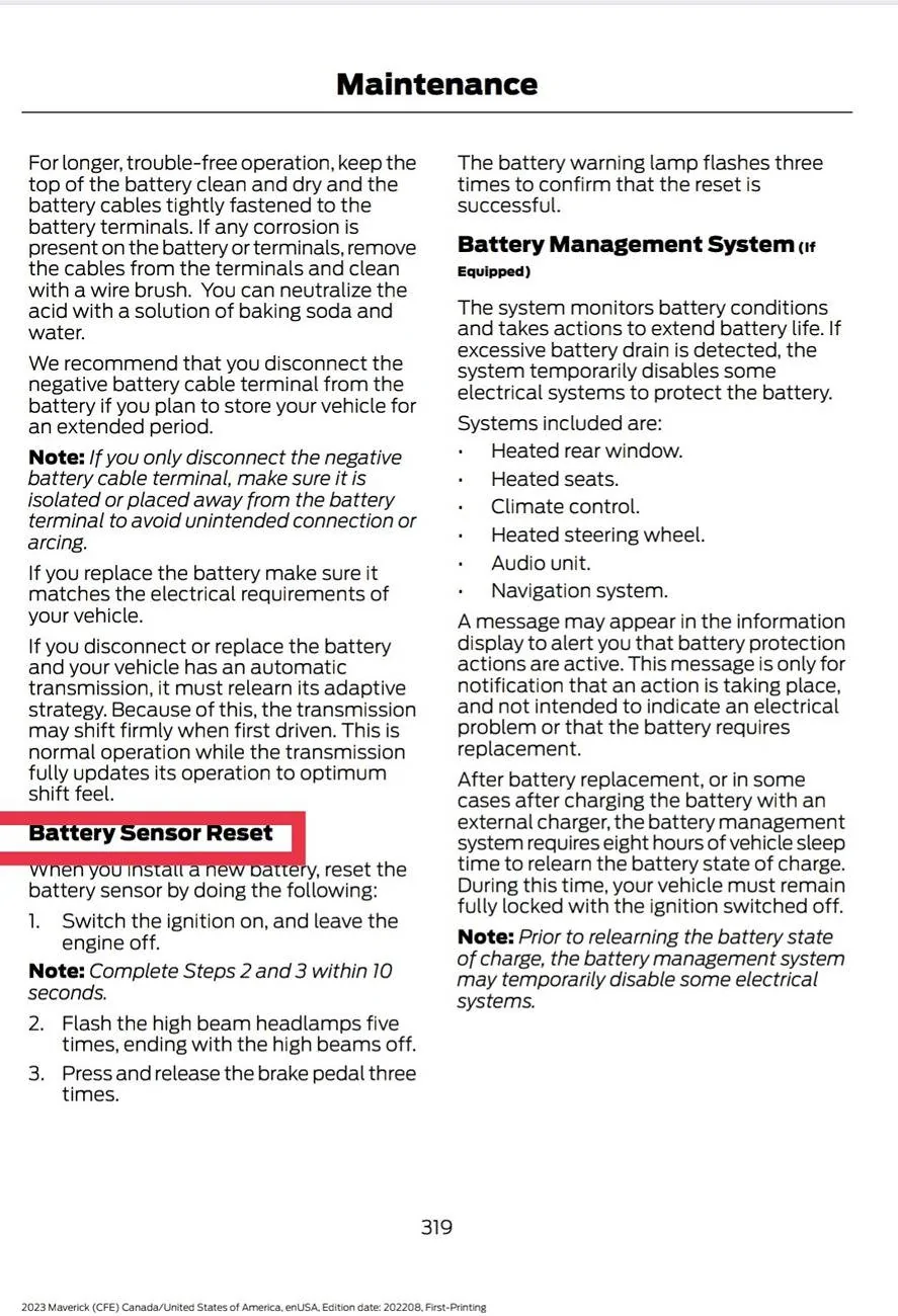

I put in my own AGM battery and still having deep sleep issues, I hooked up a solar trickle charger and turned off the wifi etc. so no more ford pass. See what happens . this is my third battery in a year and a half, my understanding is the Maverick uses the same set up as the Escape, wonder if all those owners have the same problem?
When you replaced the battery, did you reset the BMS with a fully charged battery per the Ford procedure including the 8 hr rest period?

Yes I did reset each time .

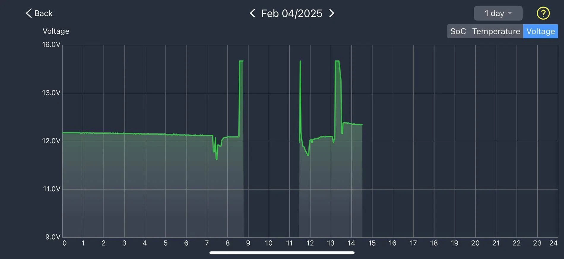

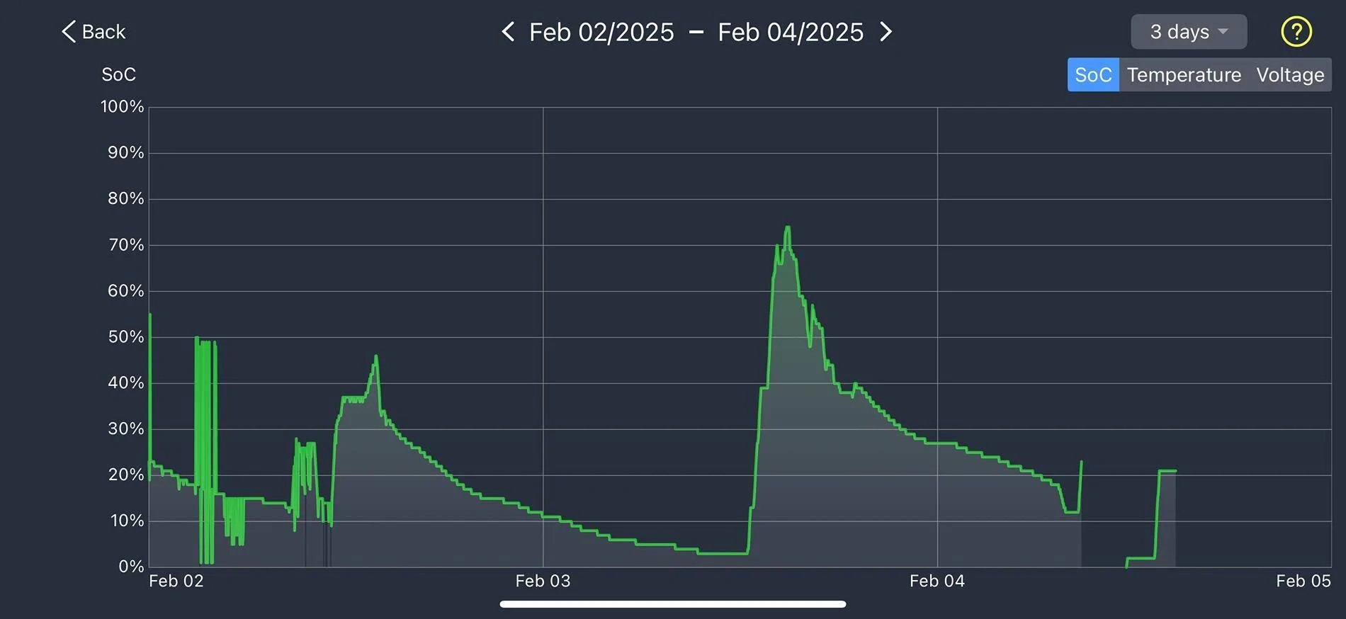

Well, no new battery, they apparently did the SSM process and said the battery tested fine. I could see my truck in the app while I was waiting to pick it up and the location showed it in the dealer parking lot, but 5 mins after parking it in my garage I got a deep sleep message again. Oh, well hopefully the fix is coming sooner than later.
I also had to reset the oil life cause the service department did not. Not a big deal for me but not everyone knows to check this after you pay someone to change the oil.
I would assumed they would have charged the battery (silly me) its currently @ 21% SOC. They did reconnect the monitor, so I guess that's a win?
