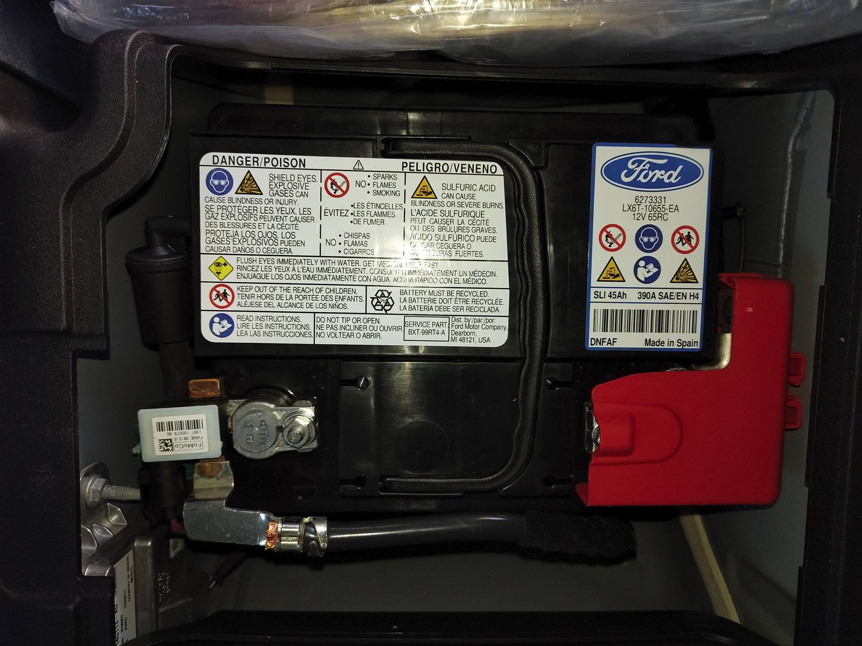

So the BXT-99RT4-A battery isn't AGM because the dealer told me it was?
Take a pic and post it here just to be sure. Unfortunately, not sure you can trust anything a Ford dealer says anymore...................................................
Correct, BXT-99RT4-A is the lead acid battery that the workshop manual calls for for 22-24 Maverick hybrids. BXTs are always conventional flooded lead-acid batteries.
The Ford part numbers for AGM batteries always(/usually?) start with BAGM.
The AGM battery in the 25 Maverick hybrid is # BAGM-H4.

Just found this thread and wanted to add my experience in my '24 Hybrid thus far. Got deep sleep/battery saver notification for the first time in mid December. Drove a decent amount, including a trip to the airport to leave for a few days for Christmas. Got another notification the day before I got back, but truck still started without issue on 12/27. Drove it the 75 miles home from the airport plus another 60 or so miles that day. Still ended up getting the battery saver notification, and by 12/30 the truck wouldn't start at all.
Had truck towed to dealership, diagnosed as a battery failure due to sulfation. Replaced under warranty with another BXT-99RT4-A, BMS reset, and got truck back on 1/2. Woke up to the same battery saver notification with the new battery, and truck won't start again on 1/3. Back to the drawing board...
Yikes.
Well, except for that 12/30 day - the battery saver and deep sleep routines worked to allow truck to start.
Would be hard to believe you got a bad battery as next one off their shelf - but that is possible.
Not like any of them are really great anyway.
Might take a peak at Negative battery terminal - mfg date is stamped there.
