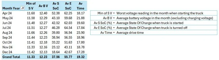

Well I set up the pivot to show the worst voltages at starting of the truck...
Wow - nose dive with the temps?
Or your temps really nose dived too?
And I'd bet that Av E SOC includes a little standing charge on turnoff?
Still only seeing 10A starting charge for a few minutes of each drive?
Well, thanks for making me feel better about my normal 11.6-11.8 starting V in the morning.

Very nice table. My average SOC tends to be in the neighborhood of 30%. This is according to dealer reporting remotely.

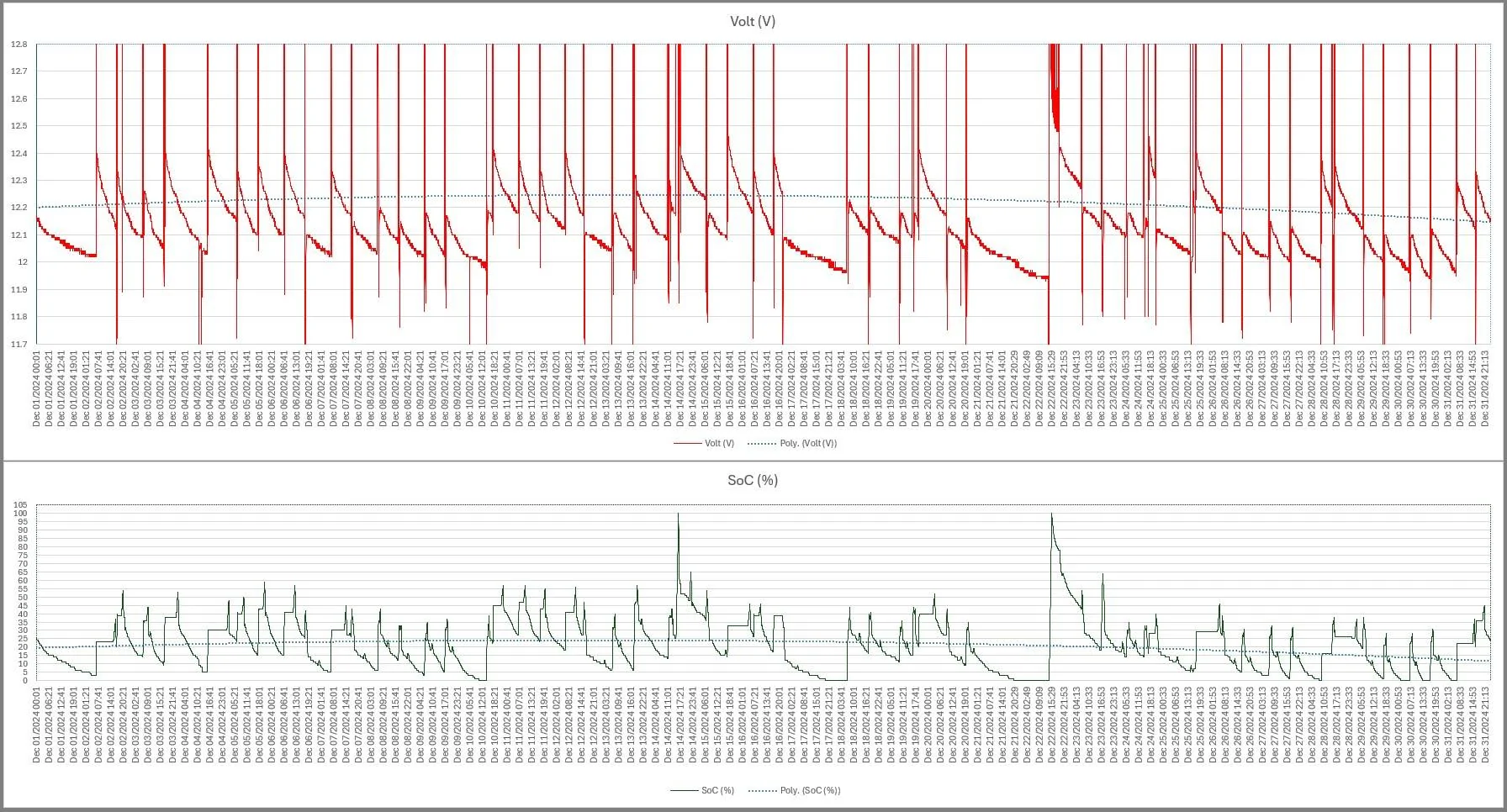

On the hybrid trickle charging the 12V battery periodically appears to be futile. The two spikes in the SOC was when I put it on a charger (using the jump posts). Note how short lived the fix lasted. The BMS or the battery do not want to cooperate. Note: on this graph I cut the highest voltage shown off at 12.8V in order to show the stored voltage better.

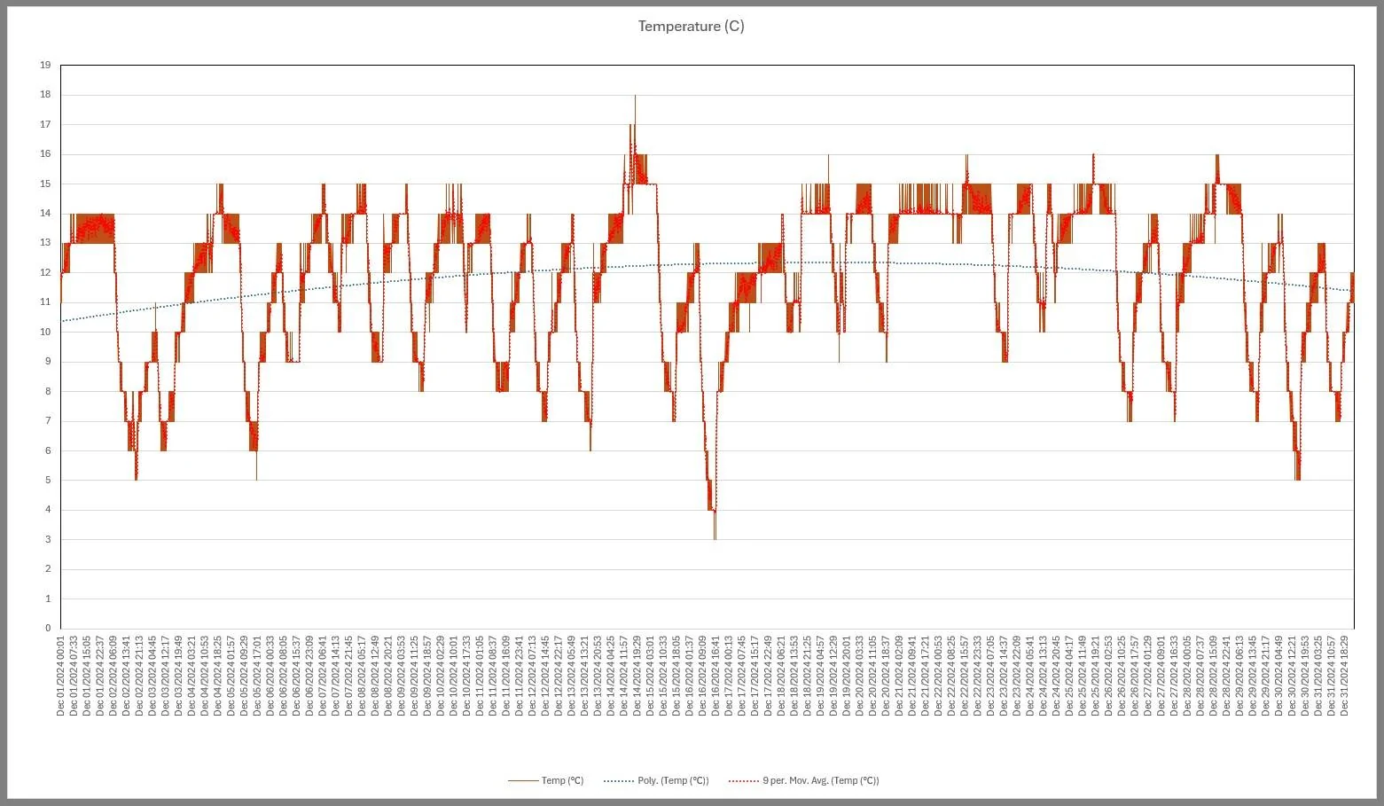

Being on the Wet Coast of Canada means our temps are usually mild. Here are the temps at the battery (obviously under the back seat) for the same time period. My truck is stored in a slightly heated garage at night but sits outside at work 5 days a week.

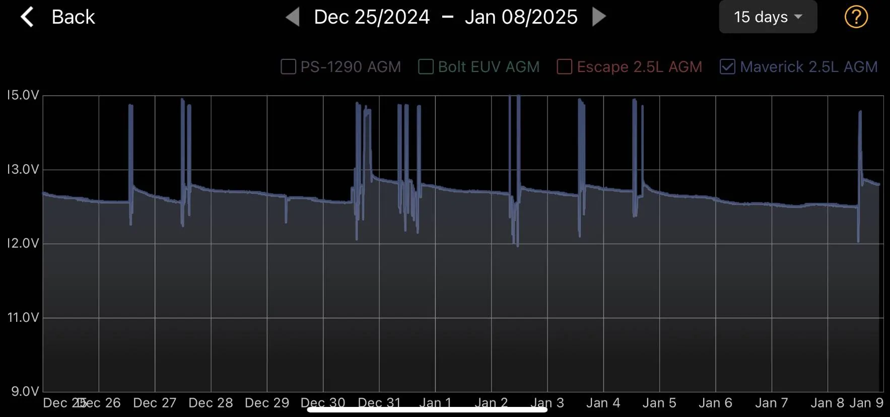

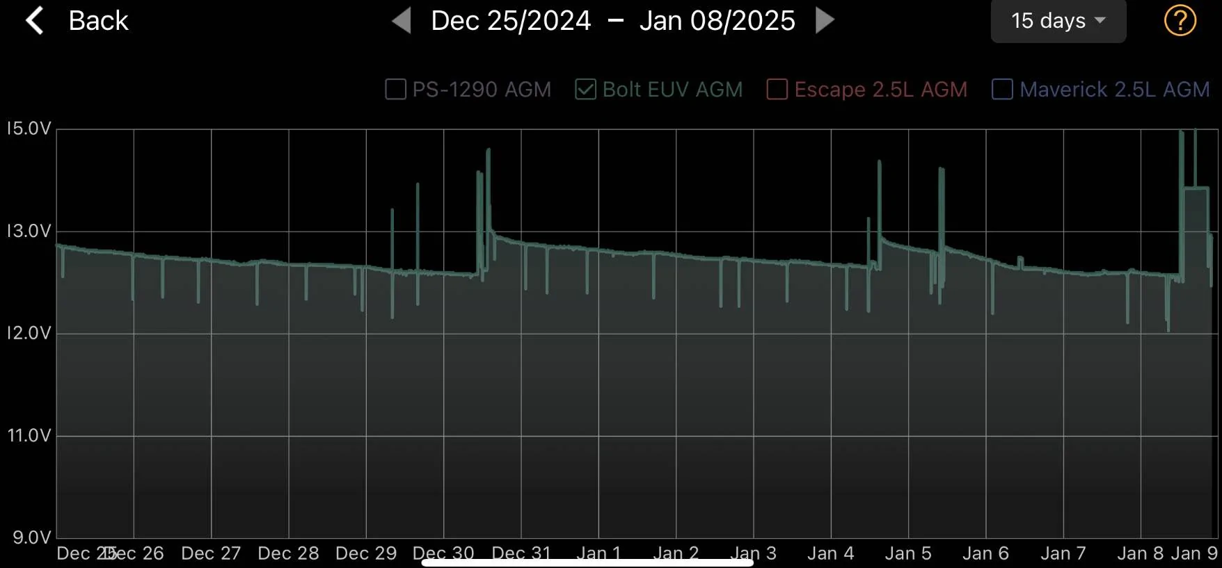

AC Delco LN1AGM in both Maverick 2.5L and a Bolt EUV. Their battery Voltage Level trends are similar.
Maverick Battery Monitor:
Ford Maverick Battery Drain issue Maverick 2.5L  LN1AGM Dec 25-2024 to Jan 8-2025 - Chart
Bolt Battery Monitor:
Ford Maverick Battery Drain issue Bolt EUV  LN1AGM Dec 25-2024 to Jan 8-2025 - Chart

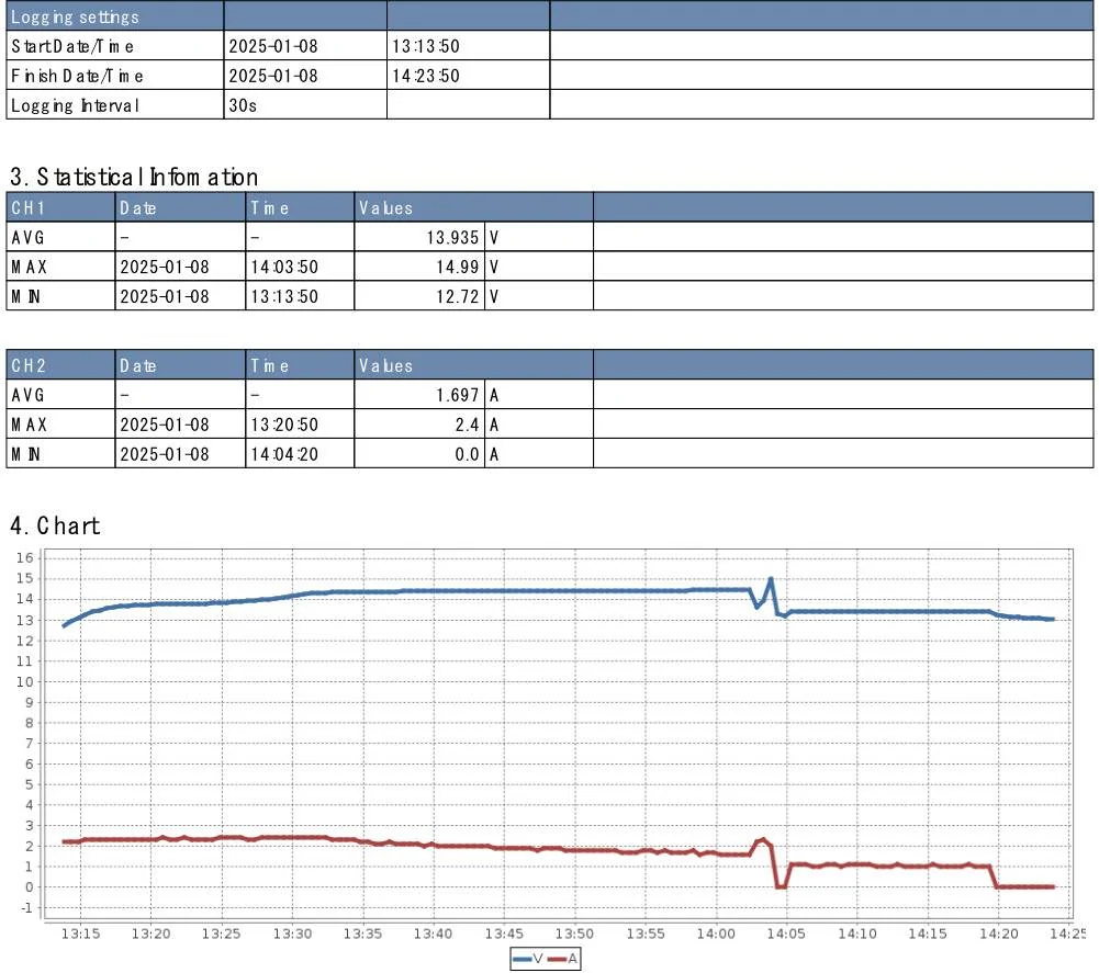

Maverick LN1AGM Charged with Deltran 15A charger set to Auto.
Ford Maverick Battery Drain issue Maverick 2.5L  LN1AGM - Deltran 15A Charger Log 2025-01-08
