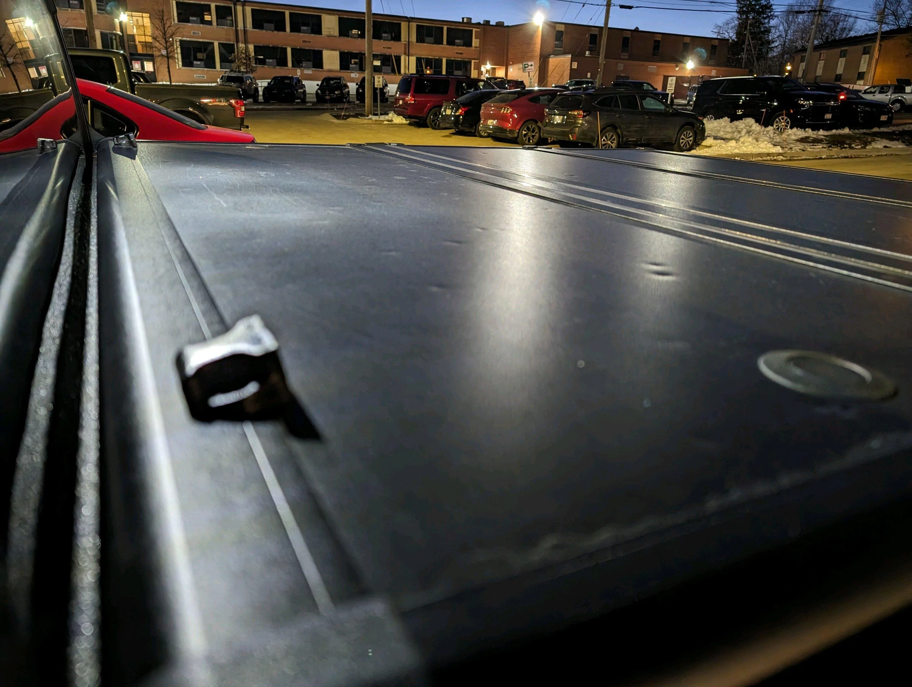

All I can tell you is I bought an Undercover Triad from NAPA for my truck. Had a hail storm with nickel size hail and this is what my cover looks like. It is suppose to be strong enough to hold over 500 pounds, but the hail sure did a number on it and the truck is fine. Not saying the Ultra Flex is bad, but I did not expect the Triad to dent either. Maybe someone else has experience with the MX4 in a hail storm. FYI
Ford Maverick BakFlip MX4 or Undercover Armor Flex Tonneau? hail

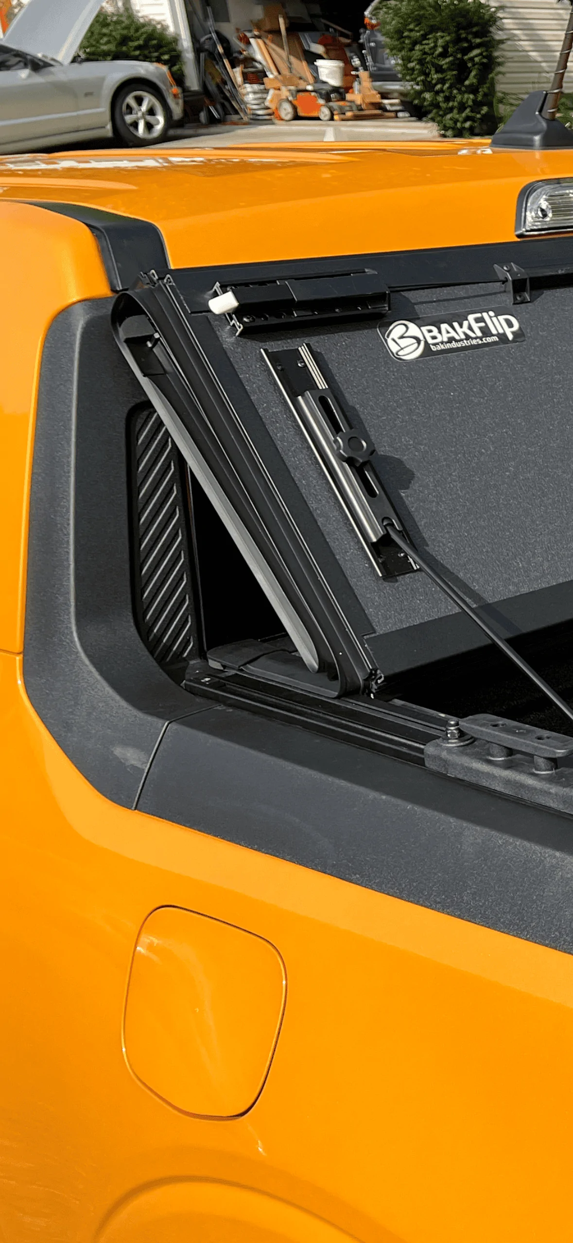

BakFlip MX4 Tonneau
👎 Rests on paint or rear window in fully folded position (although I've found nothing about broken windows or marred paint)
The only point of contact is on the plastic rear window bezel, not the glass nor the paint.
They ship rubber stand off blocks though I see no need for them.
Ford Maverick BakFlip MX4 or Undercover Armor Flex Tonneau? IMG_2282
Good luck with your decision!

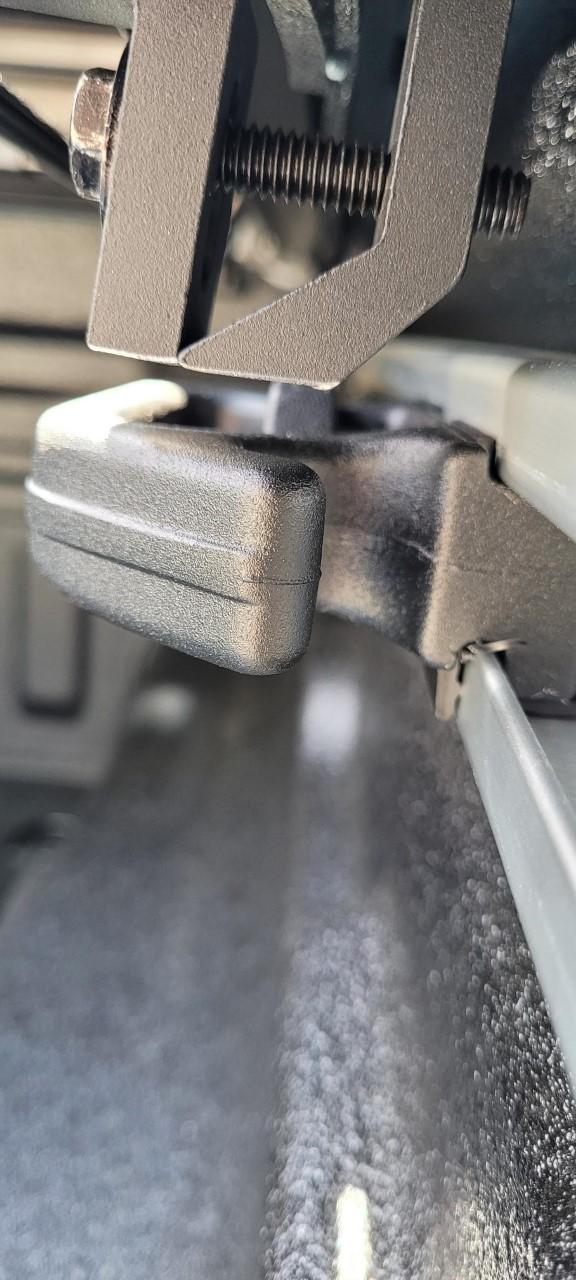

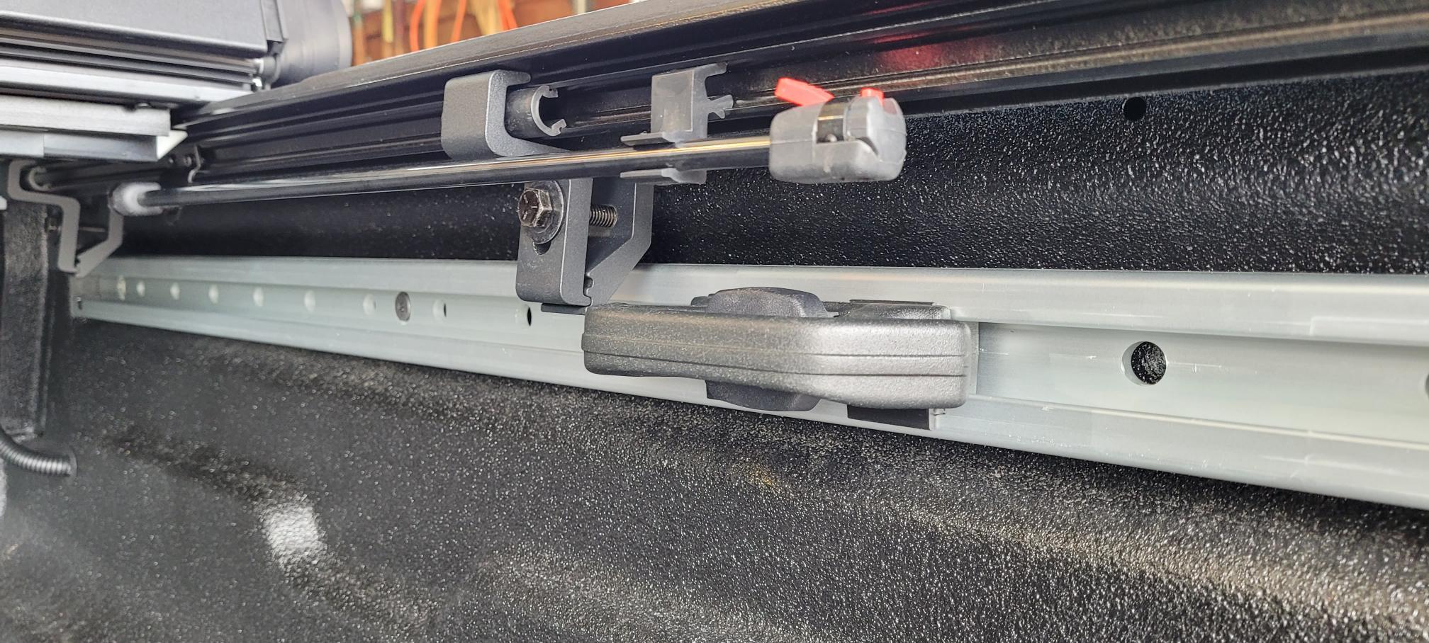

I've had 2 Mavericks with each one of these 2 covers. Of the 2, I preferred the UnderCover as the top alum panels have a SIBL coating (Linux type) so it would be a bit more durable (scuff resistant) versus the painted MX4. The MX 4 will butt up against the back window glass, but it has foam blocks to protect the finish and serves as a stand-off to the truck body. Another difference is that the MX4 clamps on each side are much smaller than the UnderCover overkill large clamps. This can show up if you have the Ford bed rail system as interference in the center clamp not allowing the bed rail slide clamp to be fully adjustable in the rail front-to-back travel position. The option around that would be some additional aftermarket tie-down clamps. Etsy has some 3D-printed ones available. You may have to cut/notch the bottom of the center clamp like I did. As to water intrusion, just make sure the installer will add plenty of seam sealing material all around the mating surfaces. Neither will be 100% water-proof. Add a gasket kit to the rear tailgate as there is typically a lot of clearance there.
Ford Maverick BakFlip MX4 or Undercover Armor Flex Tonneau? Undercover ArmorFlex Interference, v1
Ford Maverick BakFlip MX4 or Undercover Armor Flex Tonneau? Middle Clamp Revised, RT side 2
