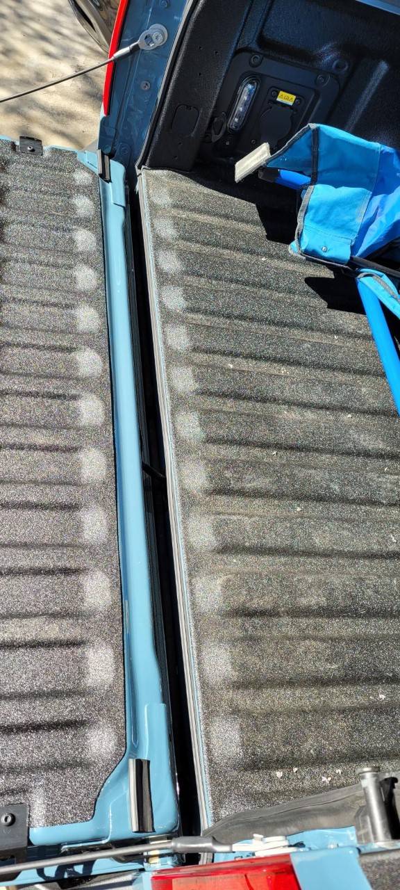

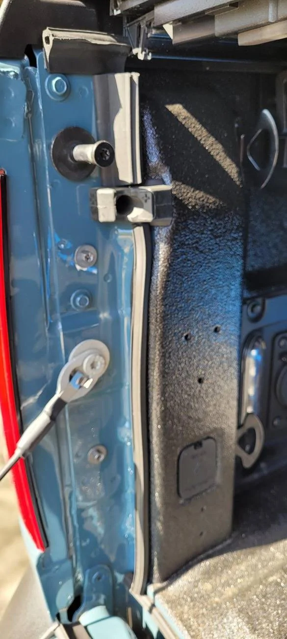

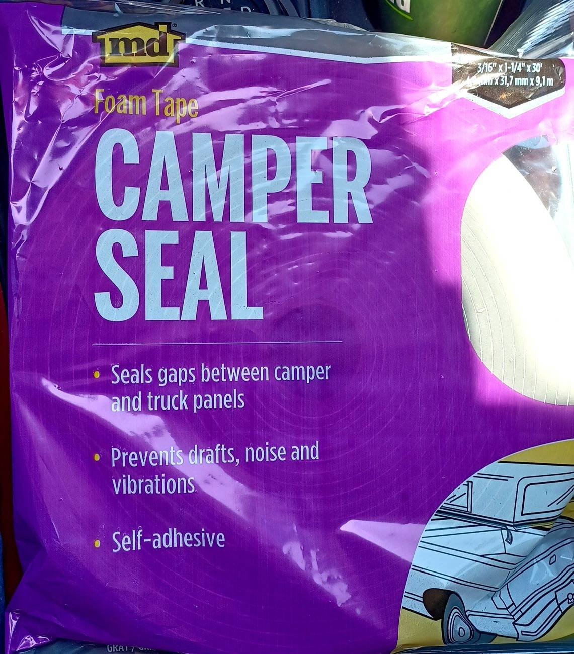

I had one on my previous Maverick. I liked it, but it also let in some water, just like the Bak hardcover on my current Maverick. The best way to mitigate this is to ensure full coverage of areas around the back window, then down about 1ft along the sides, and make sure you fill the factory seam. I'm assuming you got the 2 drain tubes installed right.
Then get a tailgate kit with large seals and install up box sides. See attached pics on my 1st Mav.
You may want to see if you can nudge the mount clamps down a bit to help get the cover to seat tightly. Good luck!
Ford Maverick Undercover armor tonneau cover water issues Cover Sealing, Bottom side
Ford Maverick Undercover armor tonneau cover water issues Cover Sealing, RH side
Ford Maverick Undercover armor tonneau cover water issues Cover Sealing, LH sid
