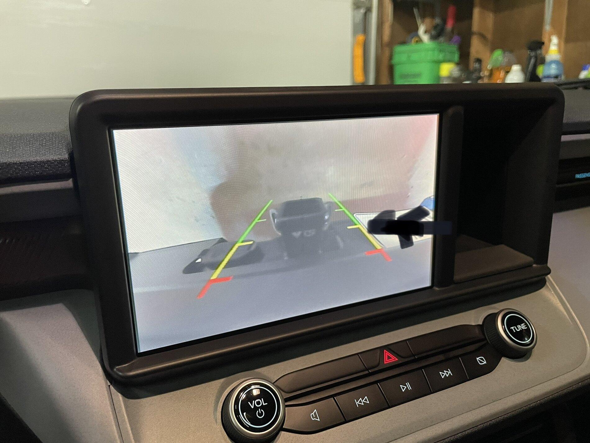

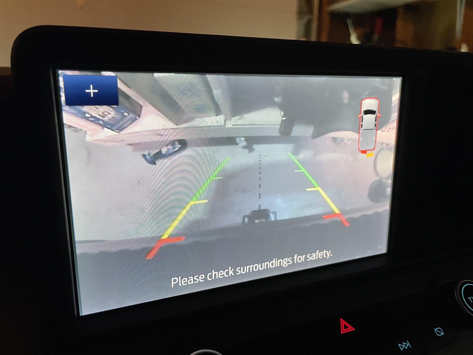

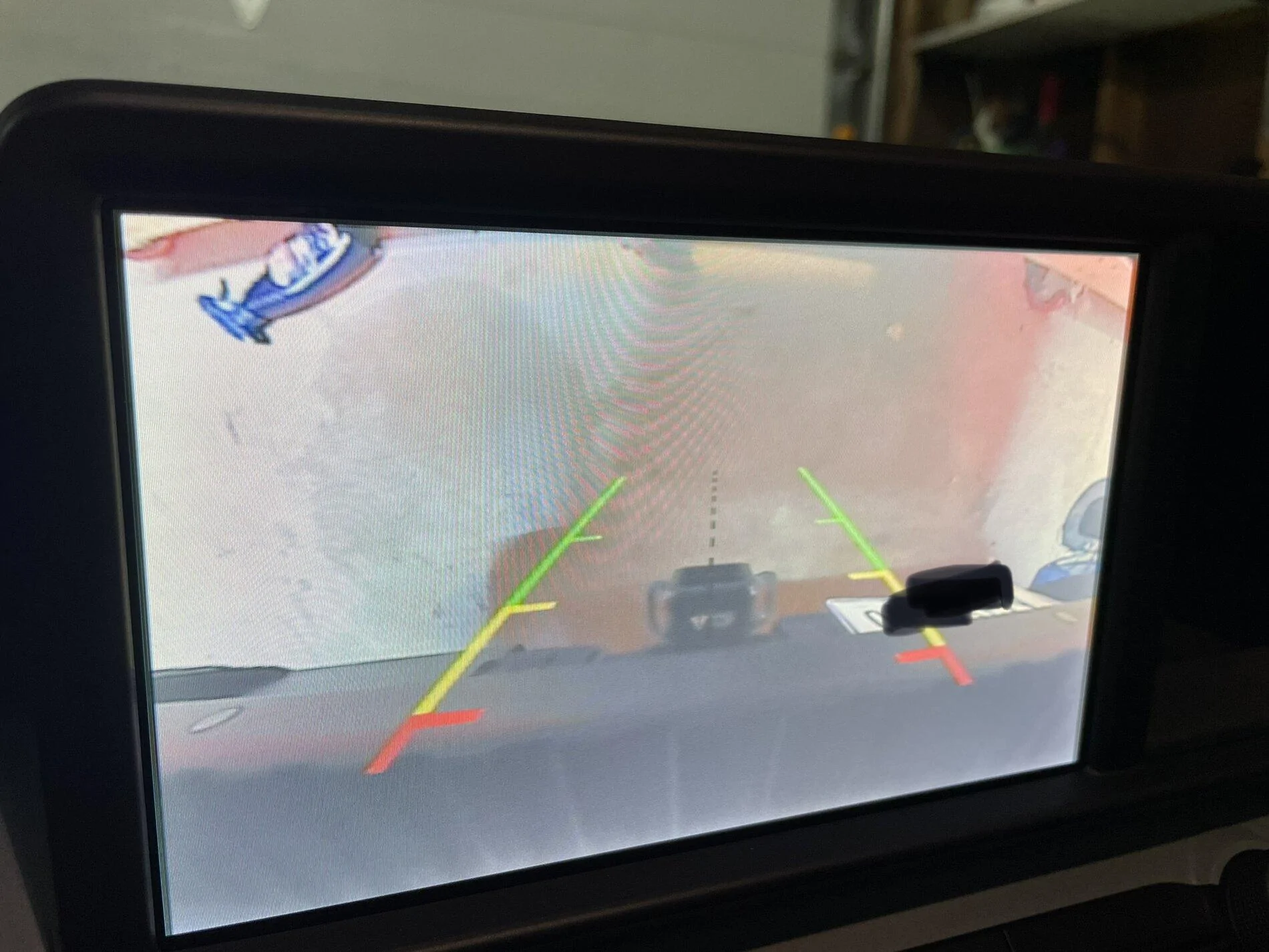

What about those other positions that the tailgate can be in.
View with the tailgate in the 4'x8' plywood position?
View with the tailgate in the partial open position (4'x8' position but cord wrapped around lower post)?
Here are the three positions.
Ford Maverick Backup Camera/Tailgate Down Fully Down
Ford Maverick Backup Camera/Tailgate Down Plywood Position
Ford Maverick Backup Camera/Tailgate Down Plywood + Post Wra

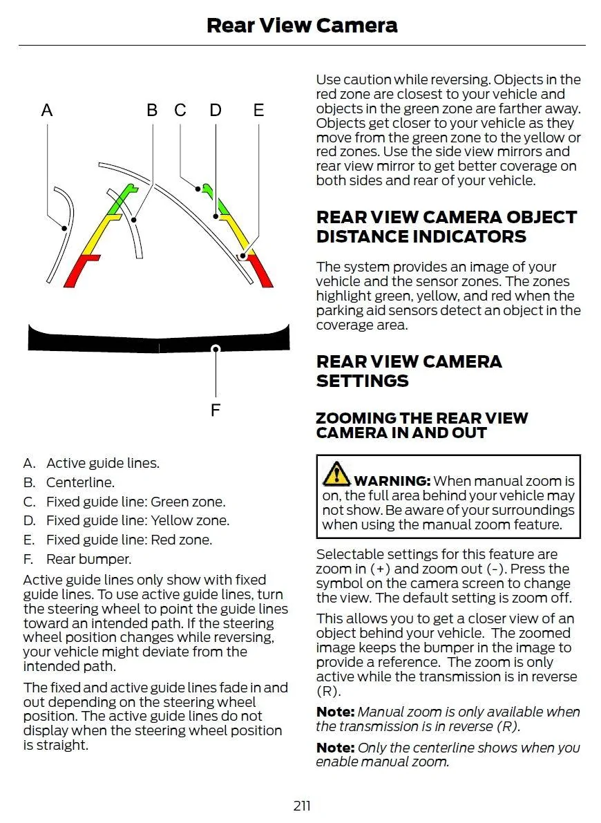

I was think a second camera in the third brake light that could be selected or come on when the tailgate was lowered. If there are large items extending out of the bed you would have a good view.
Wouldn't that view be mostly of the bed?
Mounting it there would also mess up the guide lines and distance indicators.

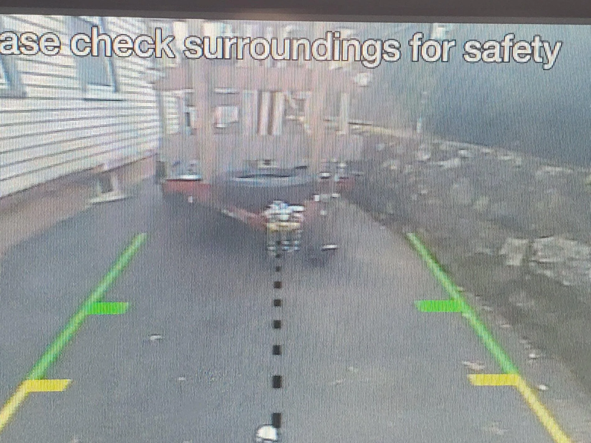

I mean depending on your trailer type and clearance to the tailgate, the camera in that position could help you line up your ball hitch a bit better.. Silver lining I guess.
With a hitch installed in the receiver, the back-up camera recognizes it and adds a dashed line down the center between the two outer back-up guides. Using that, I connect to my trailer ball exactly every time.
Here is what it looks like backing up to my trailer.
