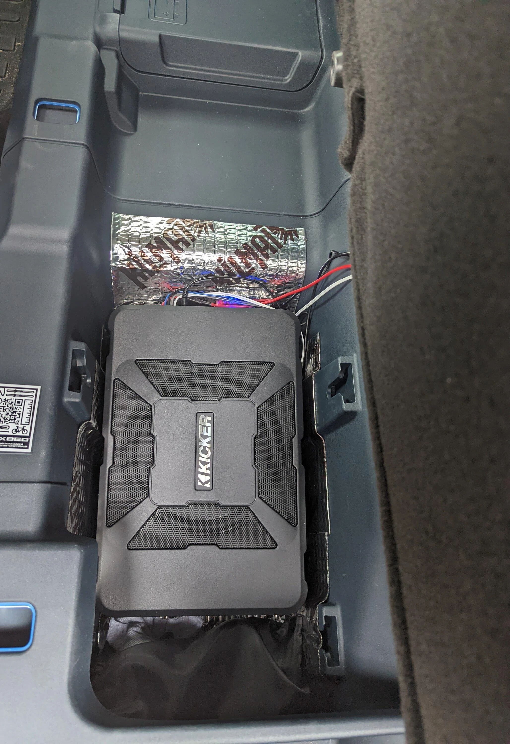

The self powered skinny subs are underwhelming (but more than enough for some, maybe most), but it’s possible (difficult but possible) to fit a custom box with 2 10s behind the seat
That's what I thought until I put this Kicker hideaway in a few days ago. More than enough Bass for me, and I keep the control dial under 1/2. This is coming from my last truck with two 10" subs in a custom box and 500w amp.

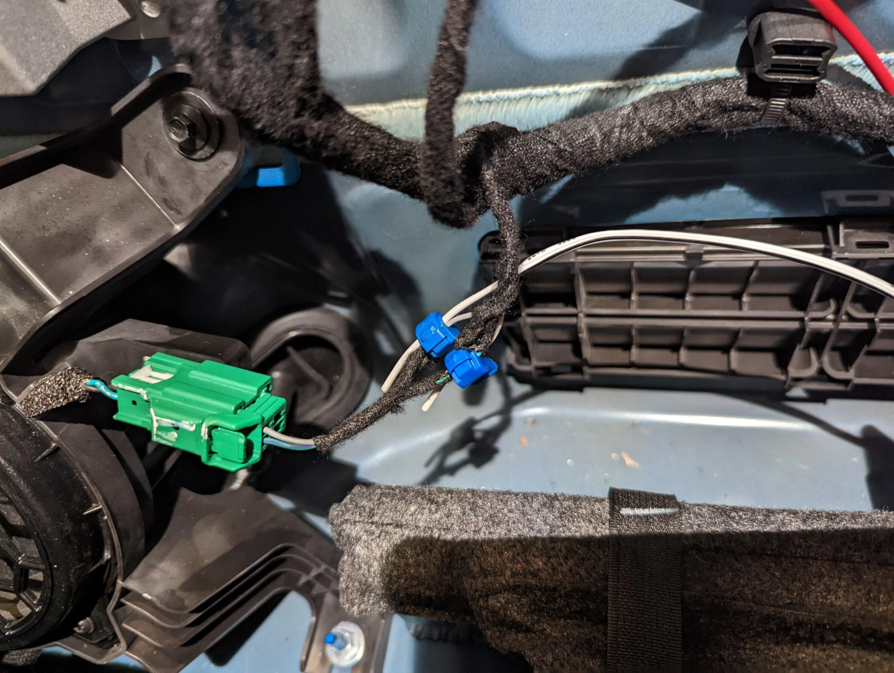

Hey, I'm thinking about adding this exact sub to my lariat lux with the B&O, but a little nervous about install and have a bunch of questions. Would you mind posting how you ran the wires? Did you tap into the existing sub lines? How did you run power and the control dial? Is it setup to turn on via a 12v hot/cold, or always connected and times out without signal? Looks great and think it will help me get the stereo right where I want it (its great, just no bass!). Also considering upgrading the center speaker in the front since it looks cheap and easy - did you do that?
Thank you for any insight and congrats on the sub!

Fairly easy, especially on the hybrid. Power to the battery under the rear seat. Tapped into the B&O sub speaker wires. Then ran the Bass control wire along the passenger side, tucking under the trim, and 3m mounted under the console.
At first I set it to power on through the speaker wires. Not good, as is it comes on when you open/close the doors and who knows when else, due to how the infotainment center power cycles a lot. So today I ran a remote wire to my fuse panel in the passenger footwell, I just tied into my dash cam wiring(ACC Fuse 2.)
I did install a center speaker last night, because I had some JBL 3022's that I didn't put in my Mustang.
The kicker is on sale for $254, I got an Open Box,unused, at Bestbuy for $165.
