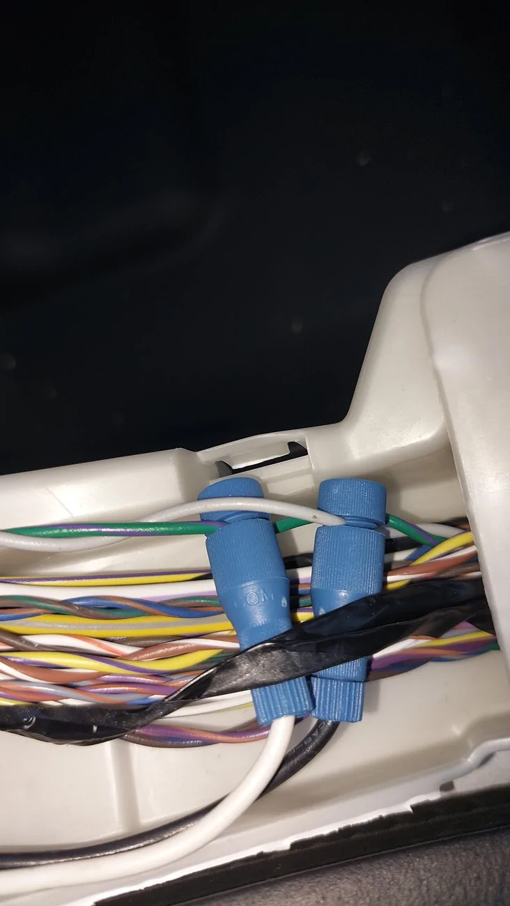

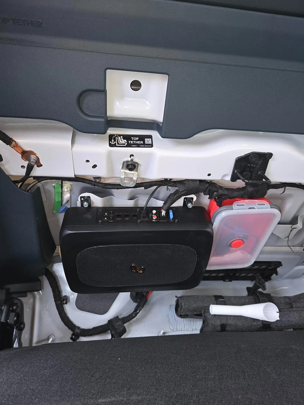

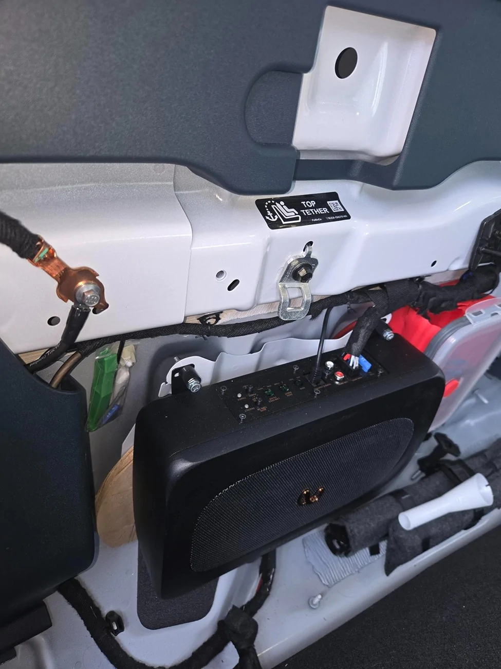

-I put a Infinity Basslink Mini in behind the back seat using the empty bracket (as no BO system) (see pic)
-Tapped into rear speaker line. (see pic)

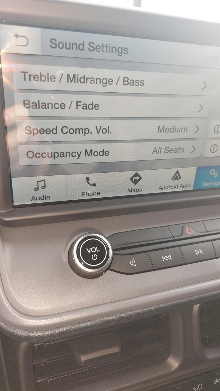

-I had only trick issue had to undo Occupancy mode setting back to default "All Seats" the amp would not produce sound until back to default all seats. (see pic)

if you have access to forscan try setting the rear speaker type to tweeter/subwoofer it should make it make sound back there
