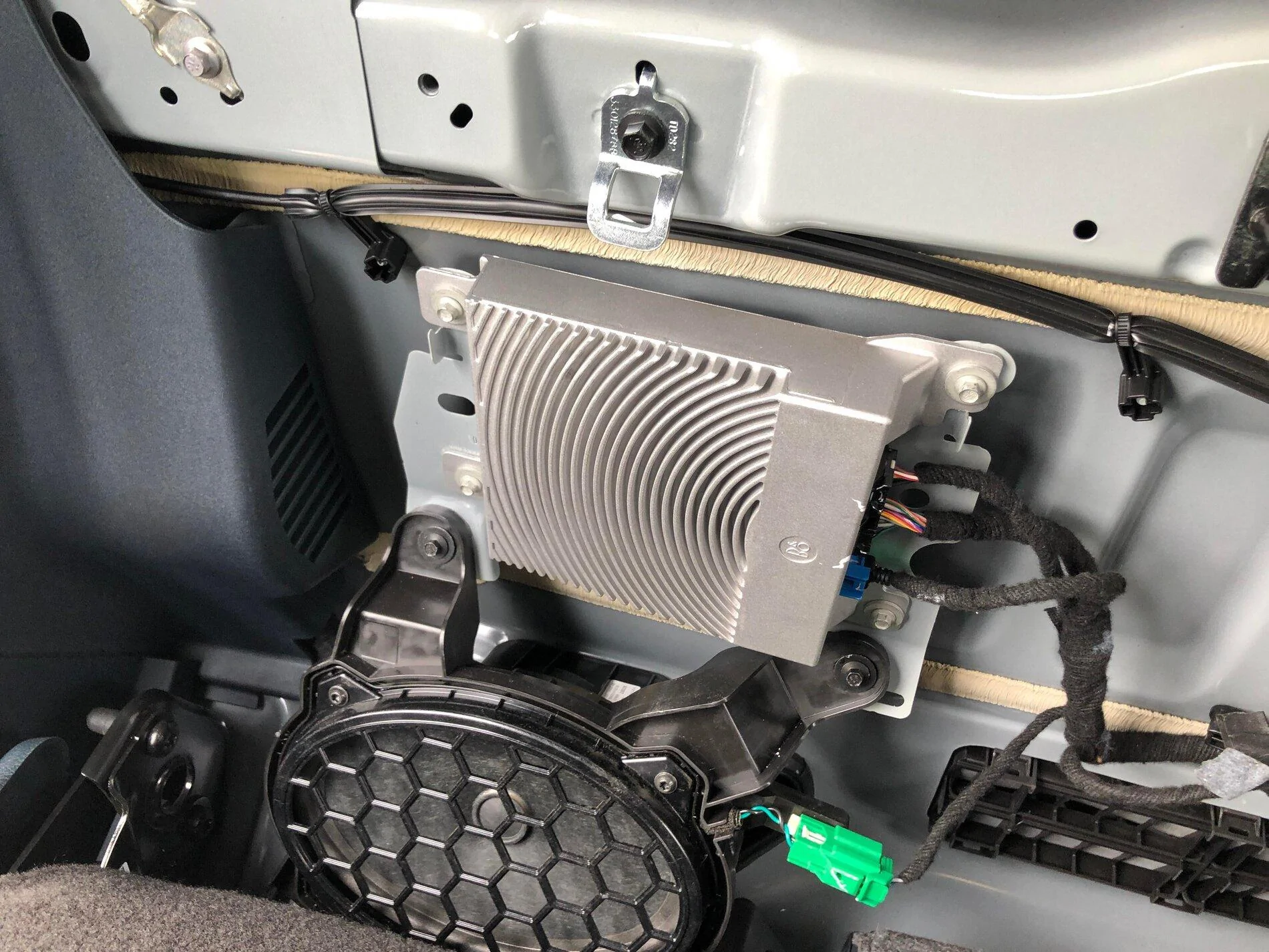

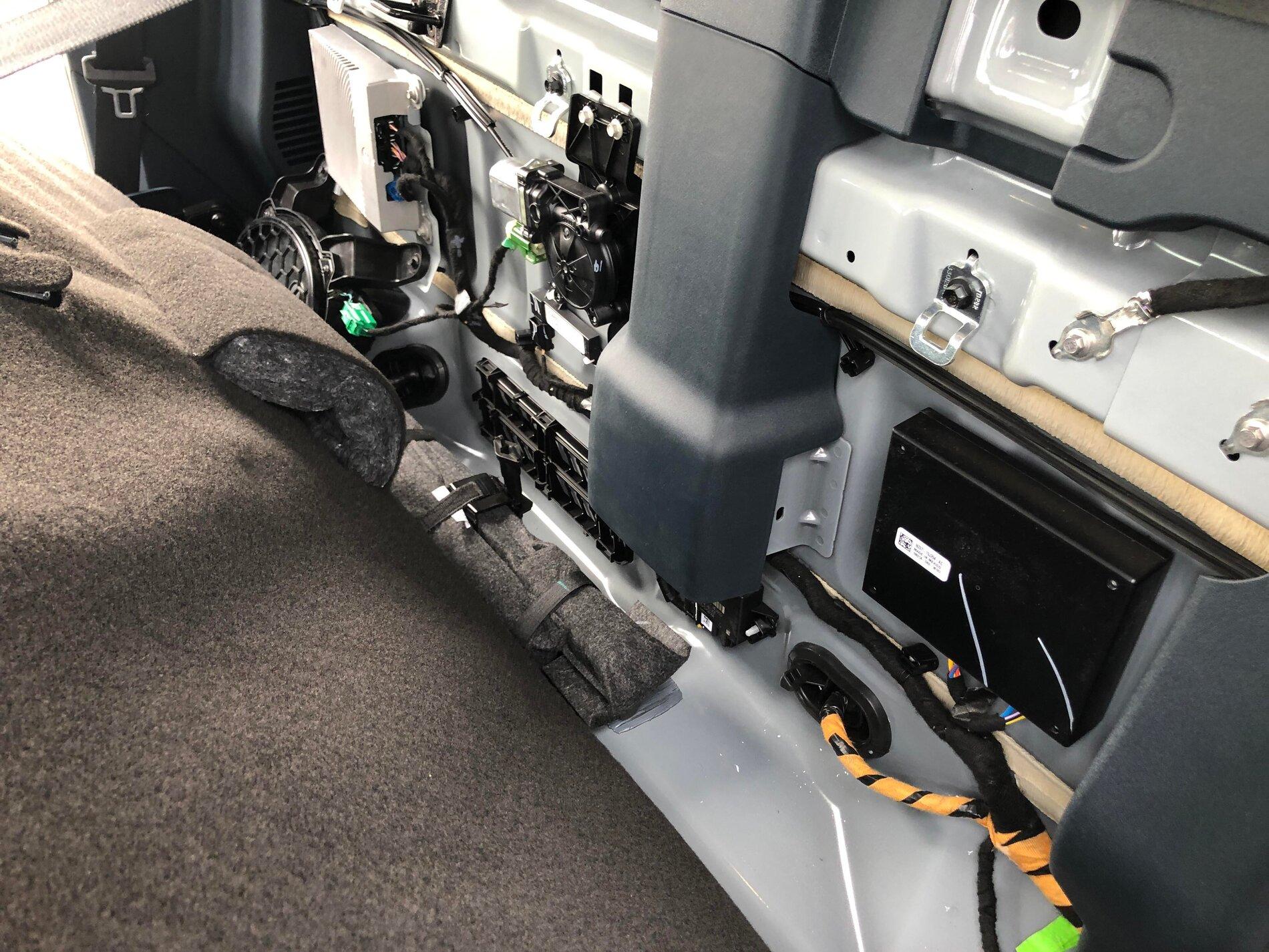

Best look I've seen of the B&O amp and sub located behind the rear bench seat.

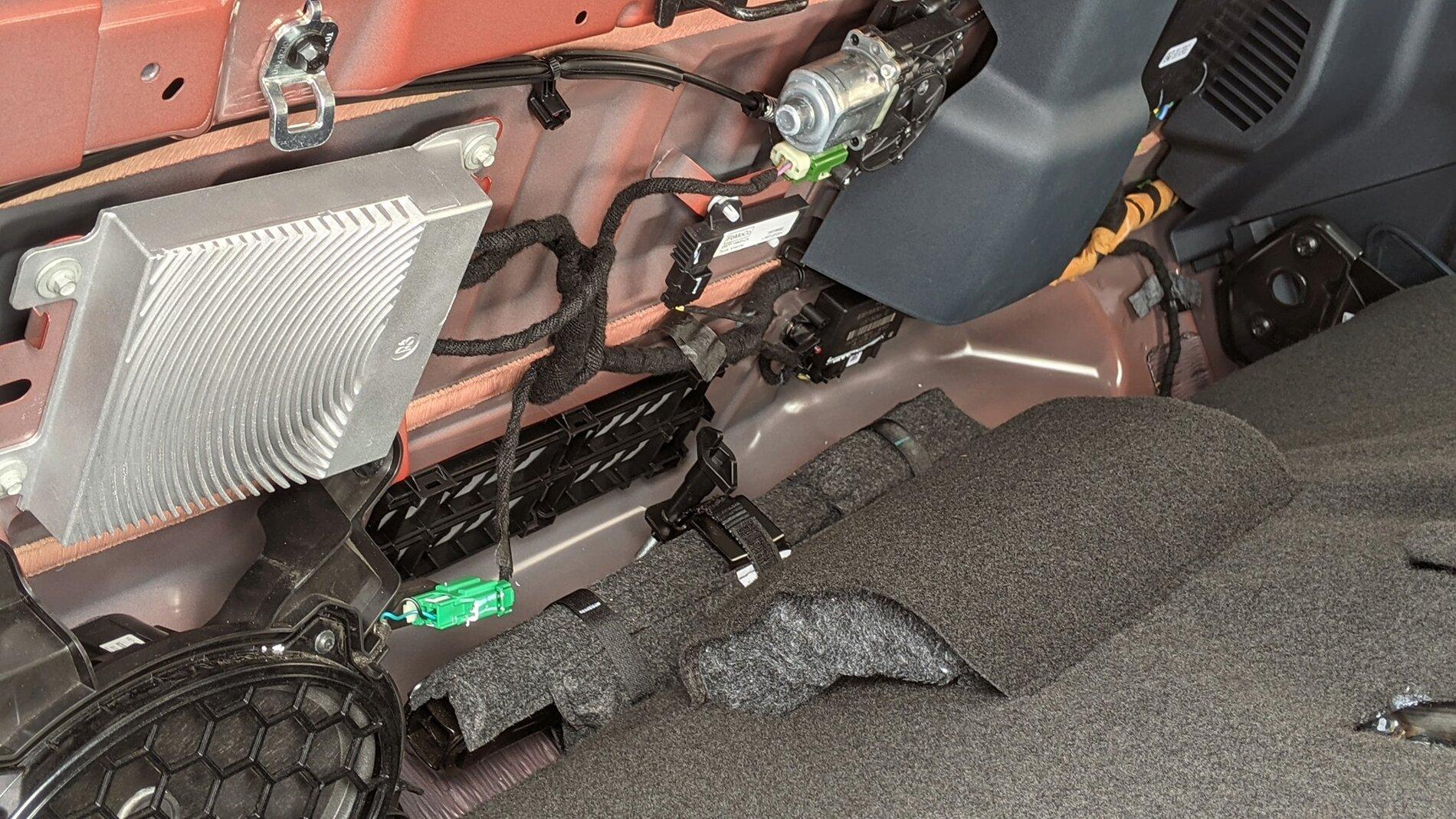

Ford Maverick B&O amp and subwoofer behind passenger rear seat [clear pic] tweeter-driver
Ford Maverick B&O amp and subwoofer behind passenger rear seat [clear pic] tweeter-passenger
