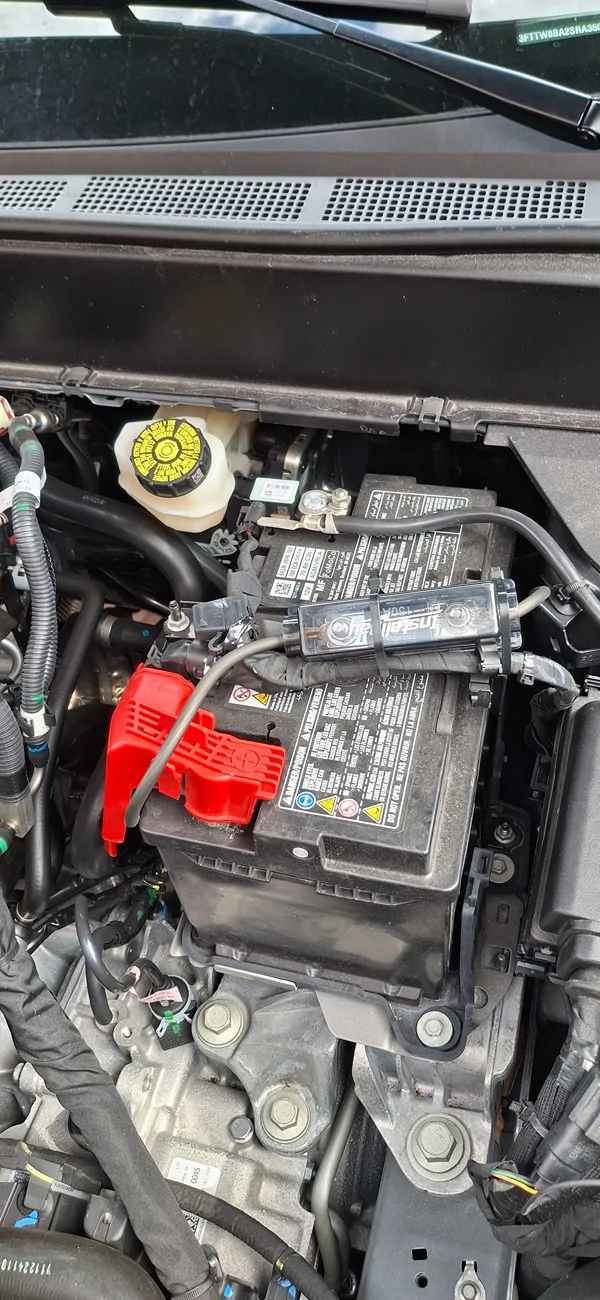

Main power to the amp is from the battery. The remote power(minimal current) is just to signal it to turn on. That’s from the ACC fuse, I had it just turning on from speaker wire signal, but it came on to often.
No install kit needed, comes with harness. You may need some small gauge wire to run to the remote power, I don’t remember how long it was on the harness as I cut it off. And a nut to thread onto the battery post.

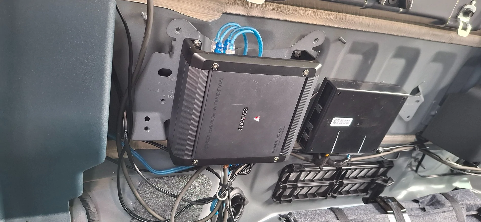

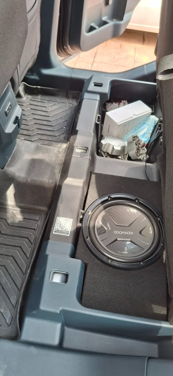

I caved and had the local shop install a kenwood system on my XL. Kenwood 800W 4 channel system replacing the 2 rear speakers and adding 10 inch subwoofer under the seat on a ordered box that specificaly fits underbeath the seat. The amp is were the stock woofer goes.
NIGHT AND DAY LOVE IT!!! Worth every penny

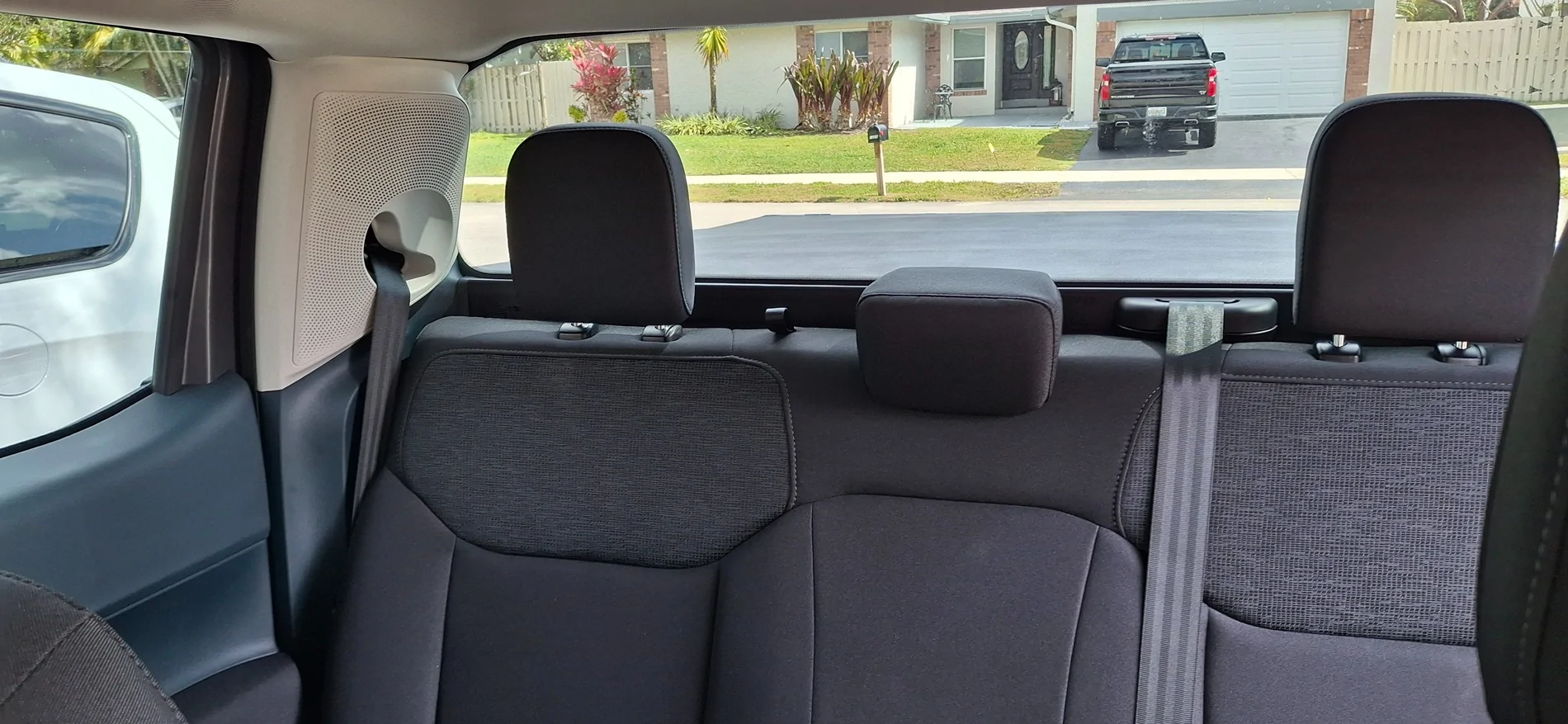

You cant see the rear speakers but they sound so much better and no signs off all the panels being tampered with. All Kenwood
