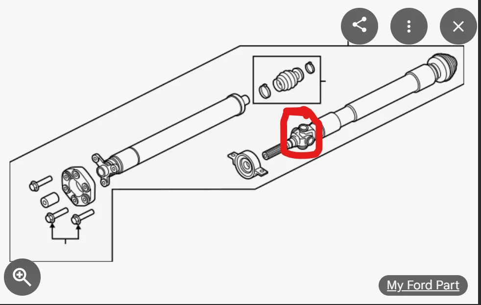

They had done the front axels first. No change in Vibration. Then the PTU, no change then the driveshaft. The U-Joints were gritty as hell. That fixed my vibration. Then 1000 miles later shes back in for the passenger half shaft.
I didn't think these drive shafts use u-joints.
