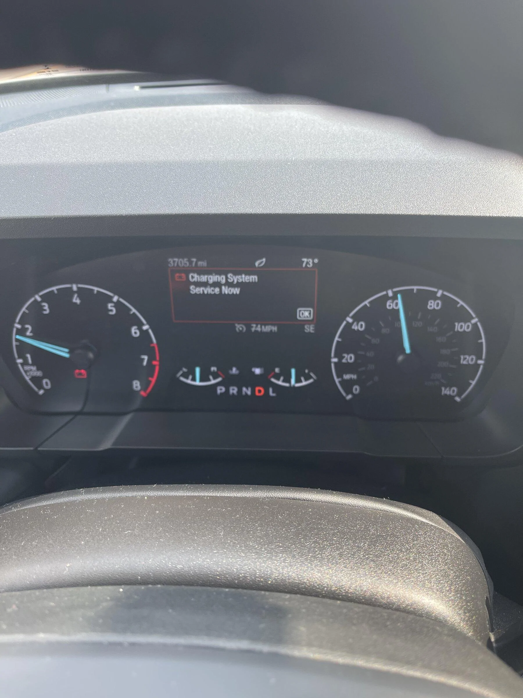

Well… I always shut this off now when I get in first thing… but today on the way home from work… scared the crap out of me! Loud alert and red warning screen! 12v charging system service now type message. It would go off finally and then battery light would go off, then come on again. It did this over five or six different times while driving home on 80/94 from work speeds of 65-80mph. Whether nothing on or all systems on. Scary! I think it has a lot to do with this: truck built and Sat from 10/15/21 until it was delivered 12/15/21 then I bought it 12/21/21… is it because the batteries might not be that great and being new and not driven or turned on it caused them to fail? Maybe the charging system sucks and affects the battery? Maybe their is parasitic drains? Anyways…. Hope a system check and battery maybe is all in order?
Ford Maverick Auto Stop/Start Not Working DEE6292F-5AC1-49EC-969F-8A694AA85894
