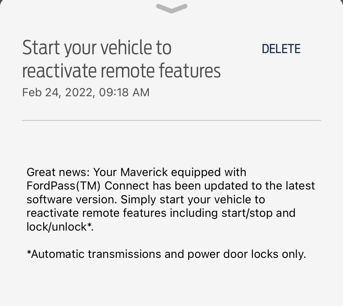

The dealership didn't have an answer for me. They said they sent the question to Ford but hadn't yet seen a response. They did ask if I unplugged my dashcam when I turn the car off. My past several cars have been Japanese/German so I'm used to the power ports only being on when the car is running. In the Maverick they are on for 10 minutes after you turn off the ignition and (I think) 10 additional minutes every time you open a door. Unplugging it has lessened the number of deep sleep notifications but they haven't completely stopped.
Side note, I got this notification a few days ago. I checked and this wasn't an update to the app but rather to the Maverick. I couldn't find any release notes.
