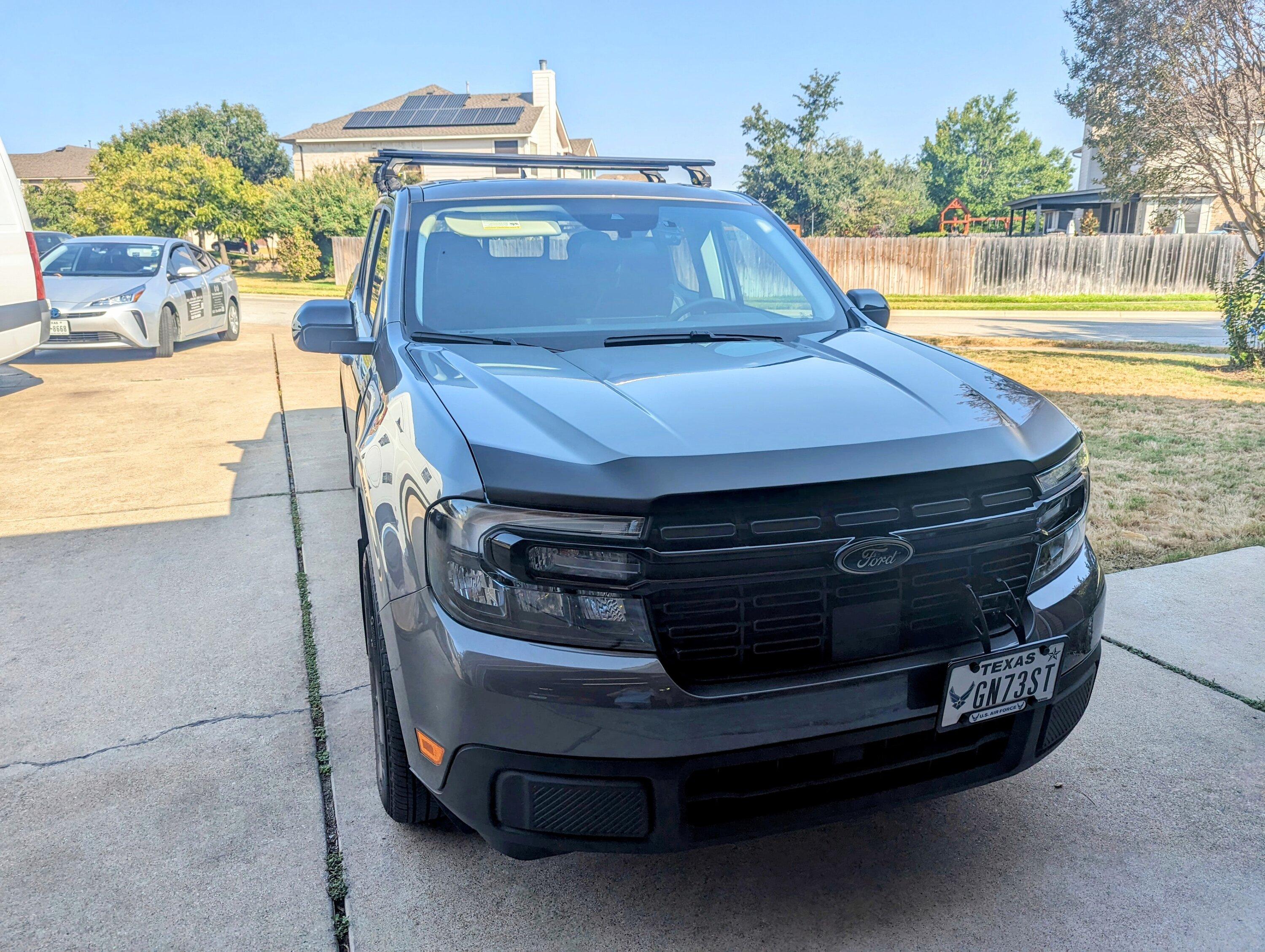

Dead 12 Volt Maverick Battery -
Had the same problem on my new 2023 Maverick Lariat Hybrid (6 months old 4500 miles). Battery was dead and no power to anything, jumped started and towed to dealer, I would not drive it. Dealer replaced the battery and reprogrammed the PCM. One week later I got deep sleep message on FordPass and low battery indicator, took it back to dealer. Dealer has checked it for the past three days and no issues found. My separate OBD tracker does a health check including the Electrical System and it came back no problems found. I am at a loss, but my confidence in the reliability of the truck is damaged. I love the truck and hopefully the problem is resolved, but I am skeptical and will monitor closely. Ford needs to look into this issue and ensure there is no systemic issue with electrical components. I also know this type of problem is not exclusive to Ford, nearly every Hybrid and Electric vehicle (even Tesla) is dependent on the 12 volt battery which looks like a weak link that can cause ongoing electrical issues.
Ford Maverick Are batteries on backorder?  Deep sleep mode Mav roof rack front PXL_20230827_144327143 Aug 27 2023
