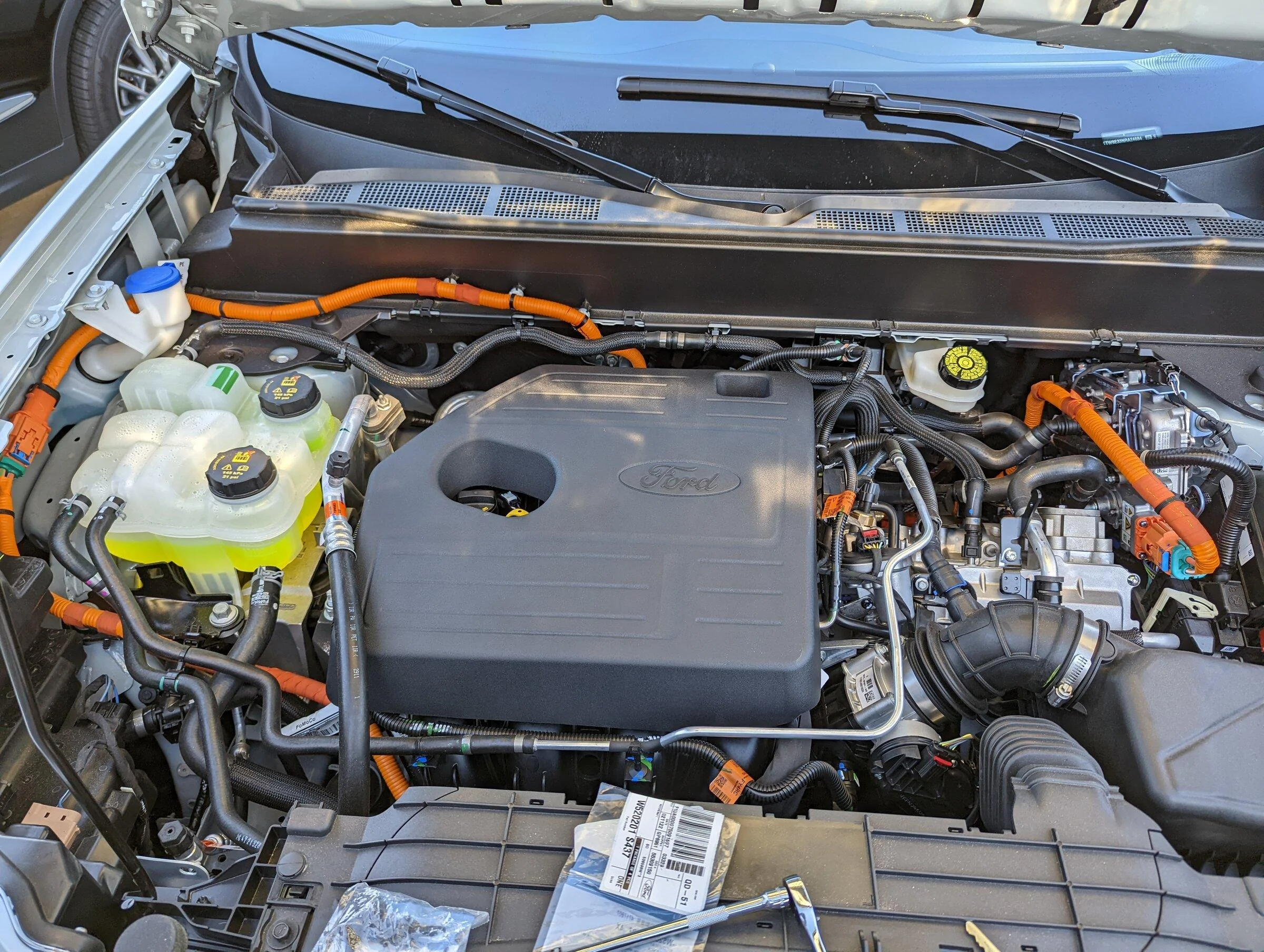

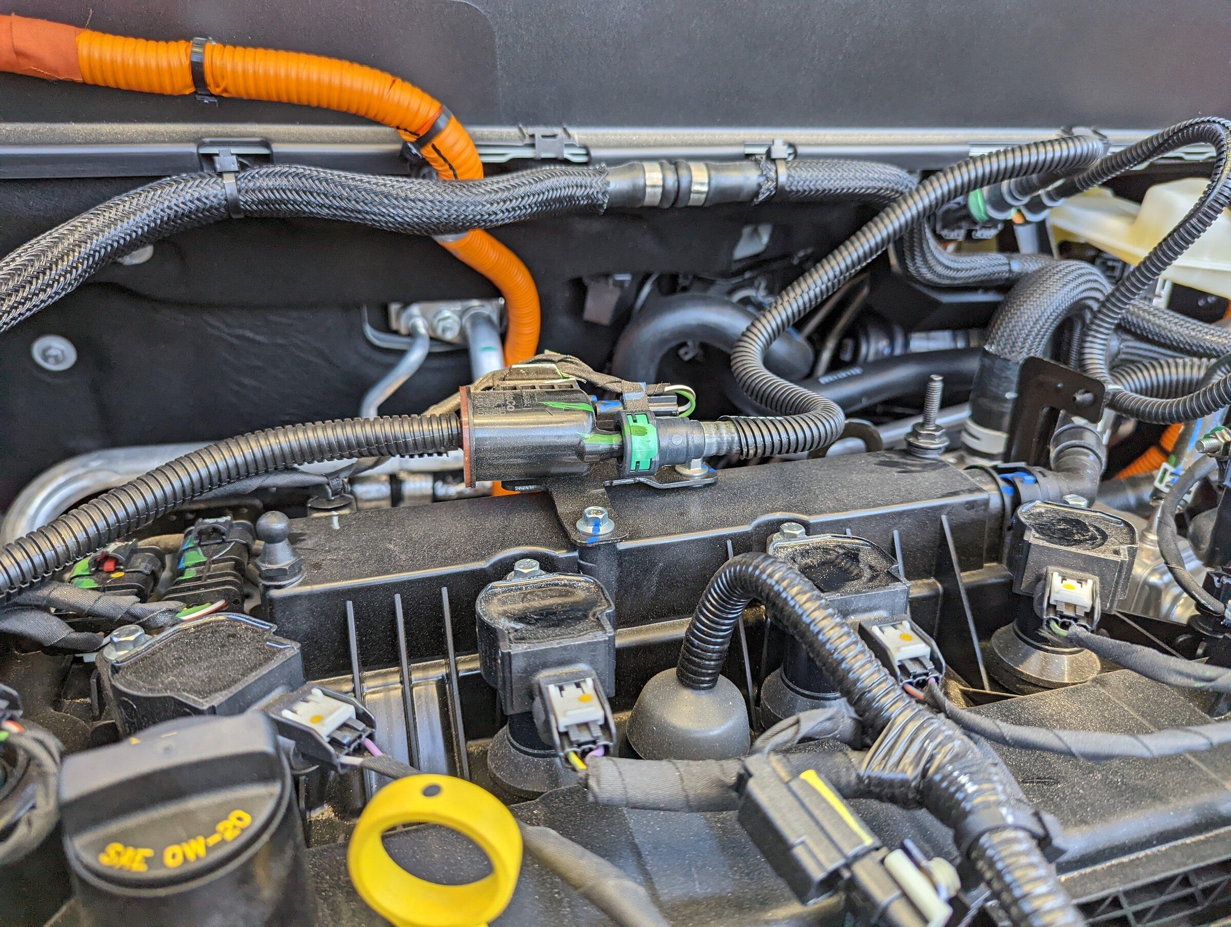

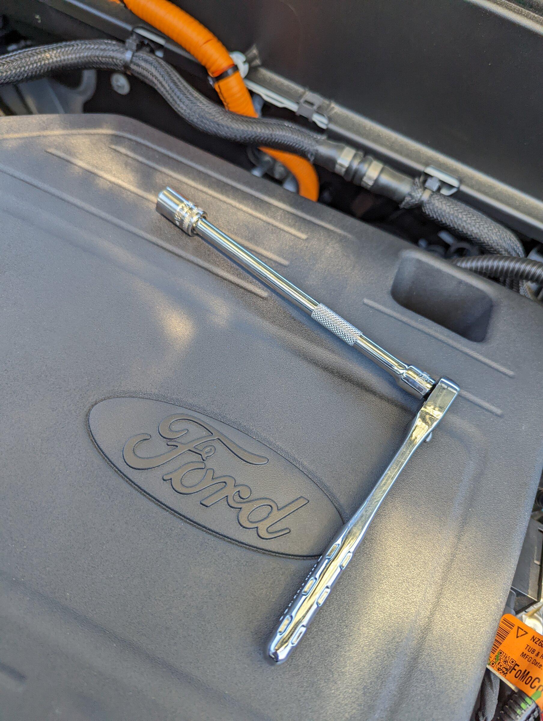

Here it is... 10 minutes of work due to busting out a 10mm socket. I ordered too many screws and nuts... Only needed one screw, one nut and one plastic ball screw.
Makes it look much cleaner. I have to wonder why Ford didn't include this on all Hybrid's. Thanks for the pics!
Deleted member 5597
Guest
So, is your engine quieter now?

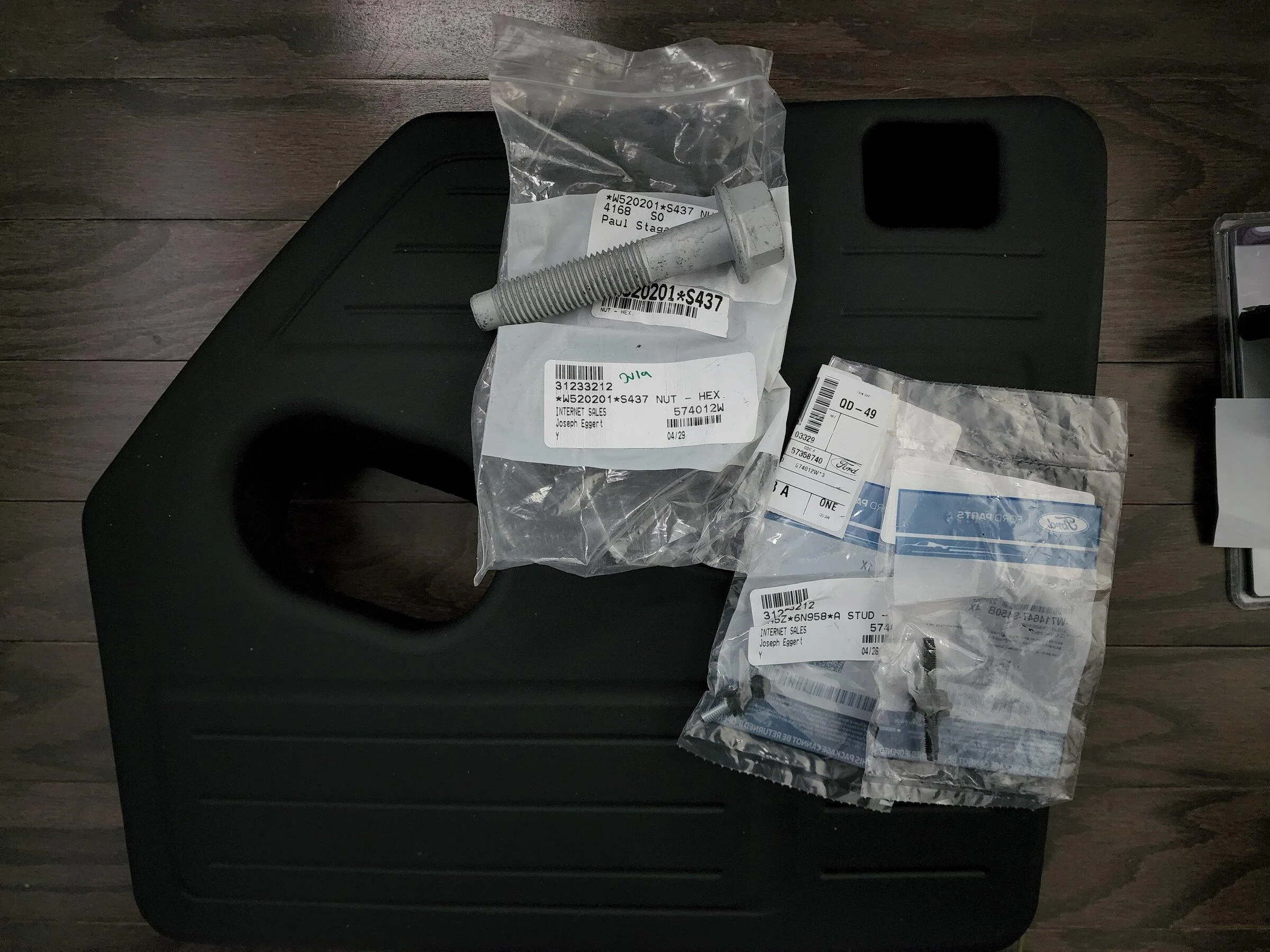

C-6 Corvette
Would you be kind enough to share the needed parts list?
Thanks!
Thanks!
Part Number​
Part Name​
Price​
Quantity​
Total​
LX6Z-6A949-B​
Cover​
$74.47​
1​
$74.47​
-W714647-S450B​
Engine Cover Stud​
$2.20​
4​
$8.80​
-W520201-S437​
Lift-Gate Finish Panel Nut​
$1.57​
4​
$6.28​
AA5Z-6N958-A​
Engine Cover Stud​
$10.67​
1​
$10.67​
Don't forget just order 1 of each. that looks to save you a little like 10 bucks. This is from Tasca. You may find it cheaper but I didn't.
