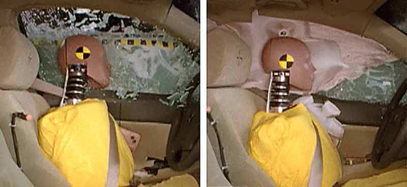

More useful info taken from this IIHS page. Appears that the side curtain airbags on the Mavericks in question would not be stiff enough to maintain displacement below 4 inches. This is of particular concern in a rollover with broken side window panes.
Side airbags
Head- and chest-protecting side airbags are designed to inflate in side crashes to prevent people's heads and chests from contacting intruding parts of vehicle side structure, a striking vehicle or an object such as a tree or pole. Side airbags cushion and spread the load of impacts to prevent any part of the body from sustaining concentrated impact forces.
A head-protecting side airbag is particularly important because it may be the only thing between the occupant's head and the striking vehicle, since window glass can shatter in a crash.
Because of the small space between an occupant and the side of the vehicle, side airbags must deploy very quickly, typically within the first 10-20 milliseconds of a side crash. Deployment thresholds can be as low as 8 mph for narrow object crashes (e.g., trees and poles) and 18 mph for the more widely distributed side impacts (vehicle-to-vehicle crashes). Side airbags also deploy in certain types of frontal crashes.
A federal regulation on side-impact protection requires a certain level of head and torso protection for all occupants. While it doesn't specifically mandate side airbags, the required protection is typically achieved with them. As of the 2014 model year, virtually all new passenger vehicles must comply with this regulation. As a result, the vast majority of passenger vehicles come with side airbags as standard equipment.
Ford Maverick Airbag recall: what's the real consequence of not having it done? ANSWERED side-airbag-comparison-screengrab
A head-protecting curtain airbag is often the only barrier between the dummy's head and the striking vehicle.

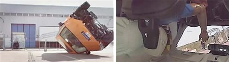

Rollover deployment of side airbags
Side curtain airbags can be designed to deploy in a rollover crash. Sensors that measure a vehicle's sideways movement and tilting can detect if a rollover is about to occur, triggering deployment. These airbags typically inflate within the first 10-20 milliseconds of a rollover crash and can remain inflated longer than regular side curtain airbags (10 or more seconds) to protect during multiple-roll crashes. They typically cover the window opening and inflate more stiffly to prevent ejection of the occupant.
The government doesn't specifically require side curtain airbags with this capability, but automakers have been using them to meet a requirement that all 2018 or newer vehicles prevent occupant ejection through side windows.
Ford Maverick Airbag recall: what's the real consequence of not having it done? ANSWERED Rollover-images
A side curtain airbag used to meet the federal safety standard to prevent occupant ejection remains inflated for more than 10 seconds, covering multiple rolls of the vehicle, and keeps occupants contained inside.
