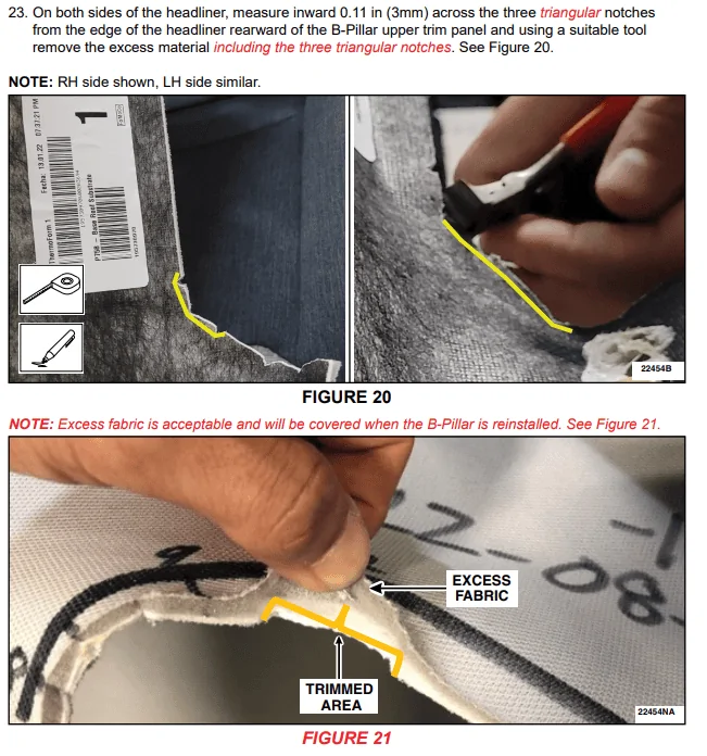

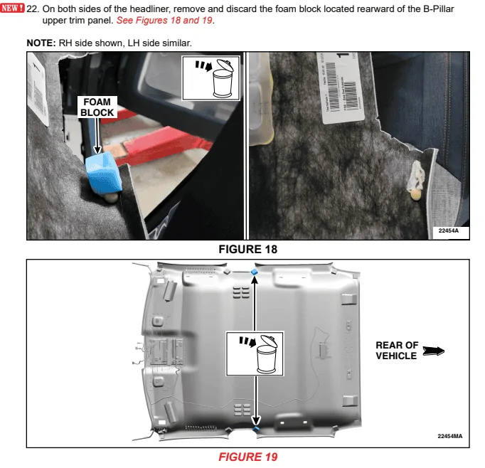

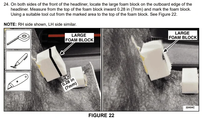

As its been mentioned in others posts - the new airbags dont always fit well against the headliner (either the bags are larger or attached too low).
I dropped my headliner before taking it to Ford. I installed it afterward (carefully) and the airbags arent letting the headliner fit properly - causing you to see the edges of the headliner when you open the doors.
Did you (or the dealer) perform the modifications required to the headliner as per the recall instructions?
can you link me the instructions to do this.
