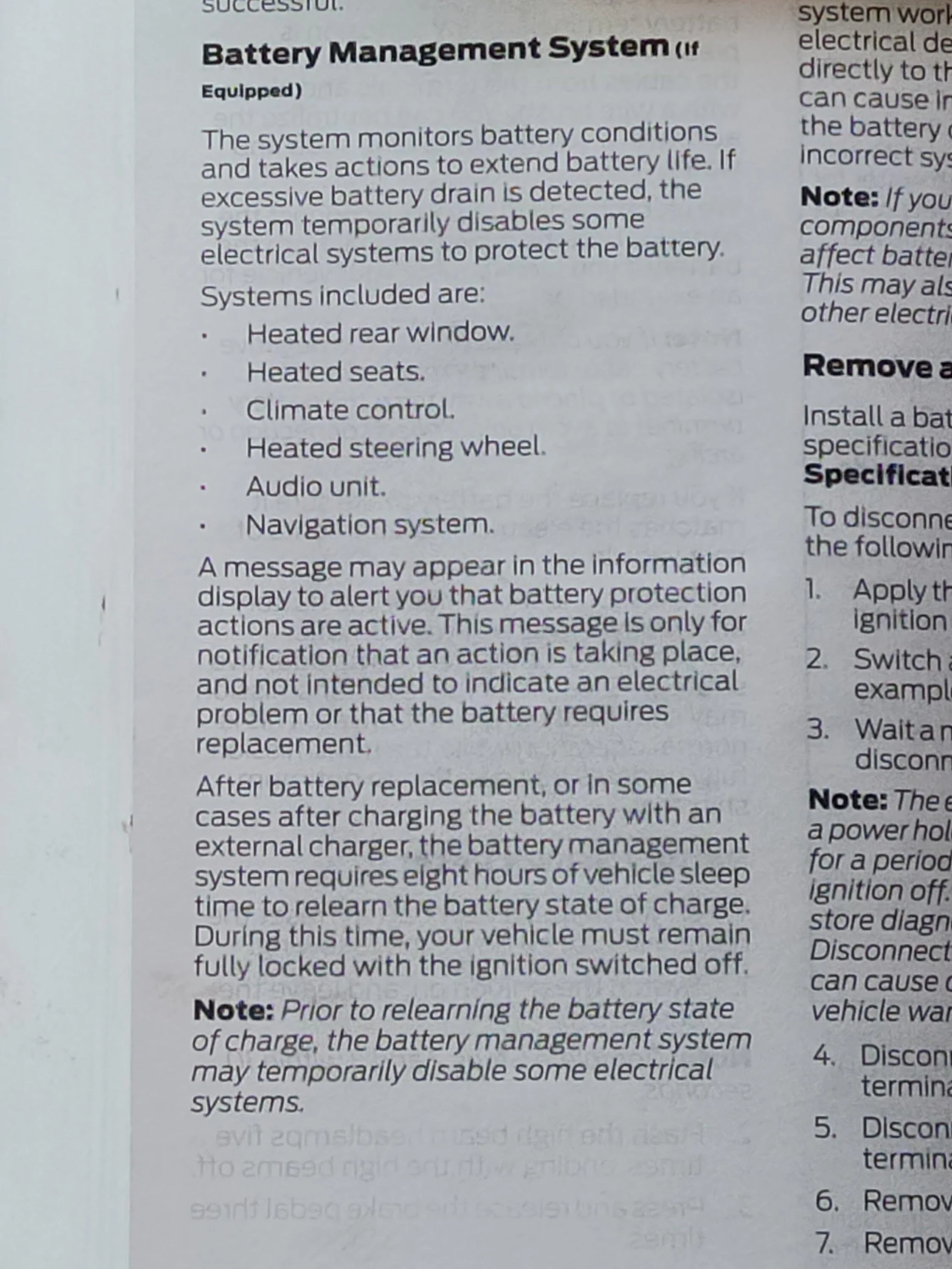

In manual (April 2022, second printing), (I have hybrid) there is an 8 hour procedure to follow (not the
Brake then flash light reset bms procedure) with all accessories off and truck locked and not disturbed for the up to 8 hours for the BMS to learn the SOC of the new battery. Look at "Battery management system (if equipped)" on page 312. Read the whole thing. It states this MAY need to be done also if battery is charged with an external charger. ALSO NOTE THAT BMS MAY DISABLE SOME ELECTRICAL SYSTEMS UNTIL IT RELEARNS THE BATTERY STATE OF CHARGE. I suspect some of the lights off or other things that keep reoccurring after a deep sleep MIGHT POSSIBLY BE CURED by following this procedure. Consider the possibility that the BMS thinks that the old not fully charged battery that could not be charged past 80% (or whatever soc) is the profile to follow. Someone at Ford did think this should possibly need to be done and put it in manual. ????

NOT THE RESET THE 8 HOUR RELEARN PROCEDURE
:rolleyes: First of all stop yelling, why are you typing in all caps, it's annoying. Second of all, my Maverick regularly sits for 1-2 weeks at a time without being driven so I think that more than accounts for the 8 hour rest period in addition to resetting the BMS.

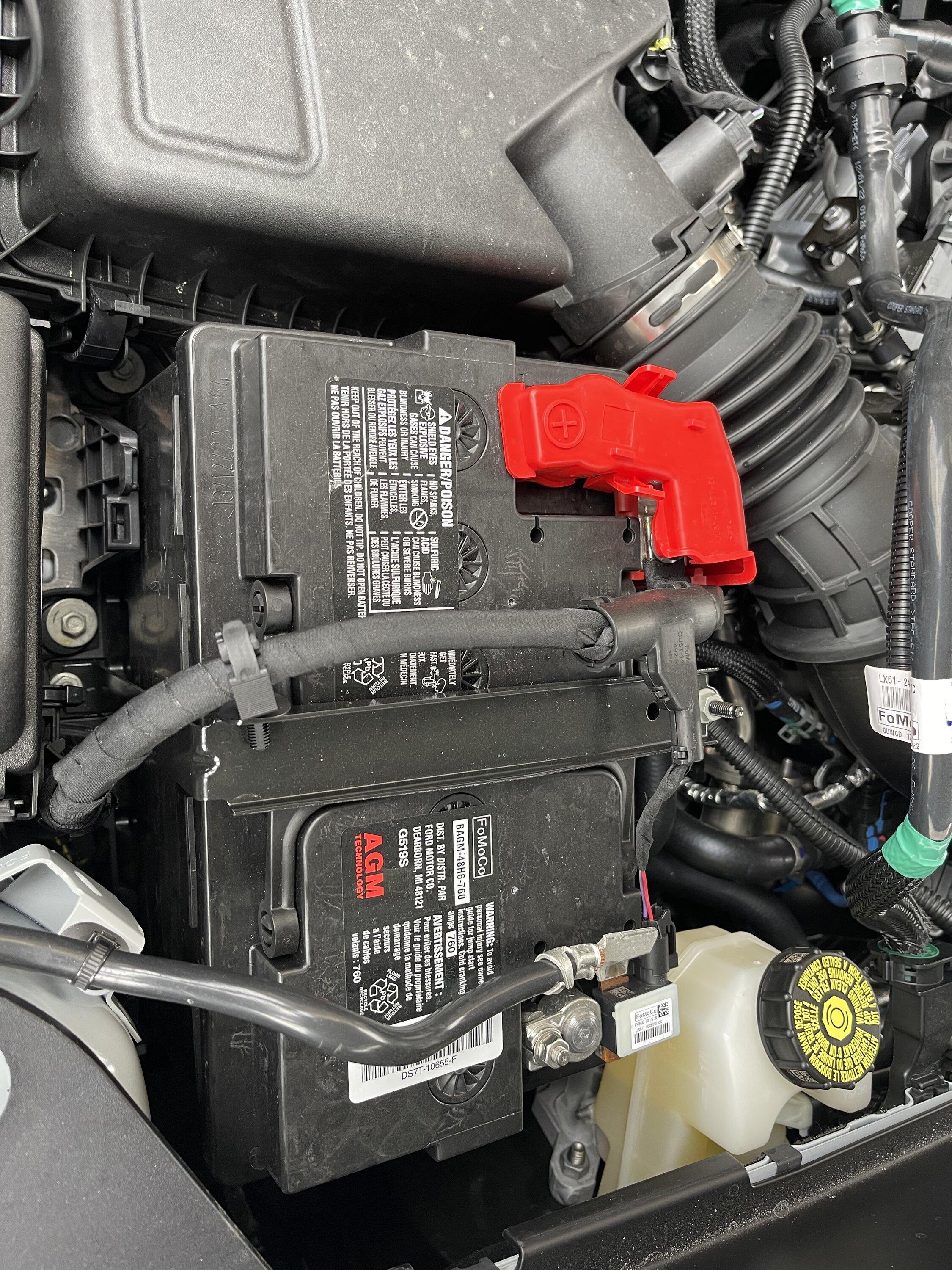

You guys might want to go look at your battery. This is my XLT Tremors battery.
Like I said in direct response to your previous post, it seems to be random and who knows what it's based on whether it's trim or package dependent but my Maverick which was produced 5/22 did not have an AGM nor did my father's which was produced 11/22. Both were shipped from the factory with an "enhanced" flooded battery

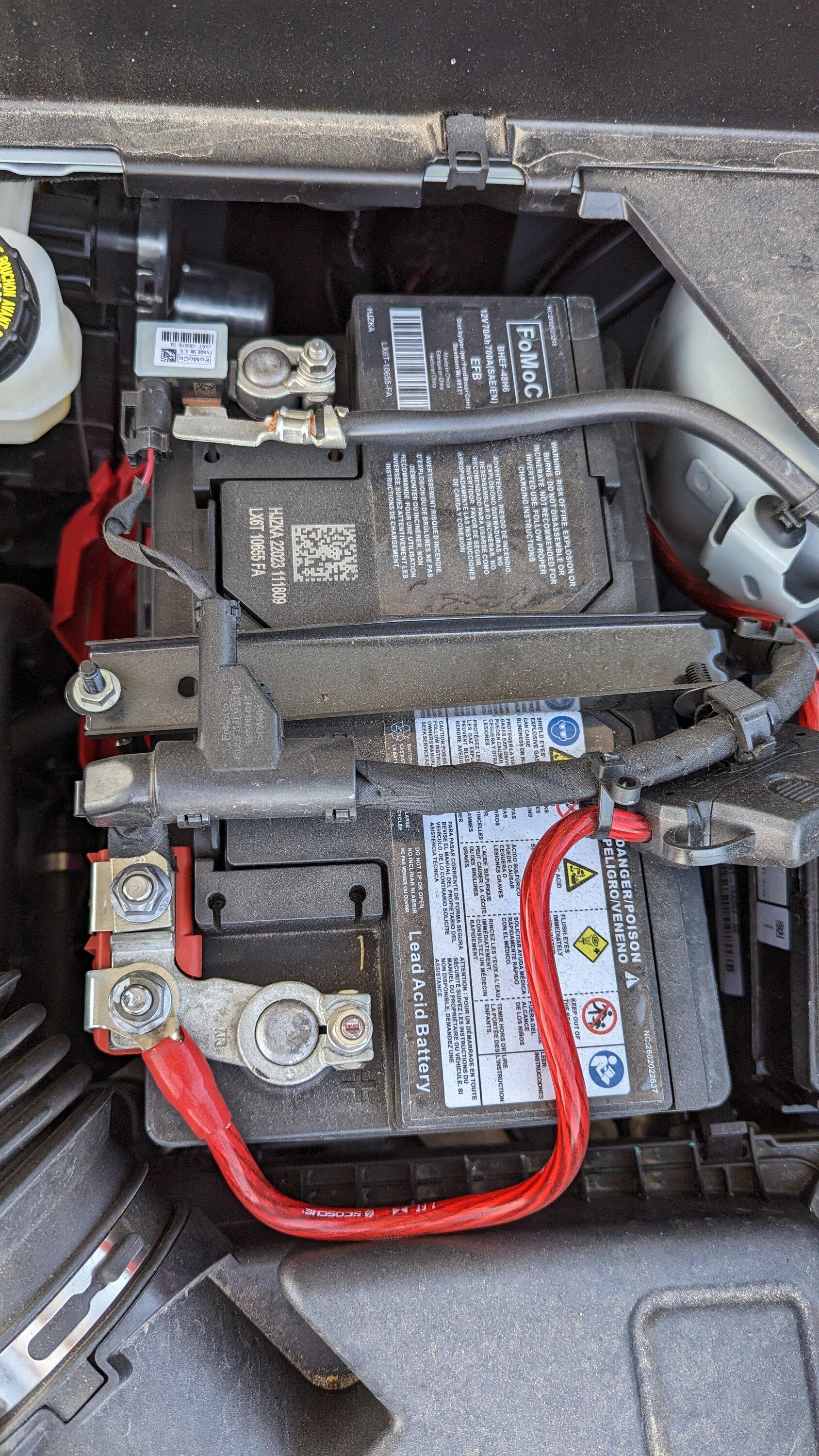

NCND and NoVaJimmy yes my stock battery is EFB. Truck was built 7/3/22. It's a lariat lux ecoboost 4K tow. Agree that there seems to be no standard. If one were a pessimist they might think that AGM should always be supplied and we're getting EFB whenever they don't have the AGM battery on hand. Who knows?
