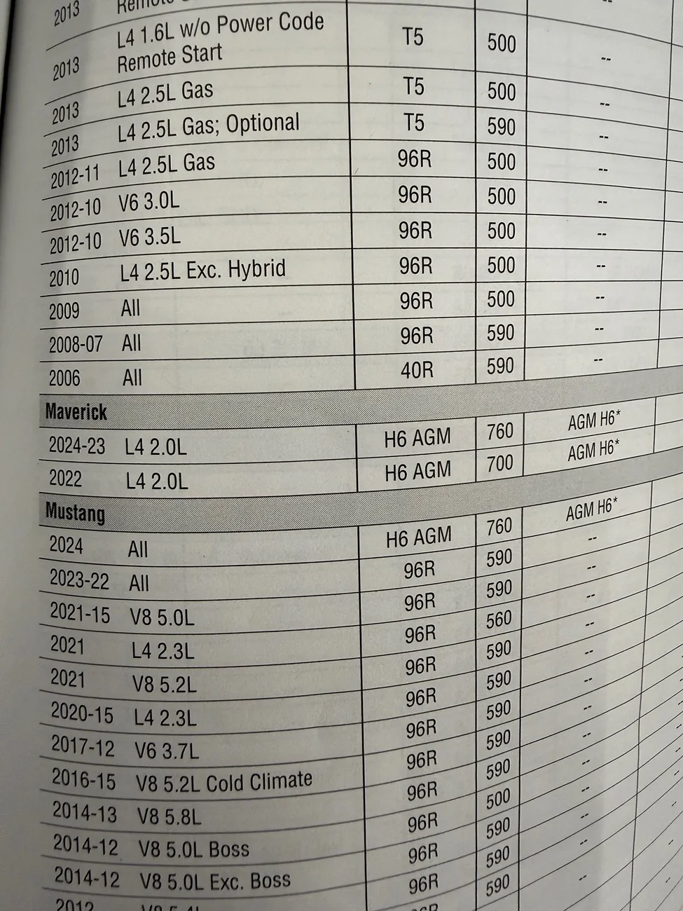

Well, as that's 2 sizes larger than spec for the hybrid mentioned - it better have better stats!

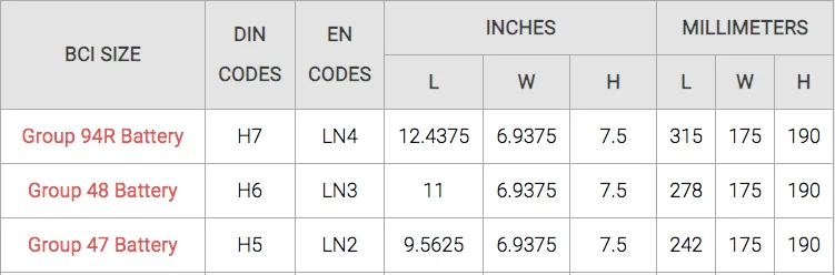

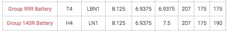

Please know that this battery will not fit in the Hybrid version. Length is too long for the under the rear seat area.
