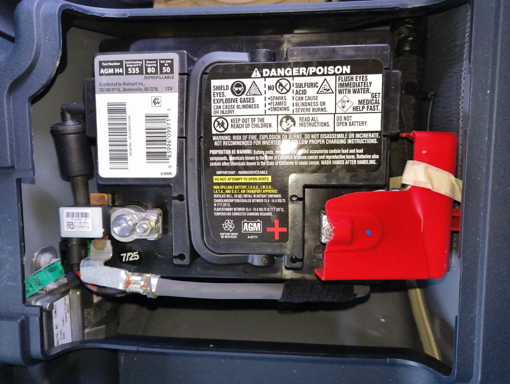

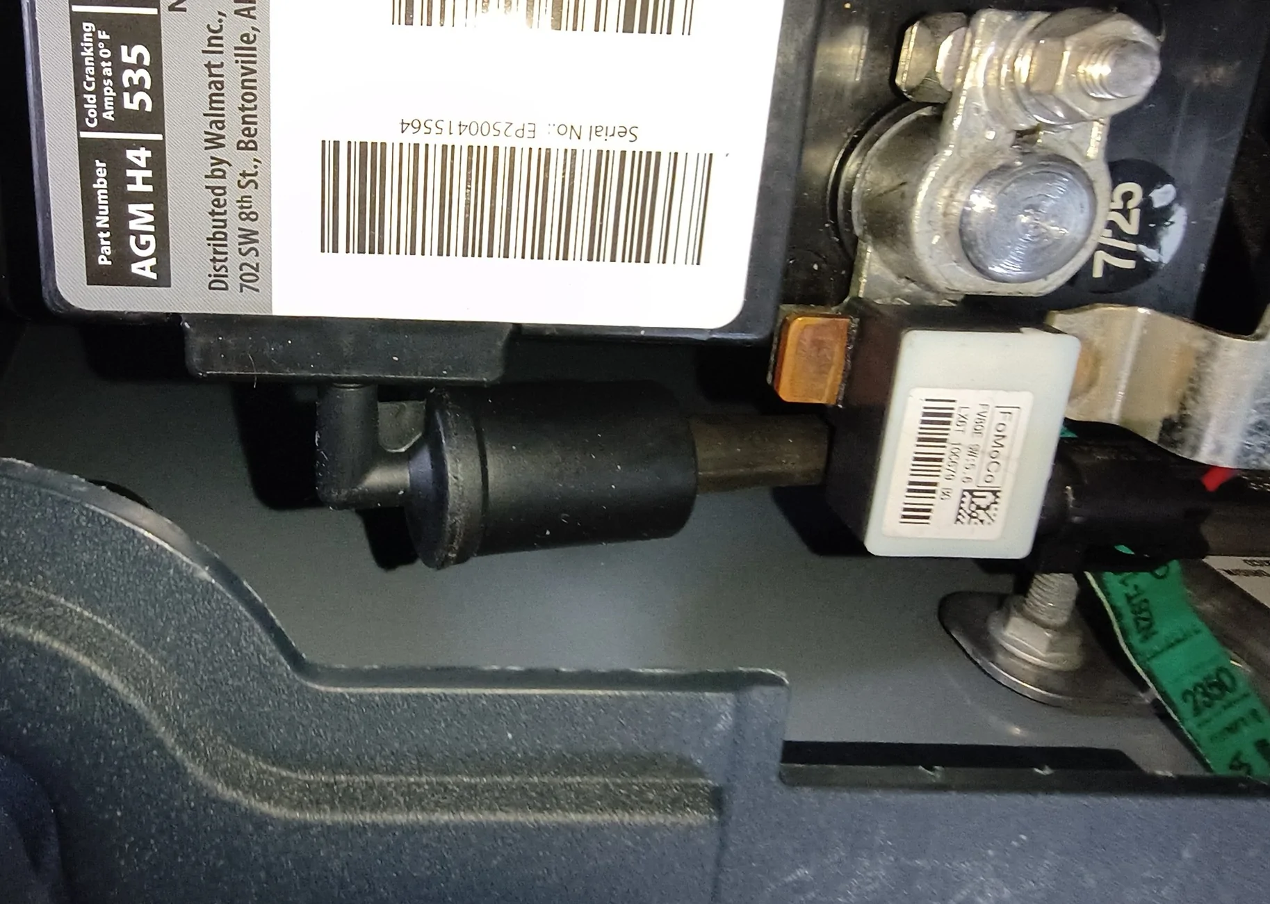

The Everlast AGM battery does not come when any new vent tubing, etc. and that raised a question from a member who was in the process of installing. Not be a problem though as I was able to install and re-use the original venting set-up (see photos). If interested, check out that separate thread. I imagine this pertains to other if not all replacement batteries for the Maverick Hybrid.
Here's photos that show the re-used original venting after my install.
