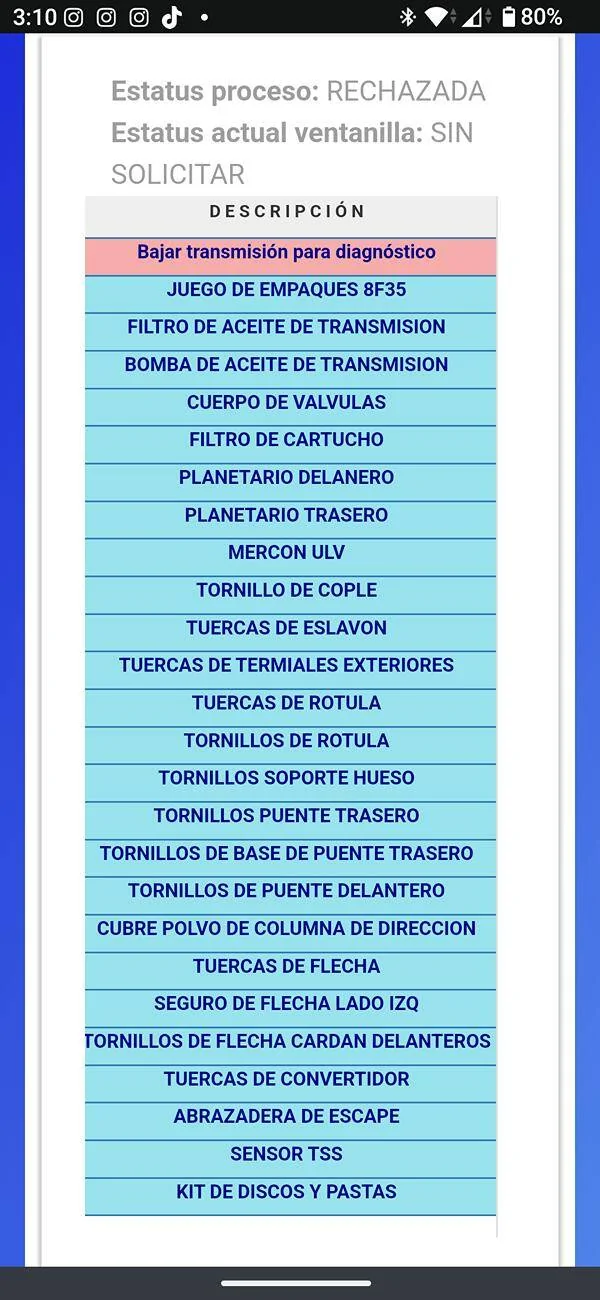

In case you're curious, here's the actual list of parts the technician found need to be replaced. Excluding hardware and seals, it lists:
Front planetary gearset
Rear planetary gearset
Internal transmission oil filter
Transmission oil cartridge
Transmission oil pump
Valve body
Transmission speed sensor
Transmission full clutches and rings replacement set

I just had a look at the technician's report. Fluid level was correct, but was completely burnt, then the technician lists the parts with excessive wear that need to be replaced.
I never towed or exceeded max payload or gross weight. I don't have the towing package as it wasn't available in Mexico at the time. Those of you with the 4K tow package you can rest easy knowing you have a trans cooler and different gearing. I will be replacing the fluid frequently from now on.
