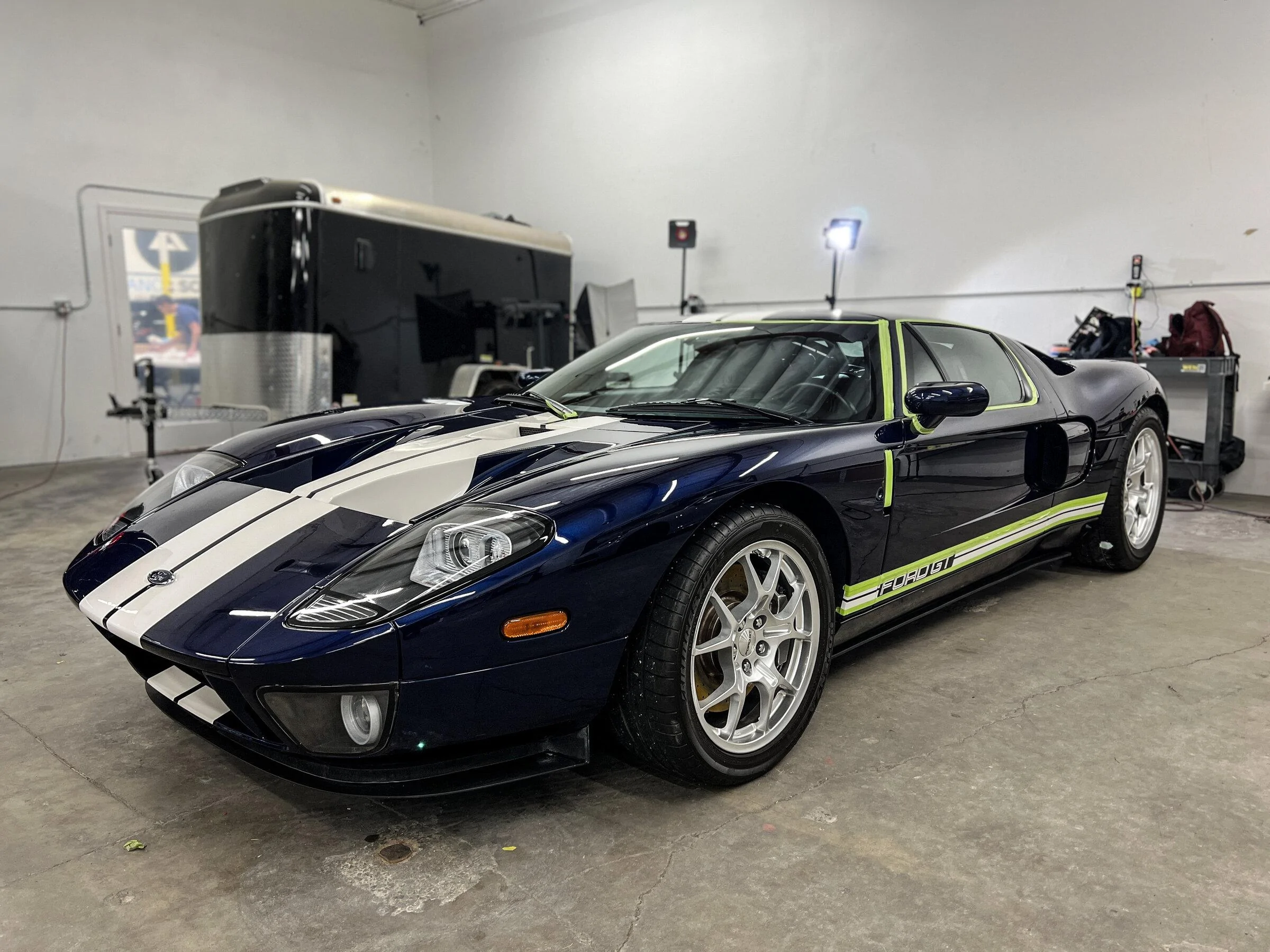

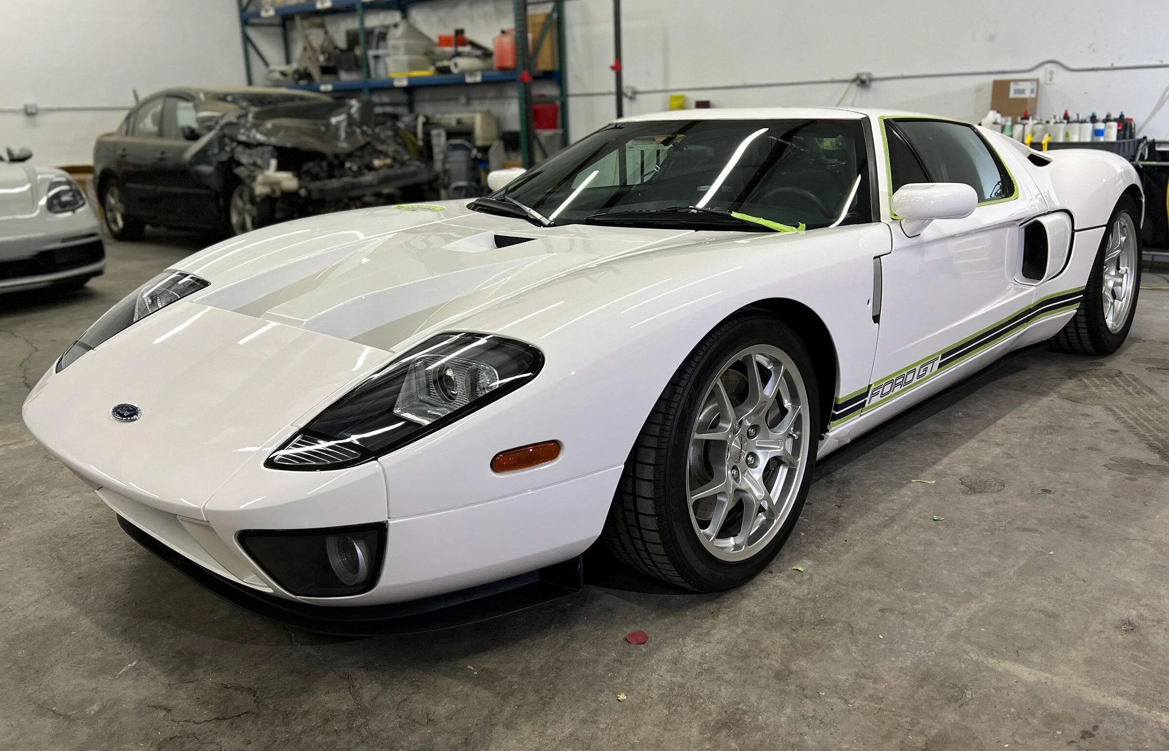

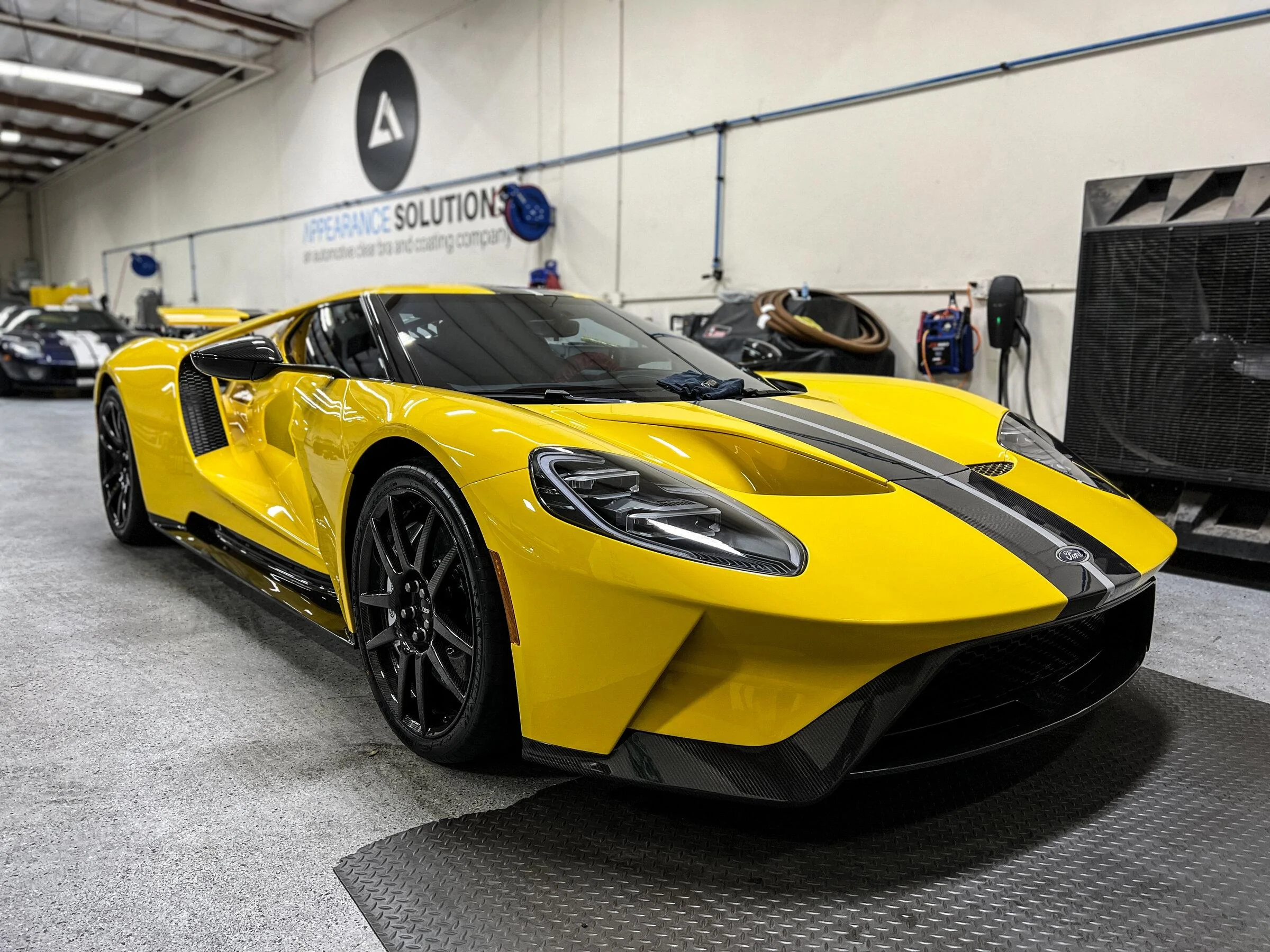

Nothing like professionally done paint - Old school paint buddy has been doing full off paint restorations on everything from E/types/928's,Shelby's, etc since the 80s. My favorite though is his still in possession 1970 Ford 500XL convertible pimp mobile. White top/interior with a deep burgundy red glazed exterior. I mean it's such a rich/deep tone buffed to perfection that I somehow was staring into it , for some reason I opened my mouth and could see how many fillings I have had done over the years -)
I do know I worry about the soft eco paint Ford is using on these Mavericks, not sure how to prepare myself for rock chips that for sure will happen pretty quickly it seems. 2004 Honda element with 225k looks new after wash/wax for instance.
Are those 245/65 with the Bronco sport wheels ? Looks legit-
Hahahah love to hear it. Older cars that actually have paint on them are the best. When you get a good paint code and get to polishing there’s not much more rewarding then seeing your reflection when you’re finished. I recently did a few Ford GT40s and the paint on those once you got the polisher to them was so rich and Insane it makes you wonder what they’re painting these cheaper Ford cars with these days.
Ford Maverick A Detailers Maverick Experience: Thin Paint, Ceramic Coating, Etc. B3233455-2BDB-45B2-83C2-5B324C1B7384
Ford Maverick A Detailers Maverick Experience: Thin Paint, Ceramic Coating, Etc. 6E282F66-2036-4815-A3D1-56E416FF9FB0
Ford Maverick A Detailers Maverick Experience: Thin Paint, Ceramic Coating, Etc. 3F61666C-9DBB-4C59-976B-3B5E6030886D
Thank you. They’re 245/65/r17 Falken WildPeak AT3W. Wheels are Fifteen52 Metrix MX.

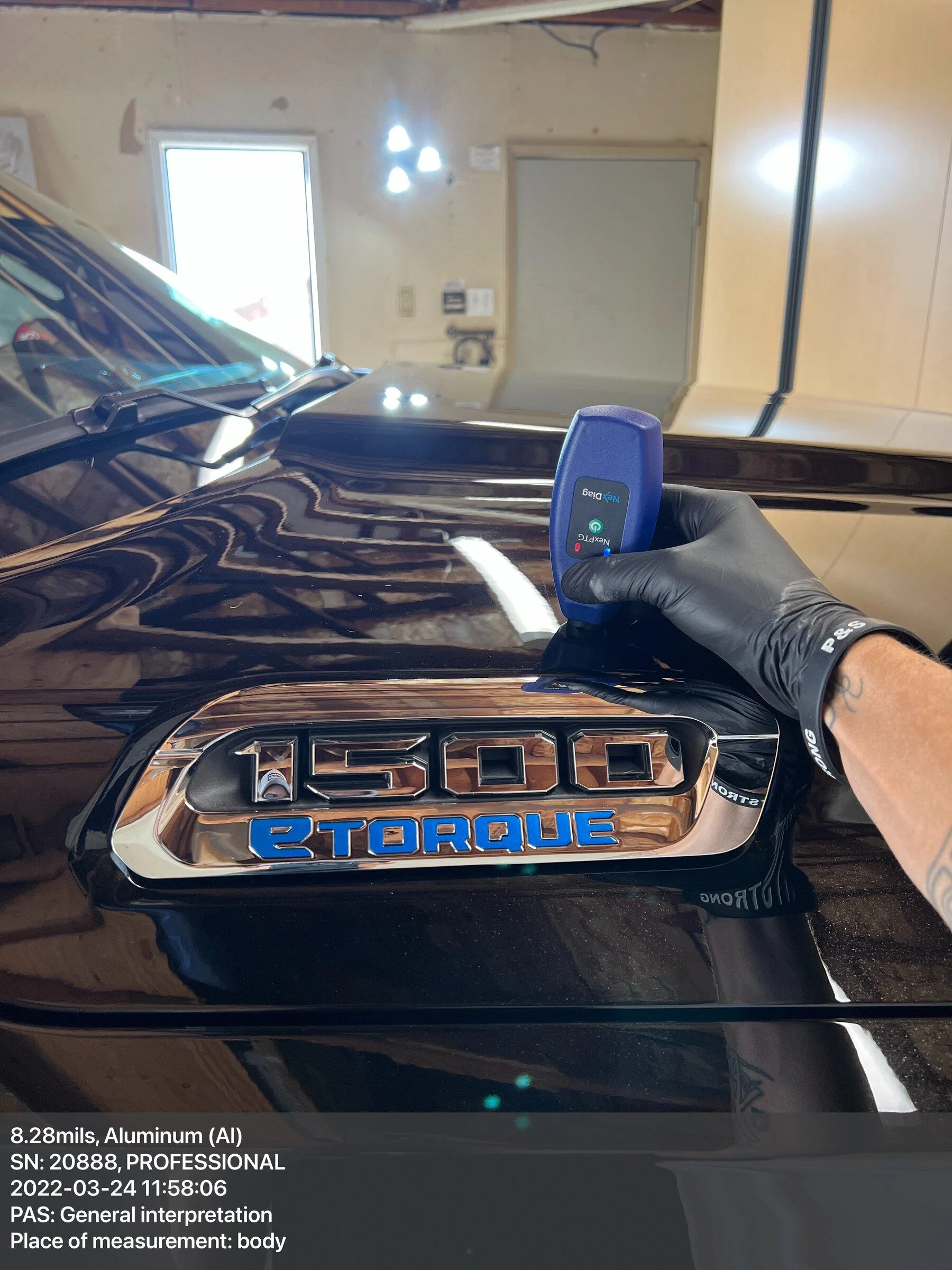

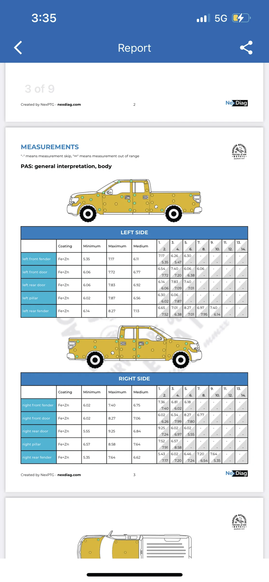

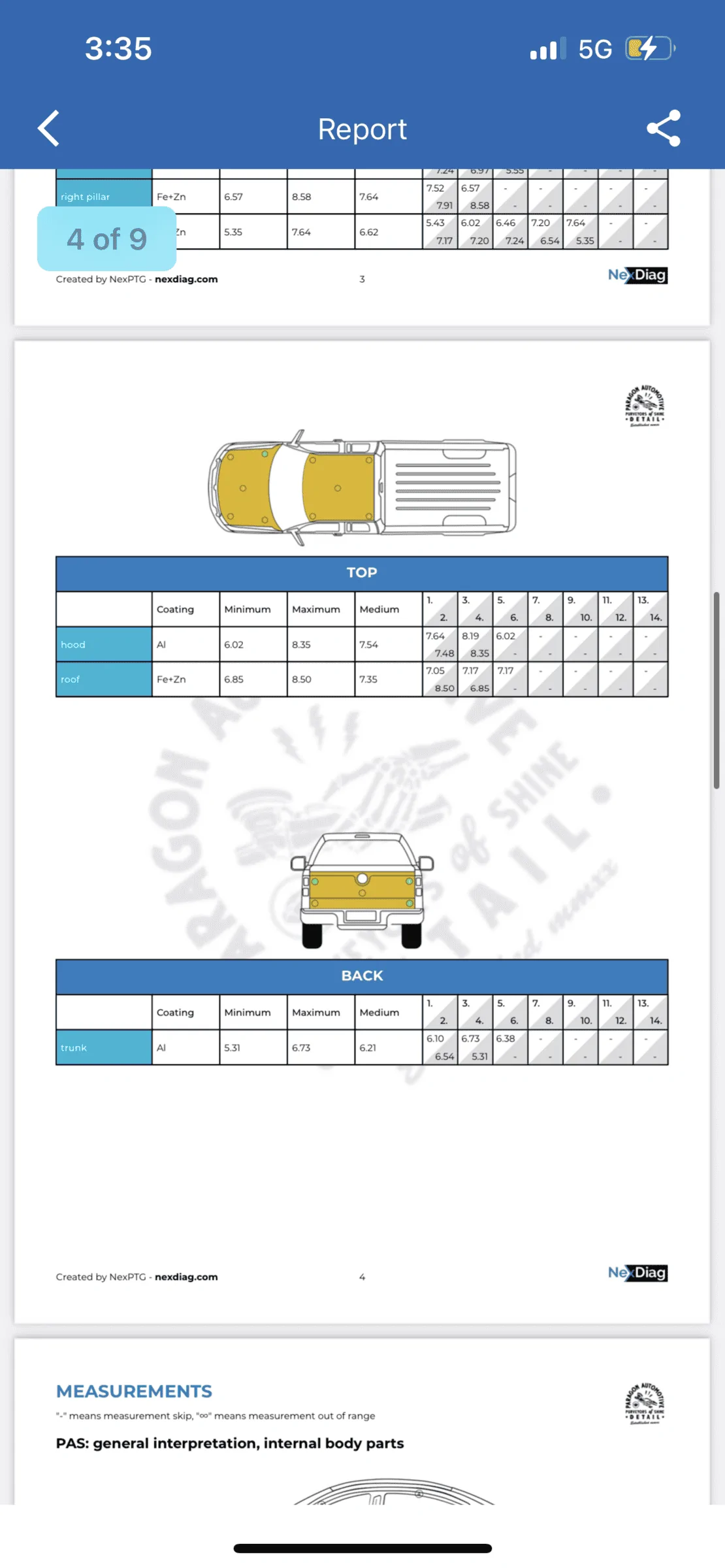

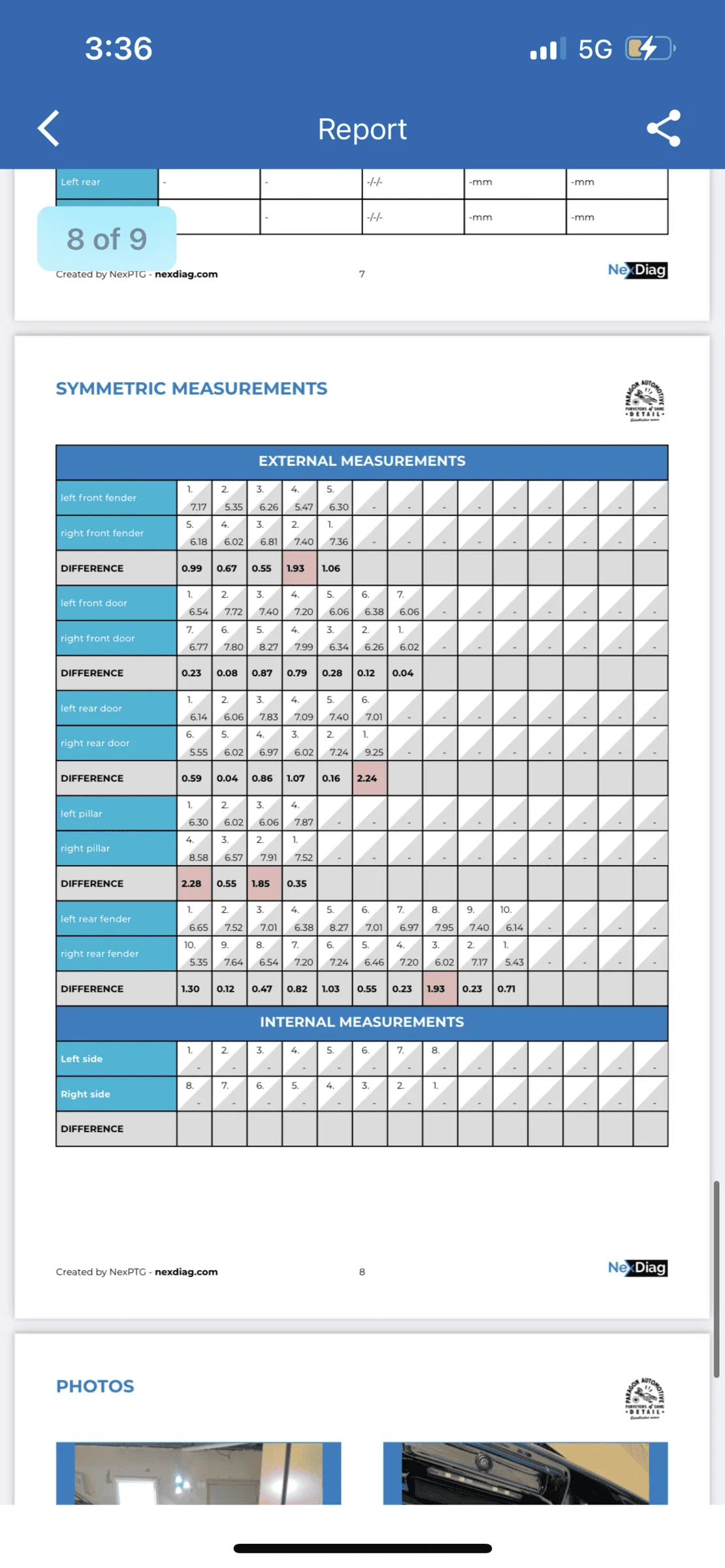

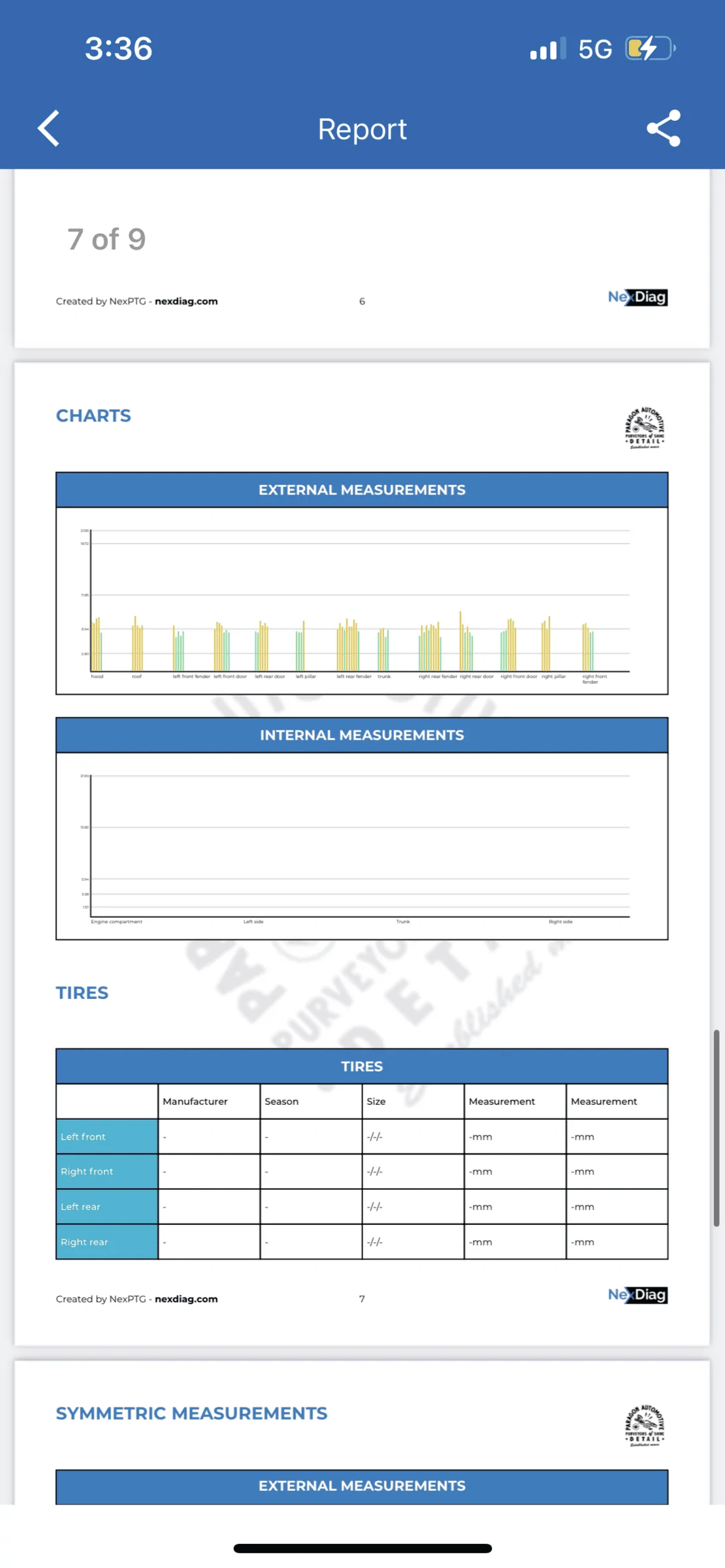

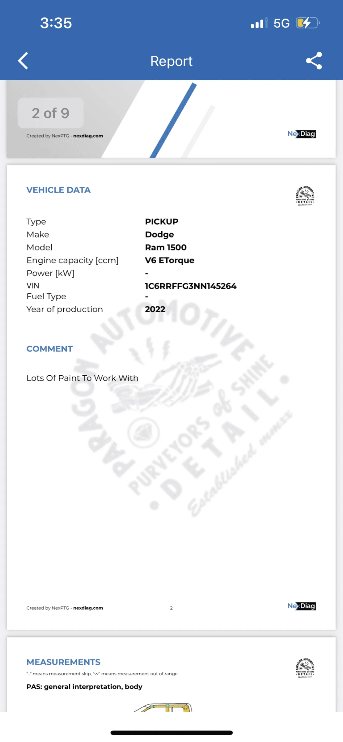

So your paint thickness measurements went from 2.28 to 4.24 mils. What part of the truck was lowest and what was highest? Or were these all done on one section like the hood? Thanks!
No they’re all done in a specific pattern. We take multiple readings of each panel to get accurate results. You can go from bottom of door to top of door and see a 1-2 Mil difference easily. Makes you wonder what in the world theyre doing in the paint booth. All four corners of each and every panel gets hit and a reading or two in the middle. Tailgate was a no-go, all readings were 2.2/2.3. Bottom of driver door was 2.5/2.6. Driver passenger was all just under 3 Mils. Roof and Hood had the 4 Mils and everything else was pretty much low 3s. I can post a report I did recently on a brand new Dodge Ram 1500 that had 3-4x the paint I have on my Maverick. It’ll make more sense.
