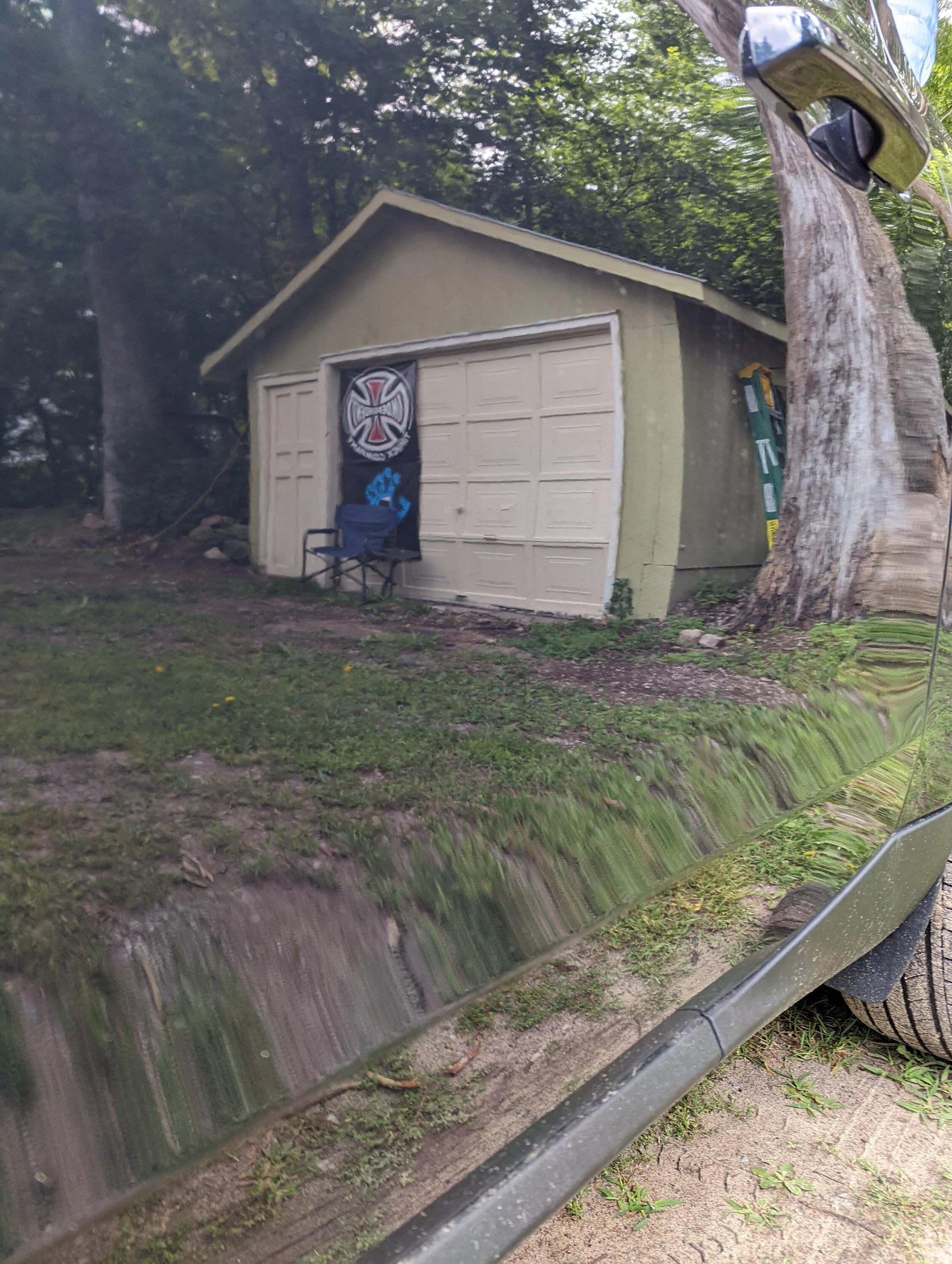

Ok I'm impressed. Did the whole process using liquid crystal and it really, really is worth the time and money.
Here is a pic after 400+km driving yesterday with lots of gravel roads, rain etc...
Not having the constant layer of dust on the bottom half of the car is gonna make me really happy.
Great job love to hear it!!
