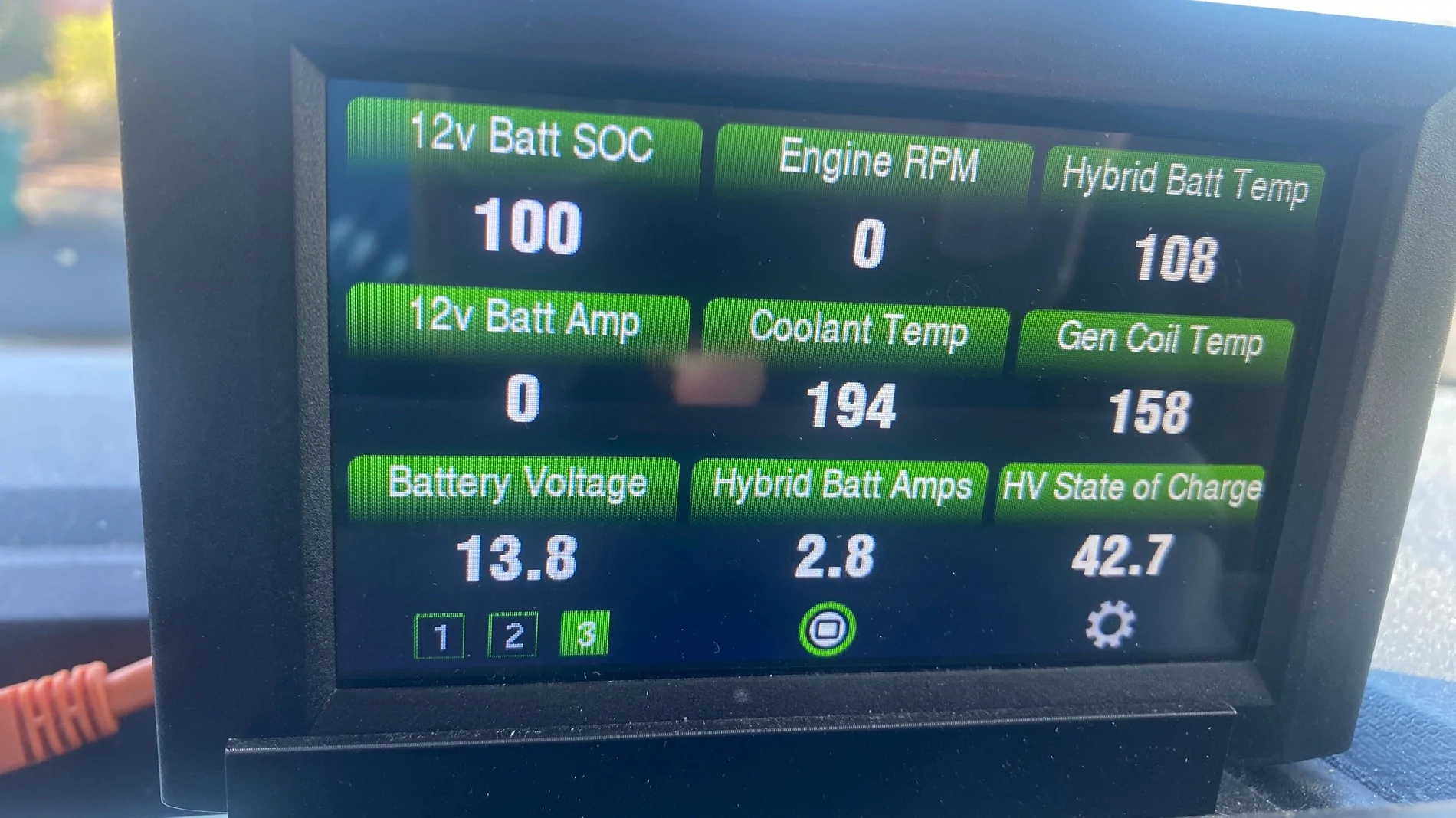

Fact: 2022 Hybrid (and others) actively drain a 12 volt battery to the computed 80% charge level.
Then do not try to add charge to the 12 volt battery until a computed 60% or lower charge is reached. God only knows why.
For 3.5 years my 12v battery has been "maintained" at about 60% charged. Always a resting voltage of 12.1 or 12.2.
Fact: running your headlamps will force the 12v battery to be 100% charged given enough time. (DRL will not do it. Parking Lamps only will do it.)
Fact: running your vents blower at speed 6 or 7 will force the 12v battery to be charged to 100% given enough time.
Fact: attaching a trailer, 4-pin or 7-pin will force charge the 12v battery to 100%.
Theory A: the truck needed to detect 12 volt demand, and above a certain wattage to trigger 12 volt charging.
Why would fan level 6 trigger battery recharging and fan level 5 would not? Why would full headlamps trigger battery recharging, but DRL would not?
Did the truck detect demand to run my camper fridge and coach battery?
I tested this last part. From Amazon I ordered a $10 LED brake light for the 2" hitch receiver with 4-pin connector.
Wow! The LED brake light pulling no power when not braking, and only 4 or 5 watts when braking DOES TRIGGER 12 volt battery recharging to 100%.
It's not the electrical demand that triggers recharging. It is simply thinking a trailer is there that triggers recharging.
Theory A shot down.
But this explains a lot.
This explains why some people have more 12v battery issues than others.
Those that drive at night a lot have more battery charging by happenstance.
Those that use fan speed 6 or 7 have more battery charging by happenstance.
Those who connect trailer wiring (and you don't even need a trailer!) have more battery charging.
Not a permanent fix. But a work around. Some of you may prefer running your headlamps more often over plugging into a home charger.
My 12v battery has been 100% for ten days in a row now. And is maintained at 12.7 or 12.8 volts. But I need to do one of the three "triggers" above or it rapidly starts to decline.
More to come...
UPDATE: running headlamps or one of the other tricks will recharge your 12v about 8% in an hour.
Recommend using lamps full time. But at a minimum, 2 hours per week.

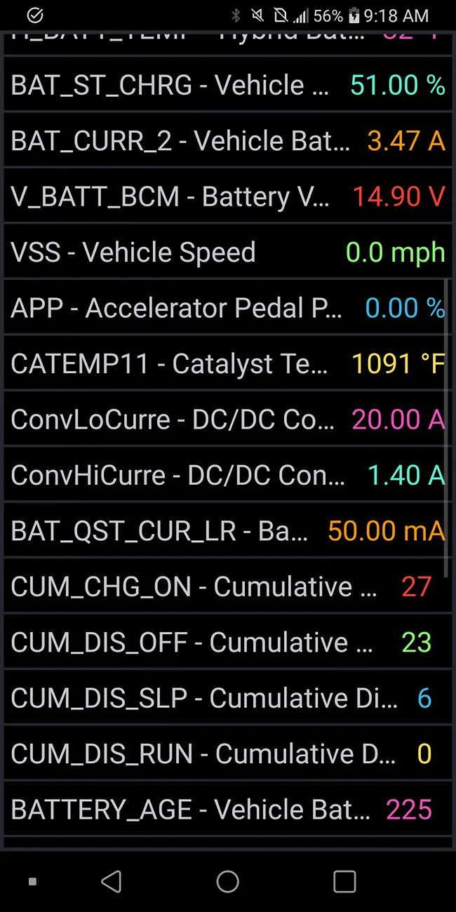

Ugh - I'd be happy if my SOC% and Volts were matched like that - 60% & 12.1V.
After 4 hr drive yesterday - got up to 65% SOC (float level started after 20 min about), from 52% IIRC.
This morning resting - 63% (ya it held!), and 11.9 V (boo it didn't). (bad battery at this point)
Thanks for observational skills with your different setups.
I haven't attached my trailer hitch yet, and don't think it came with wiring kit, but had for so long I don't recall. Time to get busy.
Or per the EB poster that found the rear AC outlet with night light was enough draw (he has inverter) to prevent AS/S from kicking on - perhaps I can find a high draw powerpoint light.
Does your scanner have these PID's available for cumulative charge/discharge?
Curious what level of matching you have?
This pic was day after a drain usage of doors open - BMS motivated to get it matching again - which it did - currently 32 Ah matching.
I've observed how close these are determines the BMS willingness for rate of charge too.
