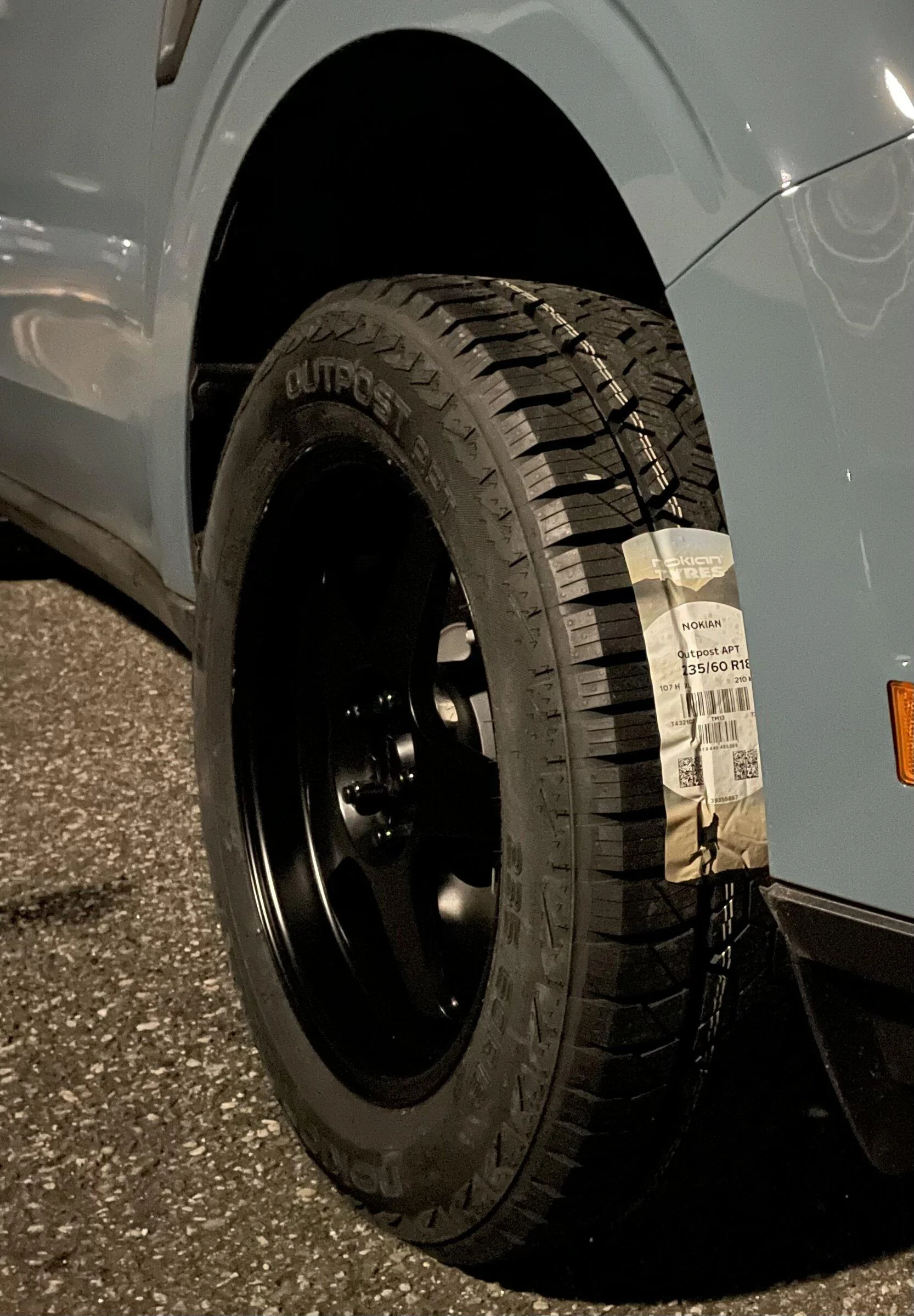

I’ll update with better pictures tomorrow:
235/60/18 Nokian Outpost ATP

I plan on buying these if and when truck arrives.
Nokian is quite common in Canada but these are newly released with no reviews yet.
Looking forward to more pictures.

I’ve ran a couple sets of WRGs and decided give them a shot since they were only $148 a tire (about $50 cheaper per tire than the WR G4 SUV).
Like the WRG4 they’re an all weather and low rolling resistance tire.
