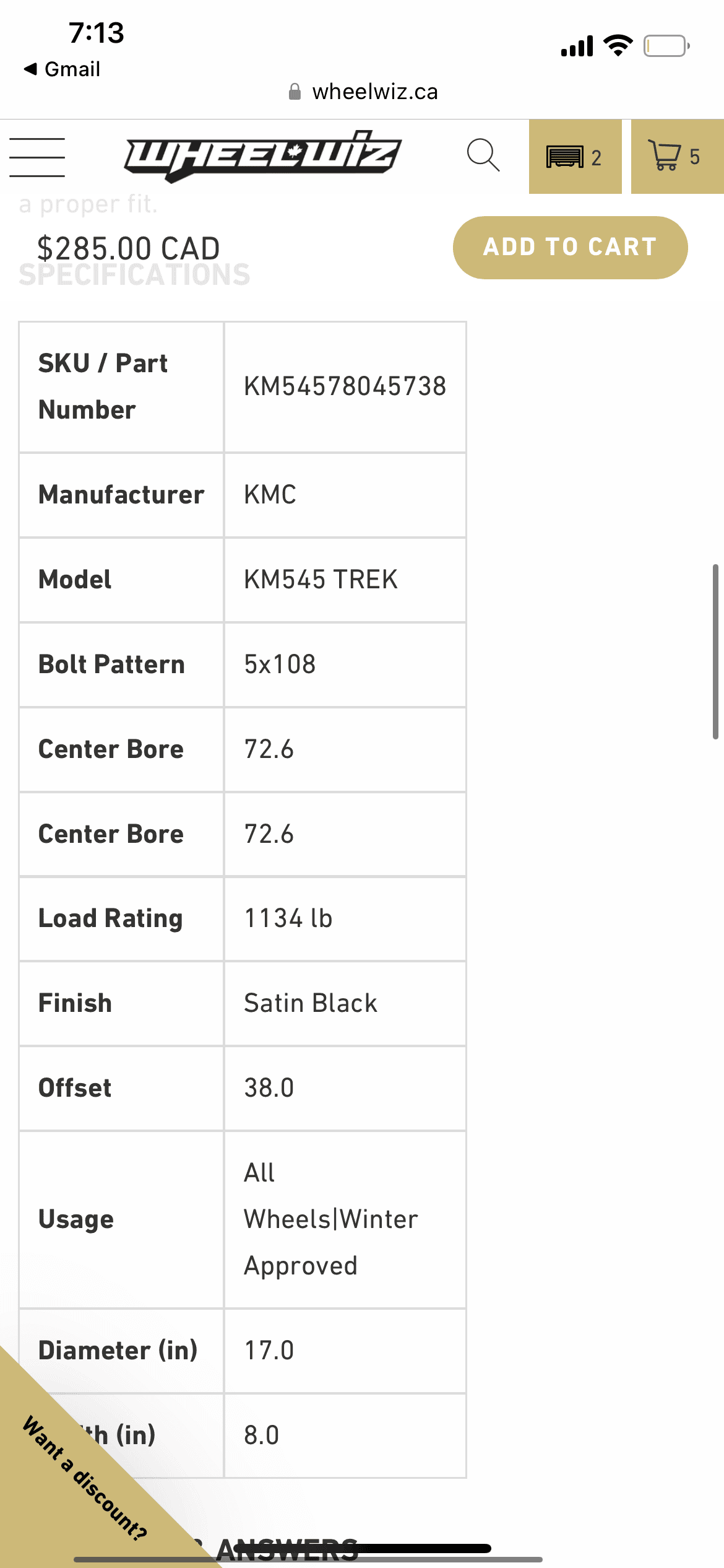

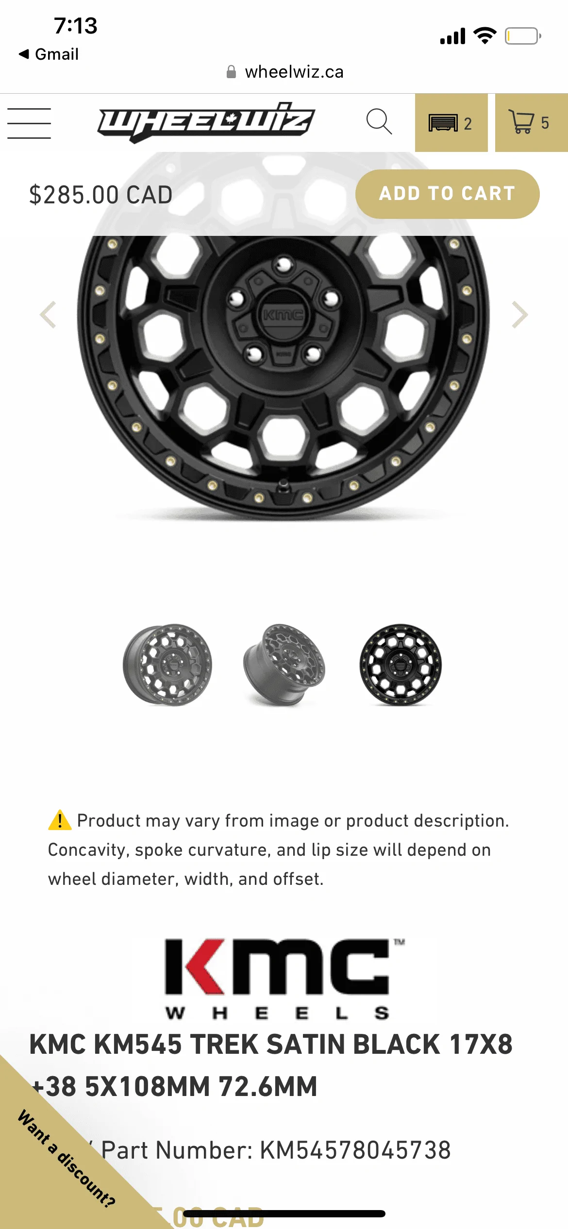

Hey guys I’m looking at getting these kmc rims I’m just not 100% sure if they fit. If anyone could help me figure out if they will fit or not that would be great

That’s a low load rating and you’ll need hub centric rings to use them correctly on a Maverick. That hub size (center bore) is larger than a Maverick...

Offset is almost identical to stock. Center Bore is larger, so you will need rings to make the bore smaller. But that's not big deal.
Size: 17x7" or 18x7"
Width: 7" width
Offset: +37.5 mm
Bolt Pattern: 5x108
Center Bore: 63.4
Thread Size: M14 x 1.5 lug nuts
Note: these are the same specs as the Bronco Sport wheels

Okay thanks for the feedback. So I would need to get rings with a 63.4 inner diameter or outer diameter?

The inner diameter needs to match the Maverick, the outer needs to match the wheels...

That load rating isn't mediocre it's below the load rating of your vehicle. As in unsafe, illegal, insurance is going to refuse coverage when you kill someone etc etc etc..
I mean it's pretty simple math isn't it?
3700 lb truck + 1500 lb of payload equals 5,200 lb divided by 4 = 1300 lb per wheel minimum rating...
Not to mention the gross combined weight rating is another 800 lb over that.....
Isn't this the sort of thing you want to be overrated for? I mean I know it's a shiny bauble and everything.
And that's all assuming a perfect 50/50 weight distribution which trucks aren't exactly known for right?

You are right thank you. I found a set of rims with a 2200 load rating that I’m going with

@Axelsup would a 1350 load rating be fine?

In any event, the centering rings are kind of unique to the wheel brand, so your best bet is to get the rings from the wheel manufacturer. You might find the correct O.D./I.D. someplace else, but they won't necessarily fit a specific wheel.
