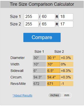

Looks awesome.
Mine will be coming with 18 inch rims. looks like a 255/60 R18 is almost identical, and the most I can fit without rubbing. thanks for doing the research and sharing what you found.
Ford Maverick Area 51 Maverick on Bronco Sport Wheels - 255/65r17 Falken WildPeak A/T3W 30s 3.PNG

You will be fine with those, I'm running 265/60 R18 and get very slight rubbing against the felt on full lock.
