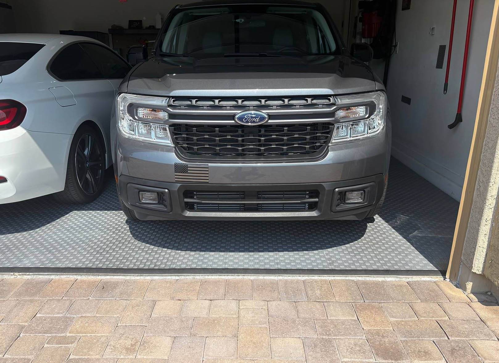

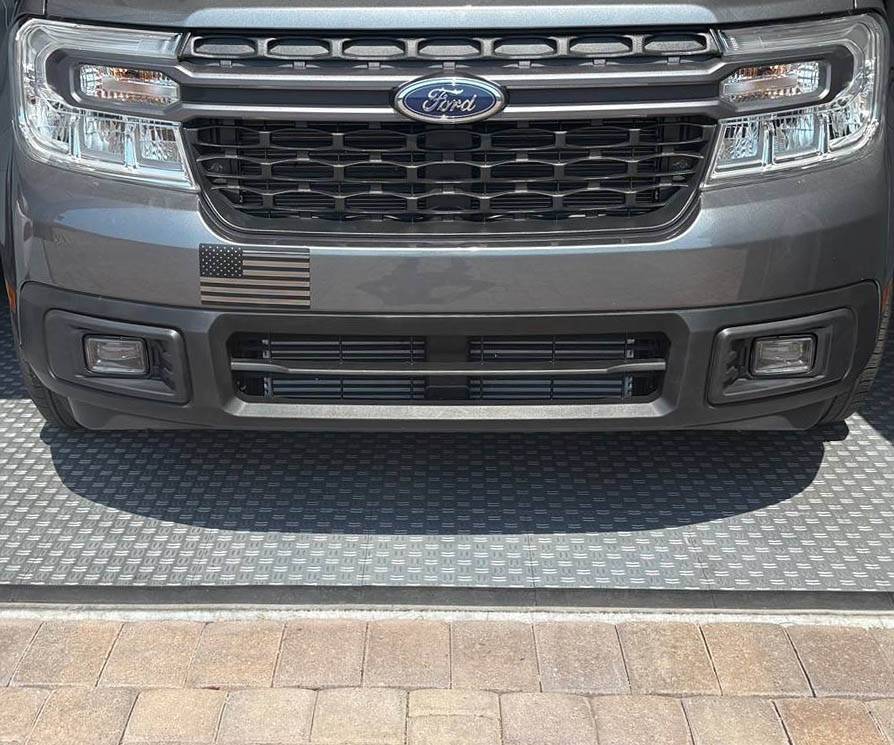

I installed @Diode Dynamics fog lights yesterday in 100 plus degrees in AZ. Yes I was that impatient. Install took about 4 hours total for this 67 year old geezer. Install was not complicated at all and the instructions were great.
Taking the bumper cover off and reinstalling it took up most of the time. The only thing different that I would suggest is don’t use a Dremmel to cut out the openings. It’s hard to get it at the right angle to cut. I used my oscillating tool. It cut clean, straight and easy. Don’t be afraid to try this project.
The quality is great and I think they really improved the look of my truck.

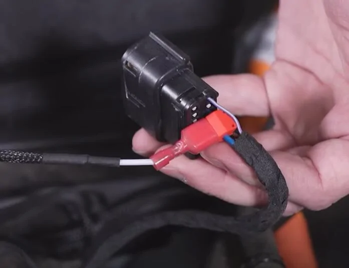

Mid-Independent? Want to run fog lights in this position and using the diode switch provided to turn on/off.
Ford Maverick Diode Dynamics Fog Lights Installation 1752503469447-s7

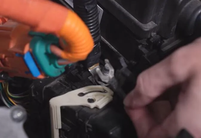

Blue wire/green stripe Pin3 passenger headlamp is where we all have it if we followed diode instructions. Video says its just an activation wire not a power supply since we are getting that directly from the battery.
Ford Maverick Diode Dynamics Fog Lights Installation 1752503765562-77
Ford Maverick Diode Dynamics Fog Lights Installation 1752504425382-cg
