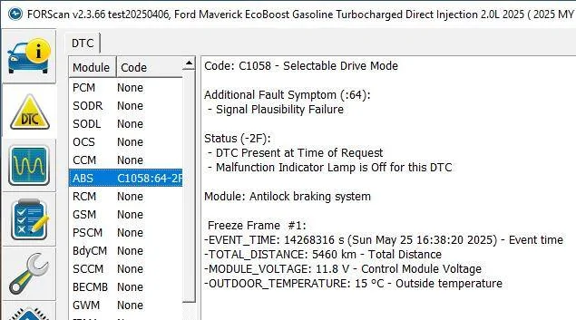

I tried this today. I did show Lobo mode. But I ended up DCT codes in ABS & IPC. And Check Service Engine light.
At first, I didn't do the 760-04-01 xxxx-xxxx-x0xxx change. At that point I didn't have Lobo mode as expected.
Then I did that change.
That is when Lobo showed up. When going to that mode that is when I got the DTCs.
Since sometimes DTCs show up when doing the writes (as things switch around on the Mav's computer), so I cleared them. I confirmed I did not have DTCs, then switched to Lobo mode. Then I would get a DTC.
I cleared the DTC again and let the truck sit for a while. Went back and proved no DTC. Went to Lobo mode and DRC came back. I decided I didn't want to run it, so I put things back.
What is odd, is I still got the IPC one. It said something about it didn't like the ABS data; sorry didn't grab a screen shot of that. Again, only when I switched drive modes. So maybe there is something else. I reloaded my original ABS and IPC values and still was getting the IPC DTC.
Here is the ABS DTC I was getting. I suspect this is because I don't have the proper rear dif.
Ford Maverick Enabling Lobo mode on 2025 Maverick Tremor Using FORScan lobo_dtc
yeah, I didn't really expect it to work. I think it's looking for something in the ptu and rdu that the Lobo and Tremor share, and other Mavericks lack.
When I went to Lobo mode, the screen changed properly, and Traction Control did get turned Off. So it that part correctly. But who knows what it does with the tranny and rear end. Once I saw the DTC, didn't want to risk it.
