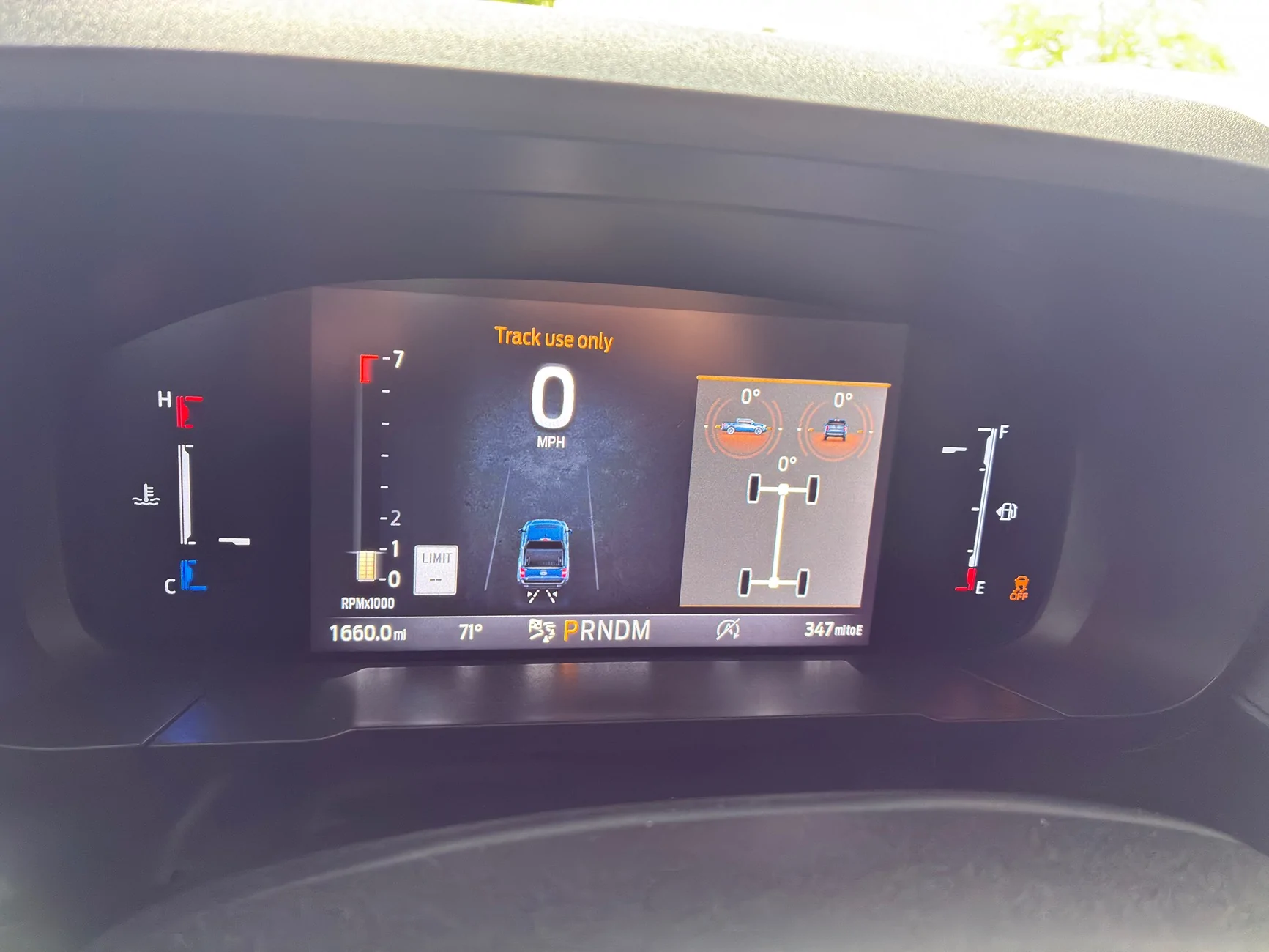

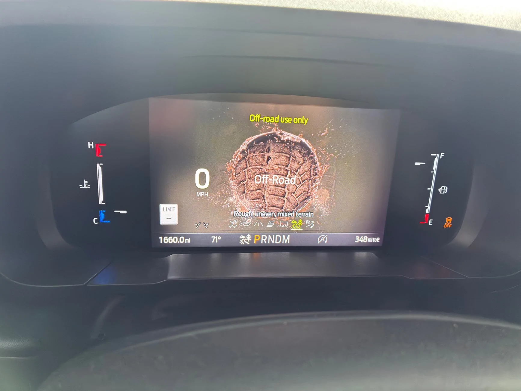

Thank you all, this is a very useful thread. I have a 25 Lobo 402a and was able to add the off road mode to take advantage of the torque vectoring diff at low speeds. The AWD status screen is also just really nice to have for spirited driving in Lobo or Sport mode.
Ford Maverick Enabling additional drive modes on 2025 XLT AWD Hybrid IMG_1050
Ford Maverick Enabling additional drive modes on 2025 XLT AWD Hybrid IMG_1049

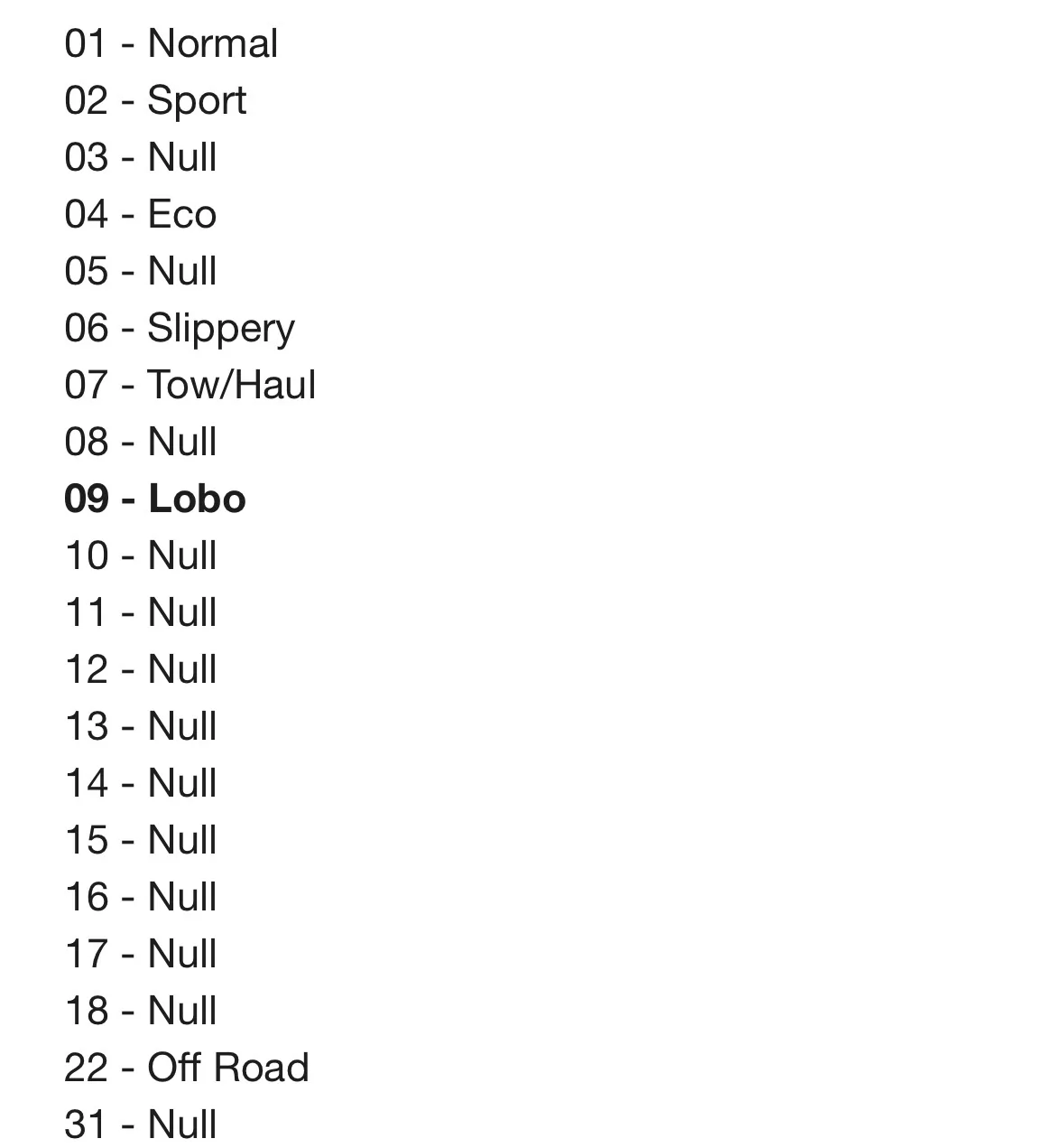

The as built IPC 720-07-02 x7xx-xx change made the AWD Status page available on the MyView menu.
I did not need to disable SDM-ABS; the only change I made was enabling 22
Ford Maverick Enabling additional drive modes on 2025 XLT AWD Hybrid IMG_1044
