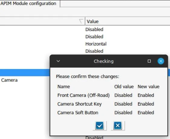

Bump and follow up. Did you get anywhere with this?
Also wondering about getting the front facing cam onto the display for low speed tight maneuvers.
I was looking through APIM and other modules. I found a few related to camera, to enable a soft button, shortcut key, and front camera (off road).
Ford Maverick Enabling 360/front camera on 2025 XLT trim 1752358872055-n7
I'm assuming shortcut key is for a hardware button on other models (i don't have it on my Lo-Bo)--maybe its on the HiBo or other models with 360 cams?
I assume the front camera (off road) is for use in the offroad mode specifically; i haven't tried to add the mode yet.
And while I enabled camera soft button, I did not see an obvious button added to my Sync4 display, yet.
