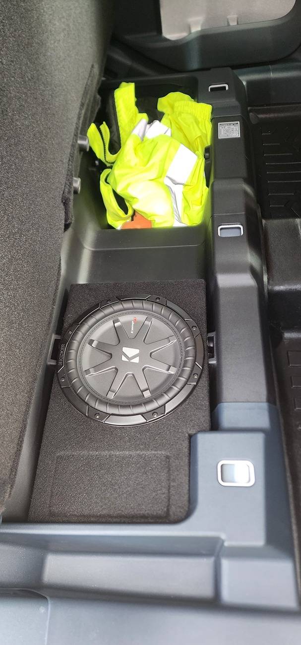

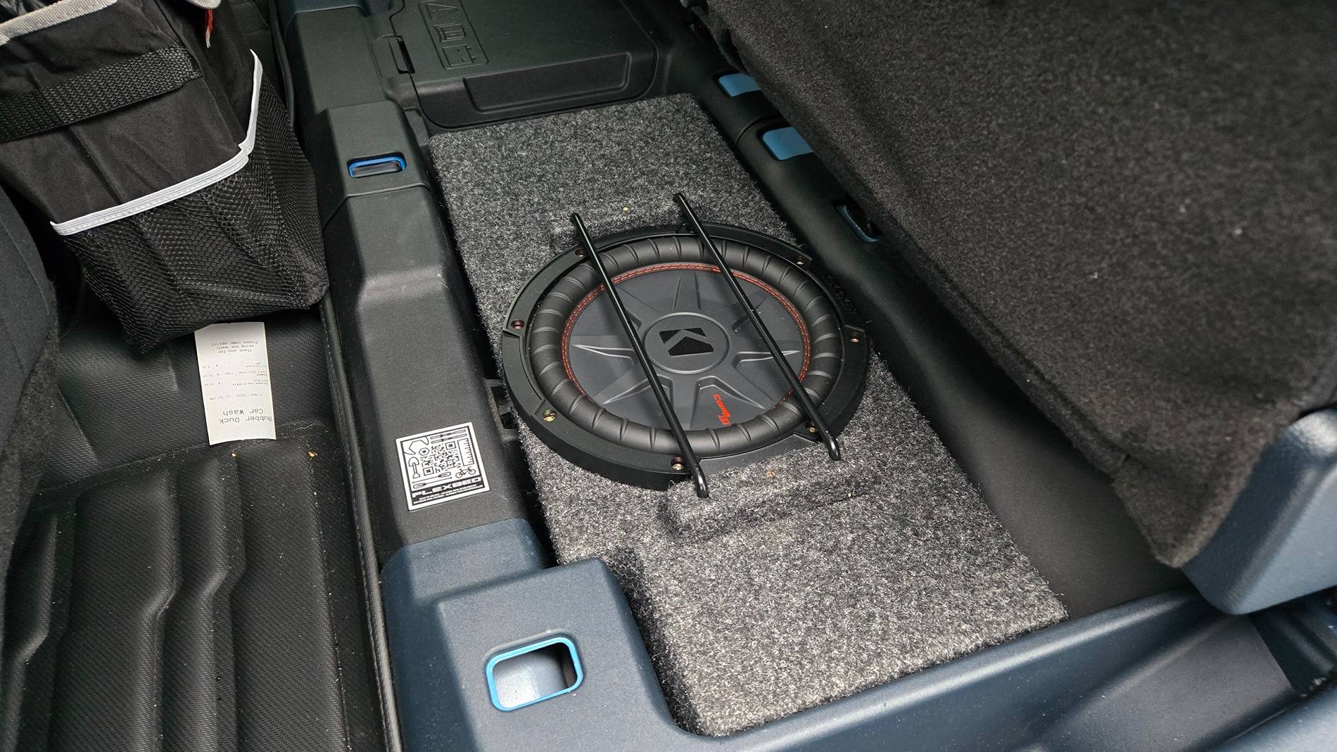

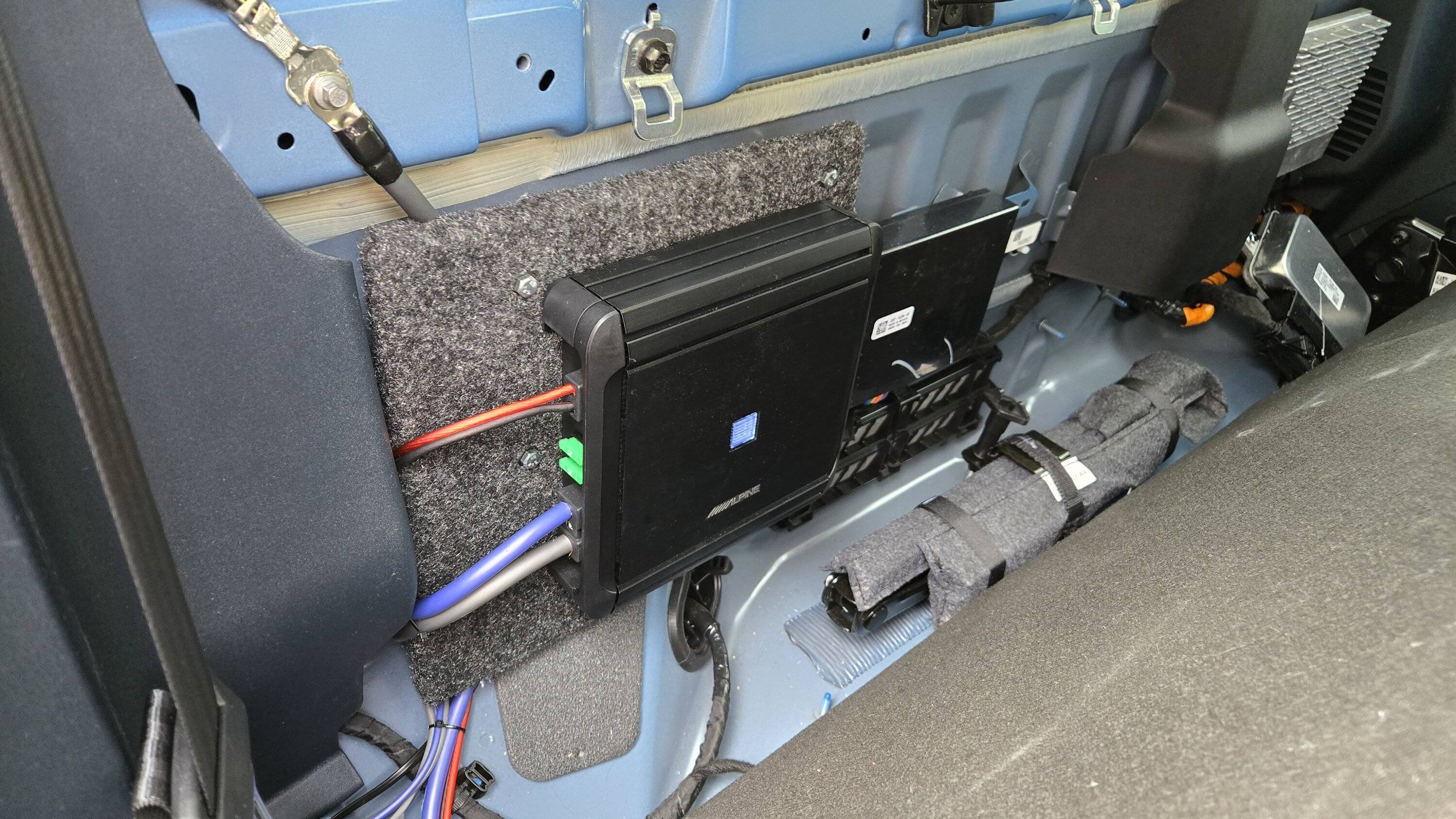

The stock system is really not great and after the first 2 weeks I just couldn't take it anymore so I did some shopping. Went with the popular choice of Kicker 46CSC674 in the doors and Kicker 46CSC44 in the rear pillars. That improved the sound quality immensely but I still needed to fill out the low end. For that I installed a Rockford Fosgate R2D4 10" (Upgraded from the RF for more lower end response and better power handling) Kicker CompRT 48CWRT104 sub hooked up to an Alpine MRV-M500. I custom built the enclosure to fit the under seat storage cubby which was an absolute PITA due to the dimensions but I think the final product turned out better than expected. The amp is overkill for the sub but I have the gain cranked down and also have a remote bass knob for further tweaking.
Overall, an amazing upgrade and a much more enjoyable listening experience.

Do you need to keep the seat in an upward position?

I keep the seat down. I made the custom grille you see in the photo to keep the underside of the seat from touching the sub.

I gotta get me some of that fabric tape. It really cleans things up.
Agreed about the Alpine amp. From all the research I've done it seems like a gem of an amp. I ran Alpine stuff in my cars 25 years ago and they've never let me down.

Good job. Curious if it sounds much different with the seat down?

Very nice installation. One question, how did you tap into the audio signal for the sub amp? Straight active signal from the rear speaker or did you use a LOC or LC2i to convert to RCA passive?
No real difference with the seat up vs down from my ears atleast. I suppose it wouldn't really make much difference since it's only low tones from the sub which travel well.
I tapped into the front speakers under the head unit behind the vents as I've read that the rear speakers have limited low end frequency from the factory head unit. Basically they cut the bass out for the rear due to the speakers being on 4".
