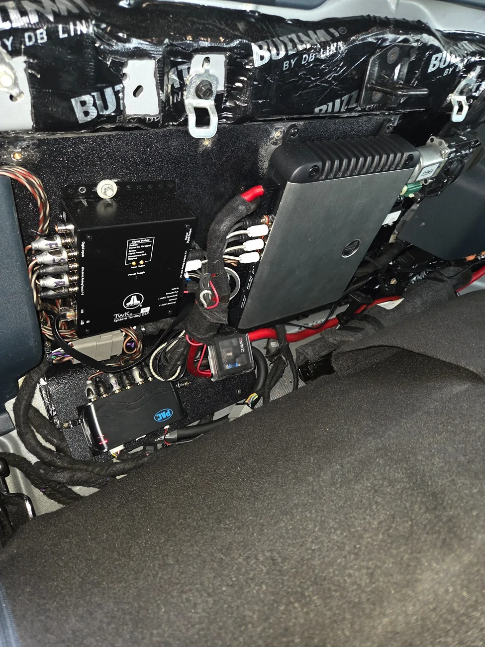

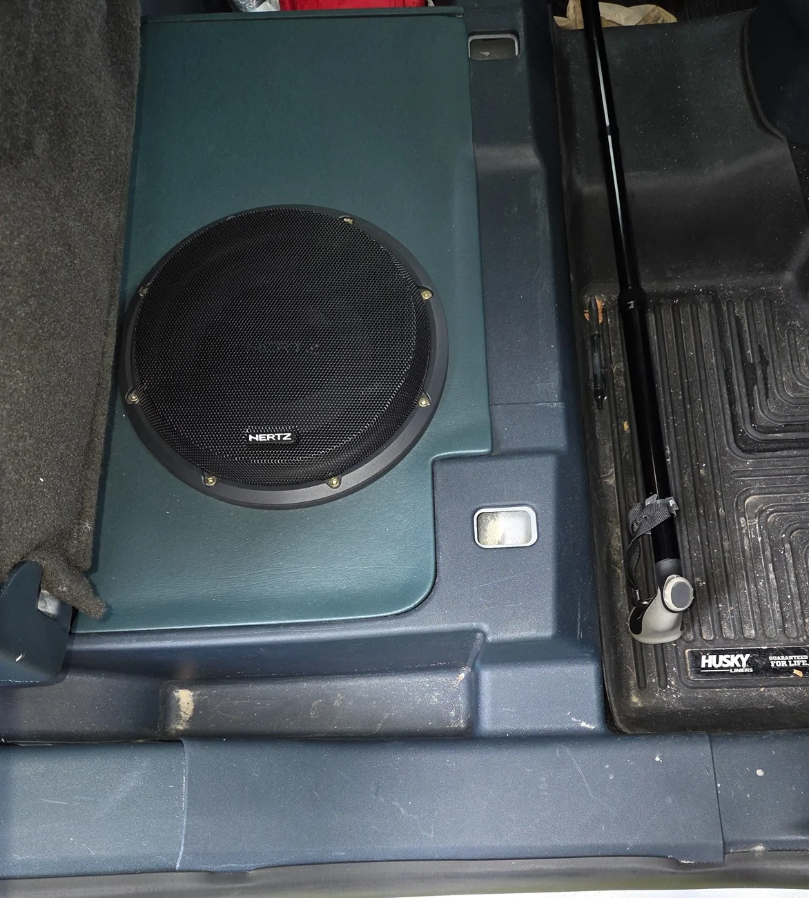

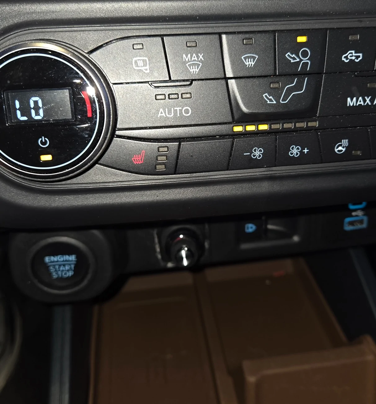

Just a few pics of my audio upgrade. I tried to be able to be content with the B&O system, but kept feeling dissatisfied with its performance. I had a JL Audio HD 900 amp with a twk DSP and a JL205 control knob installed. Added some JL Audio C6 components up front and some C2's in the rear pillars. And then had a custom box with a Hertz Mp 10" shallow mount sub installed under the passenger rear seat. All I can say is wow! What a difference. Definitely happy with the upgrade. Had the 205 control knob installed where the cigarette adapter is since I never used it anyways.

That's a great solution for the control knob placement. My self-powered sub has a level knob that I've never felt was needed - but if I was gonna install it, I would 100% steal your idea. :thumbsup:

In my opinion that hertz is one of the best subs available for our trucks.

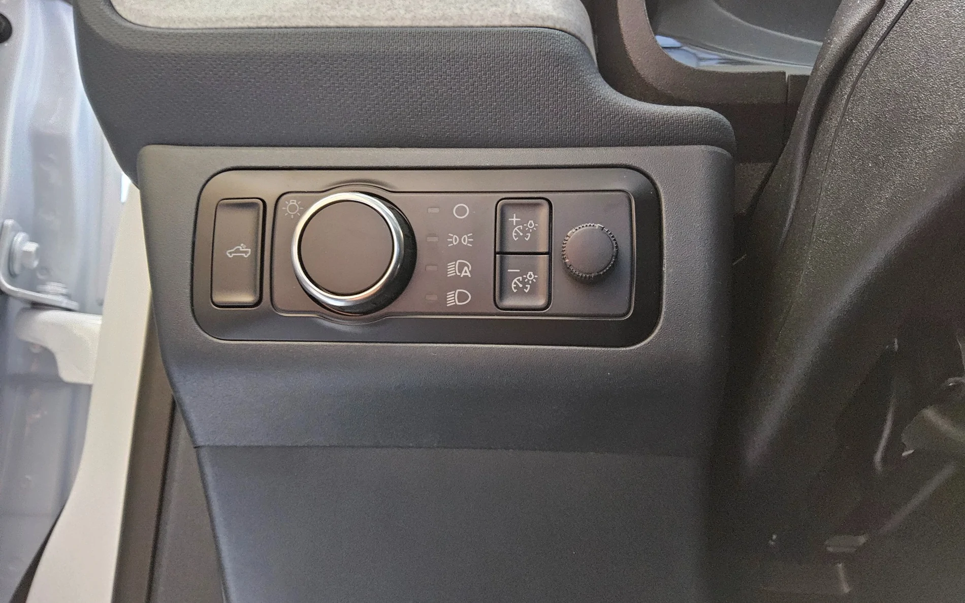

I put my bass knob by the headlight switch.

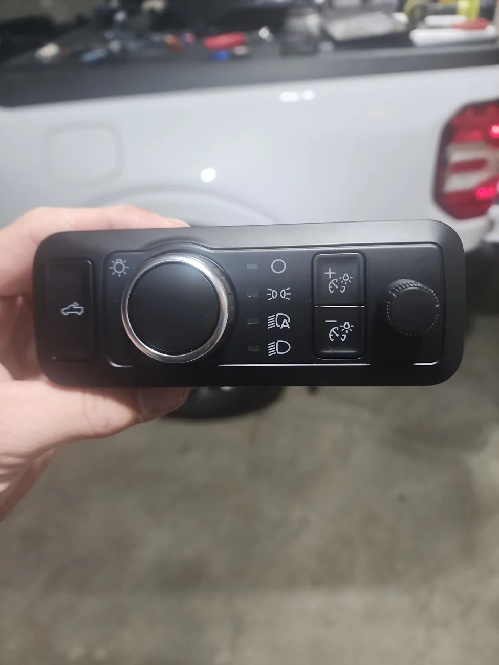

Yeah, I had to take the housing apart and cover it with heat shrink to get it to fit there.
I thought I had a better picture but I basically just installed the PCB board with the volume knob attached completely removed it from the metal housing with screw hole mounts.
