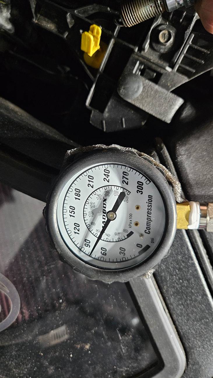

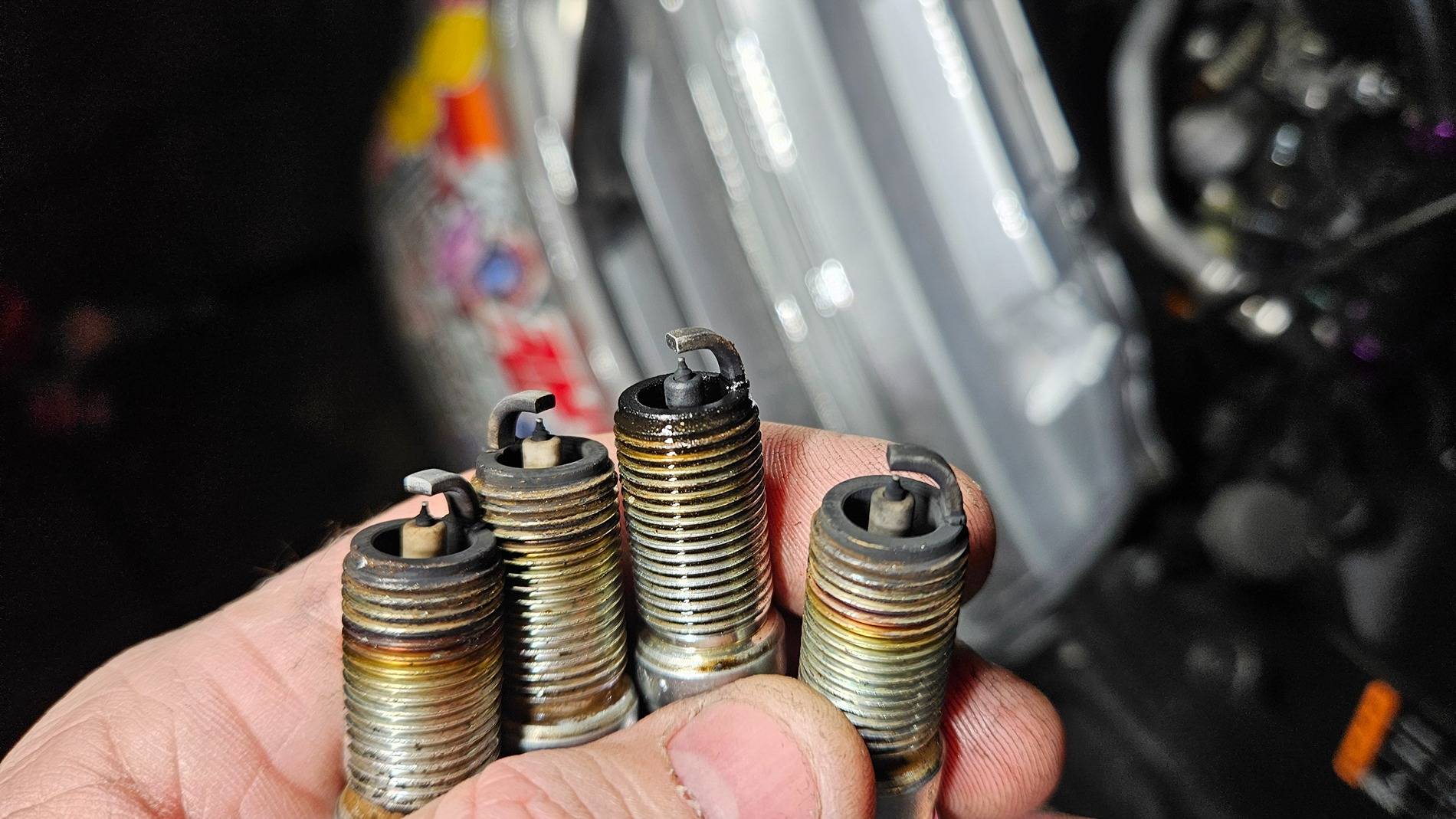

Well my 22' 2.0 started missing. #3 gave it up, piston rings is my call. Add a lil oil and it will go up to 105 but still way low. No valve issues. The wife asked "how would that happen?" I said too much sauce and sending it hard! Best wife ever said "well u wanted a bigger engine, right?" Time for a 2.3 swap boys

105k on OE, modded at 60k; cvf downpipe, 3 in exhaust, no muff, cvf intercooler, livernois 93 tune, sb intake, both side catch cans, underdrive wp pulley, optimal yellow top, booma spacers(for methanol, not yet added) lowered.
2.3 will be swapped in bone stock to drive while goin thru the 2.0
I will use with the 2.3 head and turbo with a built bottom 2.3 rotating assembly
