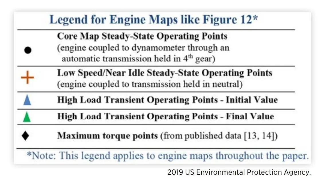

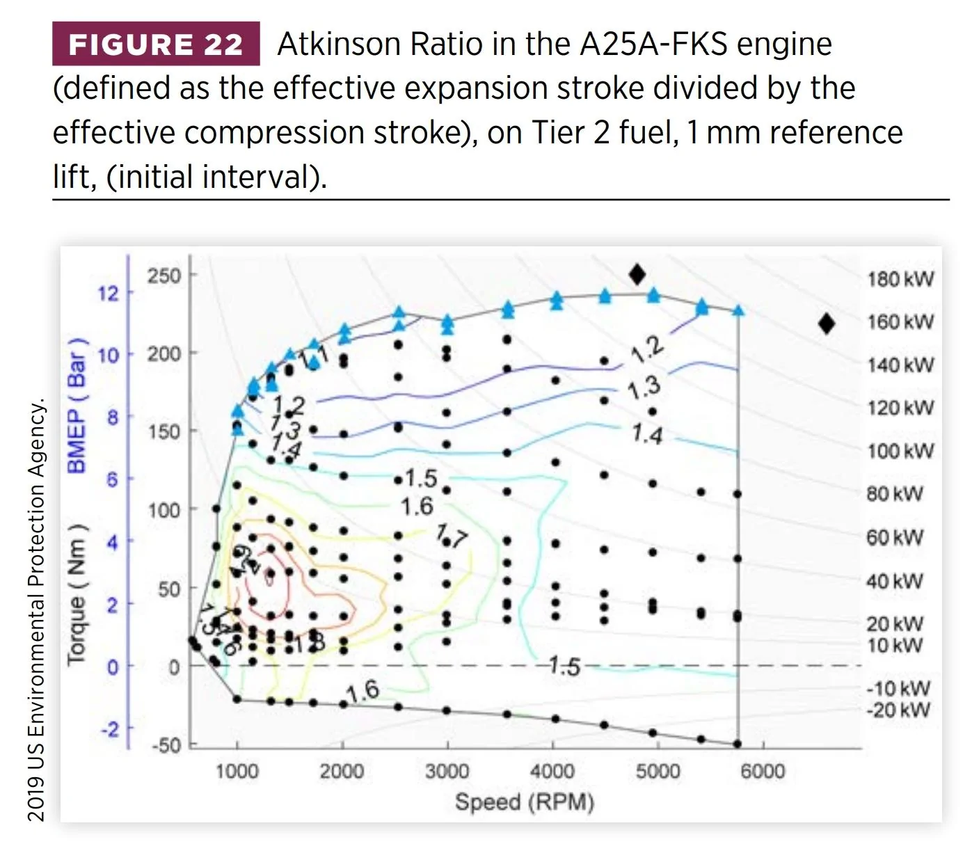

This chart is from an SAE report (available if interested). It shows torque vs. RPM for a range of Atkinson-cycle operating points. Only the top curve, maximum torque, uses a 10% volume difference typically ascribed to Atkinson engines. Lesser torque output requires less cylinder fill, allowing up to 2x the expansion in the bull's eye, and pushing efficiency close to 40%. This is the state of the art.
Ford Maverick Atkinson Cycle Engine Atkinson Map for Toyota 25L
Ford Maverick Atkinson Cycle Engine Atkinson Map Key for Toyota 25L
And yes, the "negative torque" region of the chart is real; it's being slowed by the charging motor. In the C-Max (introduced in 2013), Ford called it "negative split" mode. Only available under low load with a very full HVB.
